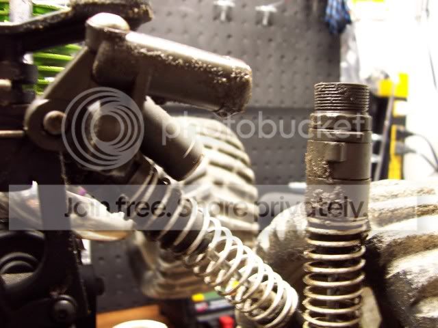

Here's the list of damage from last Sat. nights bash session. Not a whole lot of damage and everything is easily fixable. First pic is of the right rear, rear mounted cen shock. Looks like the shock body just unscrewed itself from the cap. The threads in the cap and on the body are all still good along with the o-rings. Gonna clean it up and refill it and see if it's still good.

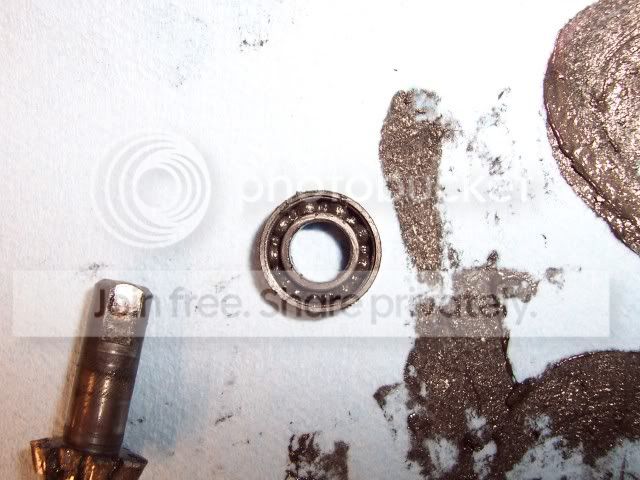

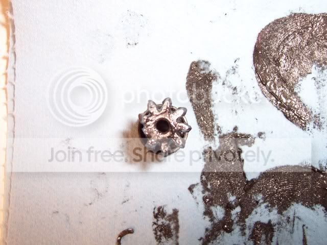

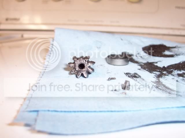

I noticed a few weekends prior to this past Sat. that there was a clicking noise coming from the truck when taking off and while driving. Thinking it was just a worn out drive cup or axle, I overlooked it for the time being and kept on runnin. Come to find out, it was the rear cen diff pinion with a few missing teeth. I figured out that's what is was last Sat. but kept on runnin anyways, I was havin to much fun. Also, the outer bearing that the pinion slids through is shot. The rubber shield got worn off and the bearing needs replaced. I've got extras. The mess was a little to loose cuz the pinion wasn't shimmed enough and that's what caused the broken teeth. Another cen pinion bites the dust.

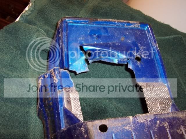

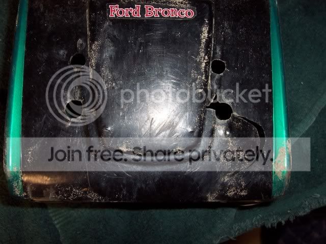

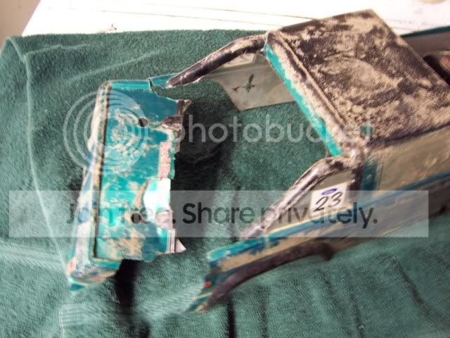

And for last, the two body's that didn't make it through a 3hr. bash session. The green Ford Bronco body is a really old body and already a little tore. I've been trying to finish it off for the past month and I finially did Sat. night.

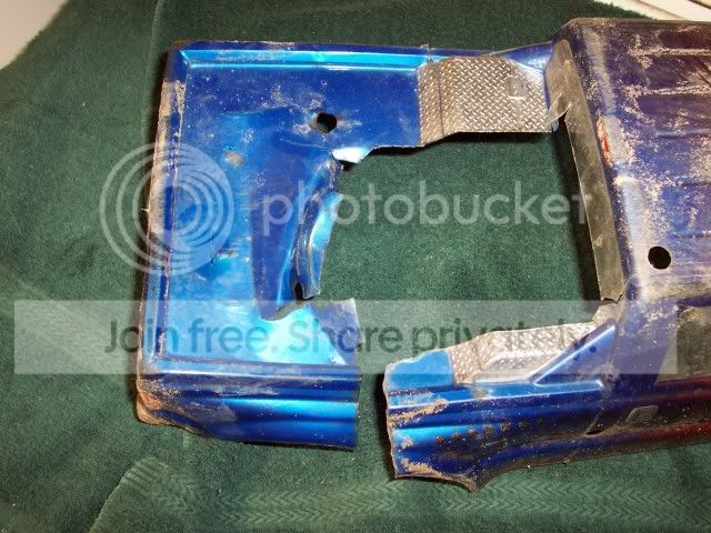

Here's the other body that got tore up that night. It only lasted 1 1/4 tanks and is the one on the truck in the last vid I posted the other day from Sat. night.

I posted somewhere as to reason why I kept bending and snapping dogbones. The alum. diff housings I was using wouldn't let me properly shim the diffs side-side. Which caused them to have to much play resulting in busted dogbones. I've been runnin the RPM arms for the last 3 yrs. almost and have never had any problems with them flexing to much. All the shocks that I've bent have been from bad upside-down landings or runnin into something solid full speed and hittin the wheel. Since I've been runnin the Cen shocks for the past year, I've never bent a shaft or busted a body up until a couple weekends ago. I do keep my truck clean, it's just that all the pics are taken the next day or 2 before it gets cleaned. The dirty pics with damage just go to show how much fun I had with the truck for that bash session. I don't do full teardowns and rebuilds alot because I really don't have a whole lot of time to work on my truck nor enough workspace for it. I also won't take offense to your opinions and/or suggestions.
Ahhh the CEN shocks are they better then the flux style big bore shocks?
Not sure, I've never ran the HPI big bores, the alum. ones or the flux ones. I know the cens are pretty tough. I've never bent a shaft or anything. On two of the shocks, the caps came loose (I probably didn't get them tight enough, my own fault) and one of the shocks got busted on the body where the shaft comes out do to the lower mounting screw backing out. Other that that, they've held up to my abuse so far. And my buddy who owns a GST 7.7, has never messed up a shock, even after smaking a lightpole at full speed.
