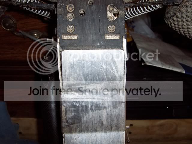

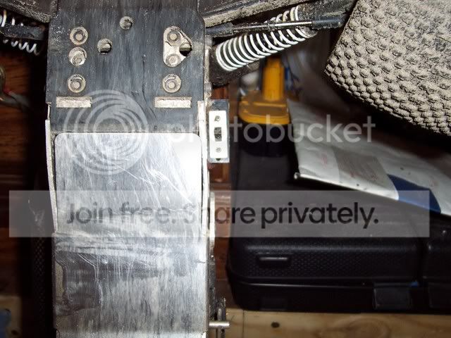

HOLY CAMOLIES!!! i forgot you had the diamond plate tvp's that really sucks man. i can prolly get my hands on a sheet if you wanna re-do them.
Yup. I can get some down here, I just don't want the extra down time of making them again. Plus, I gave my ext. TVPs I had to Jeremy and those are what I used a base temp. I'm gonna make some more in future, but with a different material. Only time will tell. I also forgot to tell you that I got a diff/bulkhead plate from Bank already. I totally forgot you said you have one I could get. Thanks anyways for the offer. If you ever need anything let me know.

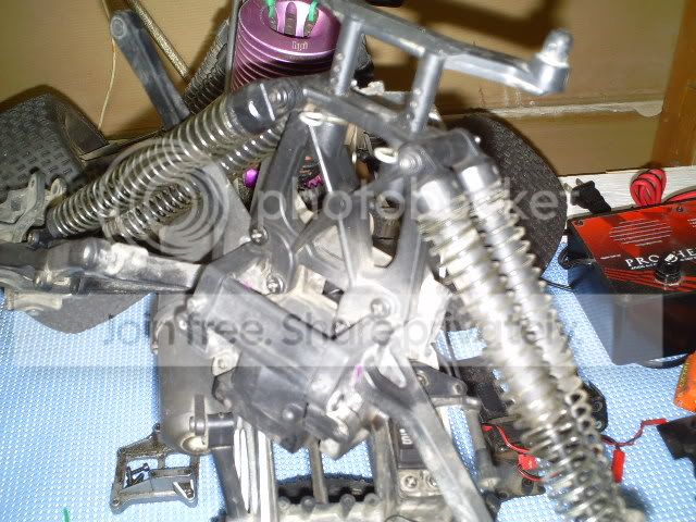

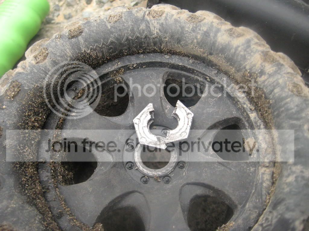

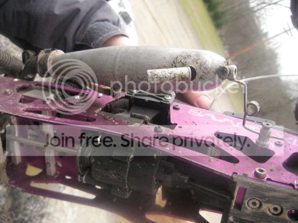

Did some more damage to the truck Sat. night. Only got a 1/2 tank in which really sucked. First, I noticed that when I took off from a stand still, the truck pulled hard one way, same as it would if a dogbone was broke or missing. So I walked over to the truck, picked it up, gave it a little throttle, and and all 4 wheels turned like normal. I put it back down, grab full throttle, and it did the same again. So now I'm thinkin the diff is shot on the inside somewhere. I started to slowly drive the truck (which was hard to do) back over to the car and shut it down and pack everything back up. But not wanting to end the nite early, I decided to make a couple more high speed runs and then shut it down. On the slow drive back to the parking lot I gave the truck on quick little full throttle blip. The truck took off for a sec., then the motor went back to idle and I was still giving it full throttle. So i figured the Rx batt was almost dead and the fail-safe kicked in. Nope, pulled the throttle linkage right out of the ball-end cup on the carb slide. Now I have to redo the throttle/brake linkage again. While cleaning the truck off yest. I decided to look more into the front drivetrain problem. And upon further inspection, it was a busted cross pin in the front right CVD. Oh well, that's all fixed, now I just have to do the linkage once I get some more parts from the LHS. Here's the damaged CVD pic.

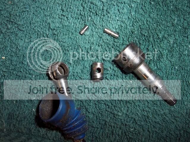

When I went to replace/fix the front center dogbone, I also noticed that I snapped the pin off the set screw that holds the drive cup on the trans output shaft. Got the truck all fixed up again and ran it a bit today at work. And it happened again, snapped the pin off the set screw. Now I need more set screws and I'm also gonna look and see if I can use a bolt and double nut instead of the pinned set screw. It looks like I have enough room. Gonna look into it further. The screws I had weren't long enough when I thought about it the first time I fixed it. Gonna see what I can get.

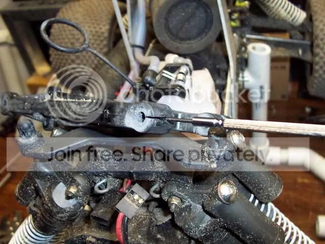

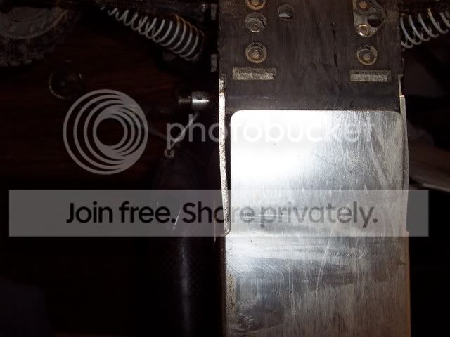

This past Sat. night, my buddy and I met up with some of the guys from Hobbytown for a little nite time bash session. Of course, I had to bring the ramp with me to give it some test runs. I'll post about that on the ramp build thread later. Anyways, on to the damage report. The guys from hobbytown left early so it was just my buddy and I left still runnin our trucks. I was doin most of the filming while everybody was runnin there trucks and stuff and then I ran mine later. The jump that caused the damage was caught on vid and will be posted once I get it uploaded. Suprizingly, the only damage was a busted lower a-arm and the TVPs got bent ever so slightly. I'm still gonna run the truck with the TVPs and see how it works out and leave them on until they are messed up more or when I feel like replacing them. My buddy has an extra set I'm gonna get off of him. Well, here are the pics and the vid will be posted later. Enjoy
Front right lower A-arm, split along the mold line.
center shot of TVPs, not that badly bent.
left side TVP from lookin under the truck
right side TVP from lookin under the truck
This is to go along with the previous post of damages. I also bent one of the front lower hinge pins. The opposite one of the arm that broke. Go figure.

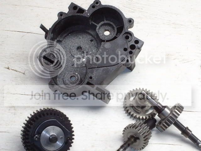

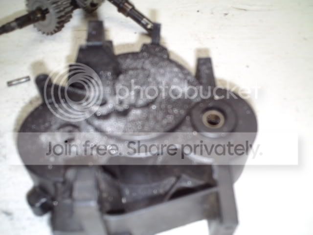

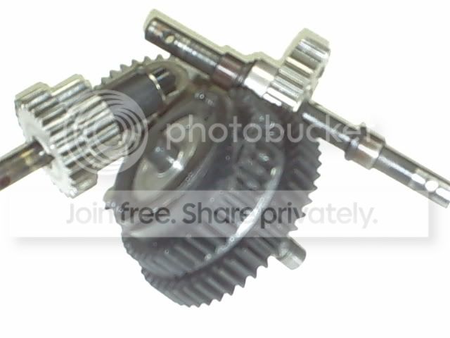

Here's why I opted for building my own transmission gears. I was sick of tearing the transmission out after only a few tanks of fuel. Finally start making good power and you start to find all the weak points. Here's a few pics of those weak links!!
Great work. What are you running that keeps tearing up the trans so fast??
Can we get pictures of your custom Trans Gears, I love seeing custom work and everyone's genius ideas?
Steel or the aluminum ones? I made 2 sets of aluminum ones . One set for a 2spd and a set for a 3spd. Working on the steel sets soon and searching my shop computer for the aluminum pics. Hoping to find them today!!

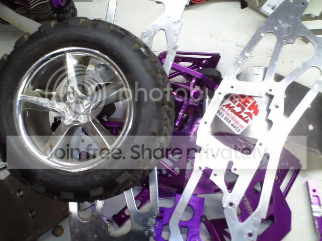

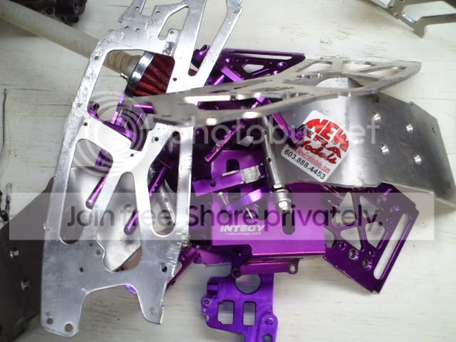

Well I'm really hoping that price of scrap goes back up a bit. All this busted and bent purple Integy crap needs a new home. Even destroyed a couple sets of New Era skid/wheelies bars!! Got junk?
