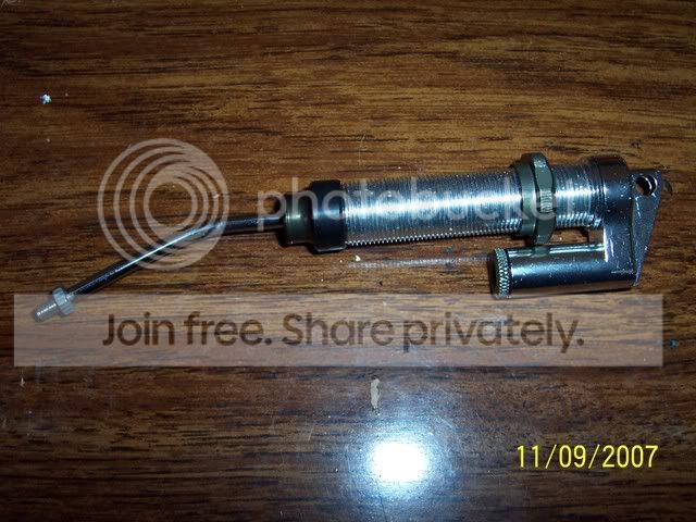

Here's some damaged from when I was runnin my truck yest. trying to get it tuned better for next Sat. Don't know how it happened, but it did. I wasn't even in dirt, mud, or sand, just runnin it in the street.
And this is from the last time about a month ago. Hitting a drain curb on two wheels (left side wheels that is) wasn't to good for the truck. And I wasn't to happy either.
And yes, those are Integy MSR8's. Only the front one bent. And I'll post another photo later of more damage.
That sucks.........luckily I haven't had to buy new shocks or even rebuild them yet.......keyword in that sentence was YET.

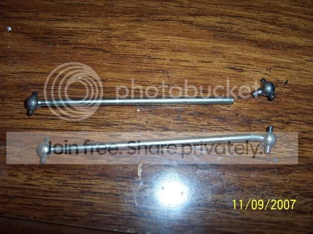

Before we left for the Diggers Dungeon for the halloween event I was going through the truck and my front driveshafts looked just like the bottom ones.........
never knew it until I took them out since my front diff was bad......
As far as I know both of them can help you out on that.........
if they cant get you a rebuild kit then that kit that you posted looks good.
I know that's why I want that rebuild kit. It comes with all the o-rings, pistons, and new shafts.
$10 isn;t bad considering everything that it comes with.......You might be able to talk to Mega also about it.....not sure though.
