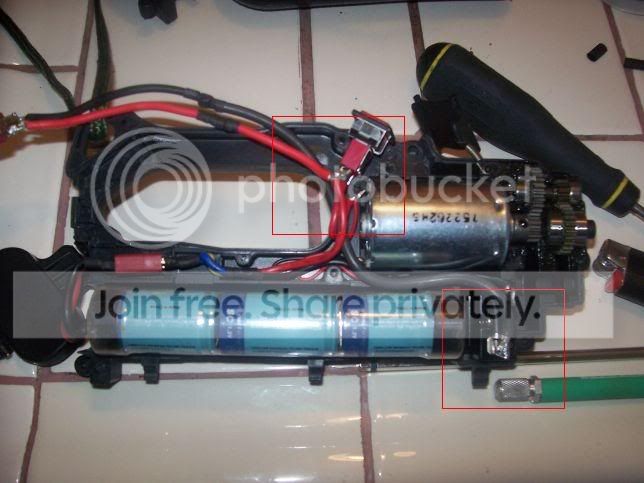

I wired a battery into my Rotostart. But you could use the idea and Traxxas plugs instead of Deans plugs. The charge lead isn't necessary for the mod, I just didn't want to have to take the battery out any longer. Its 3900mah so it doesn't need charged often anyway.

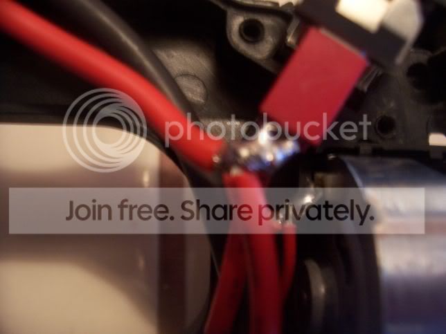

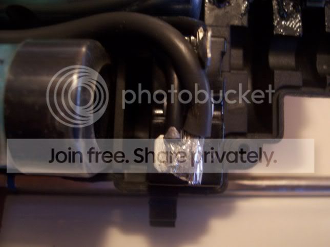

I just wired 2 wires to a plug and ran it through a hole I cut in the end of the handle. The + is soldered to top of the switch and the - is soldered to the box at the front of the battery.
Way easier to charge this way.
