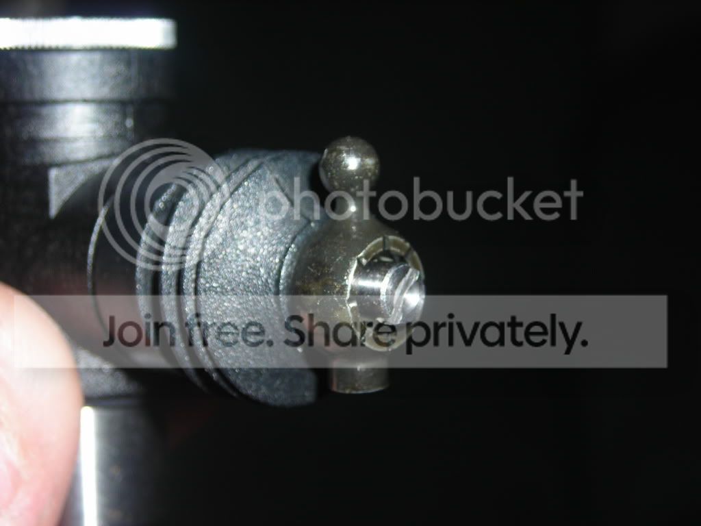

I do have a few questions though. The carb settings are very odd. The LSN is sticking very far out from flush and the HSN looks to be turned in from flush about 1 turn.
I know that this is a completly new carb from picco but just wondering if I could get some help on those settings. Should I leave them as is or set them to flush?

Picco .26's from a few years back had a tapered LSN and came with an extra blunt end needle, all the .28's have got a blunt end LSN. This gives a more snappy throttle response.

Being the newest version of carb, I doubt you will find much info as they have only just become available. It's a good idea to get vid of it running for the first time, I can tell you exactly what to do with it if there are any issues.
Sounds good Robin. I am sure once I get it going tuning will be simple enough just was wondering about the starting point.
Here is the lsn setting stock.

Yea mine was the same way and i left it alone and it fired right up! did not touch any settings for about 5 to 6 tanks in! just today i started tuning a little but the pinch is still tight! takes patience with these motors thats for sure!! had mine for 2 weeks now.

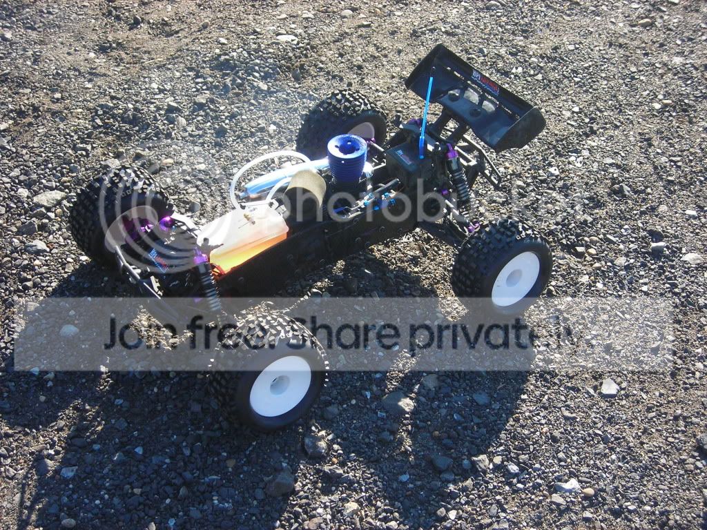

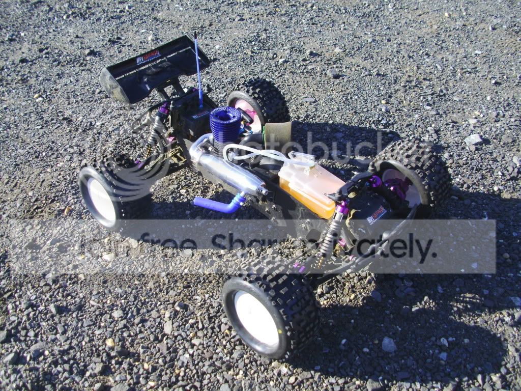

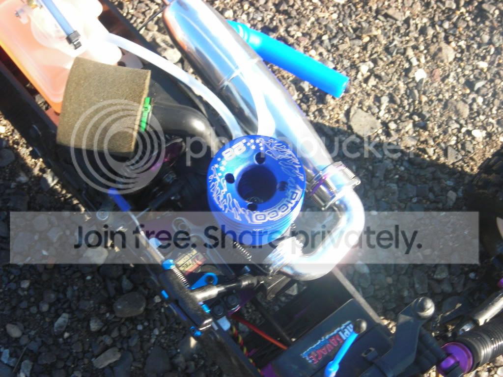

Well started installing this thing this morning before work. Picked up an 18 tooth cb so I have to do a little moding to make it fit. Had to do a little work to the 086 header as well to get it to work in the right direction.
Got the picco put in along with everything else. Here are a few pics and a vid from today. Just started breakin.
Nice looking truck Pope!!
Okay vids taking forever to load.
Well I am very impressed. I couldn't preheat it. (AJ's preheat lamp died) It fired first or second pull all day. It is very powerfull you can tell that even with it being as rich as it is for break in and with only minor throtal. I had to dial up the expo to 30% so I could get it to roll up nice and easy. Got about 600cc's through it so far.
