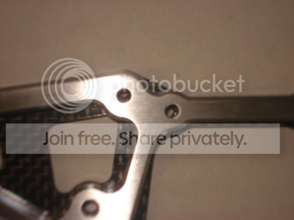

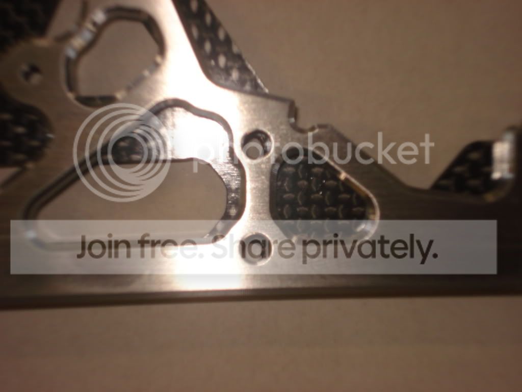

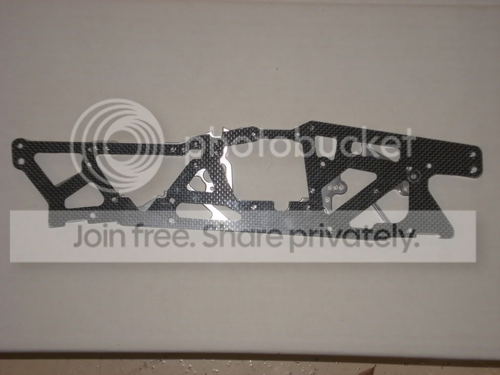

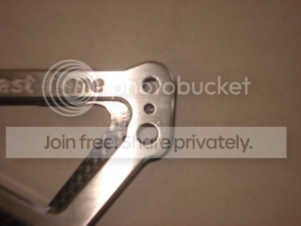

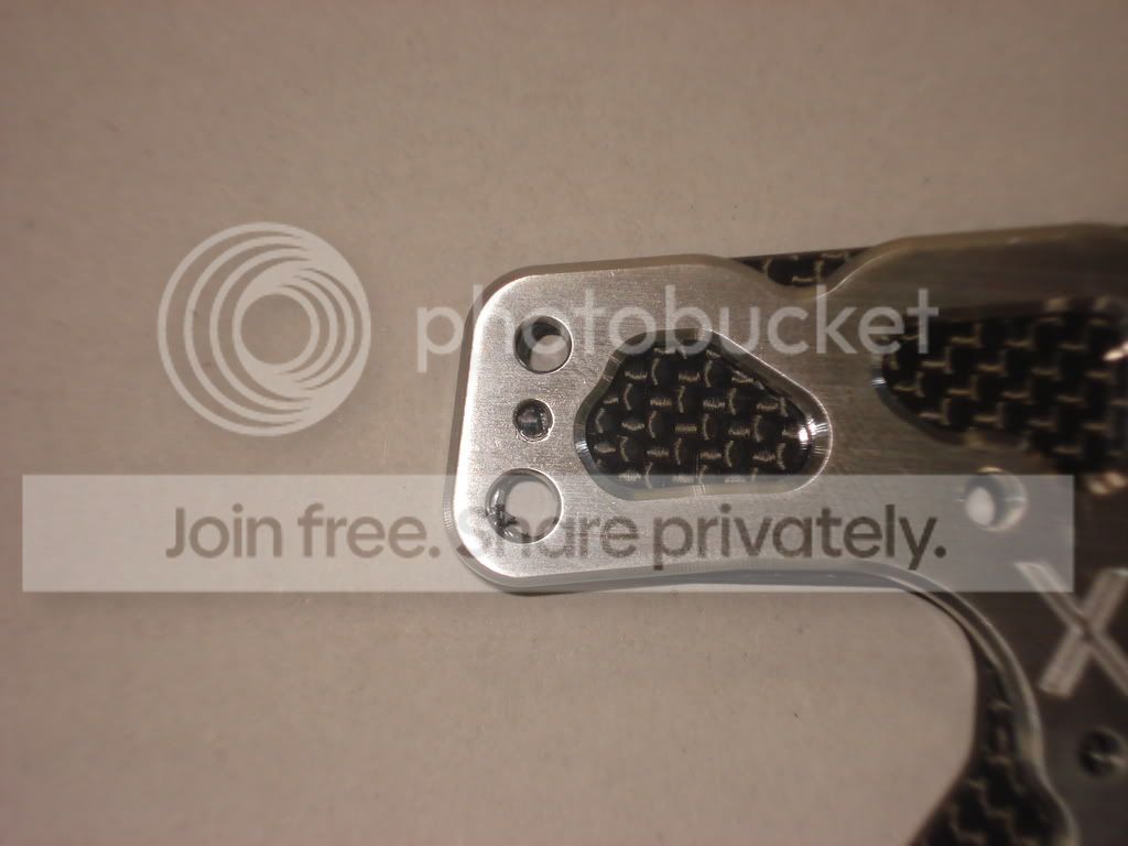

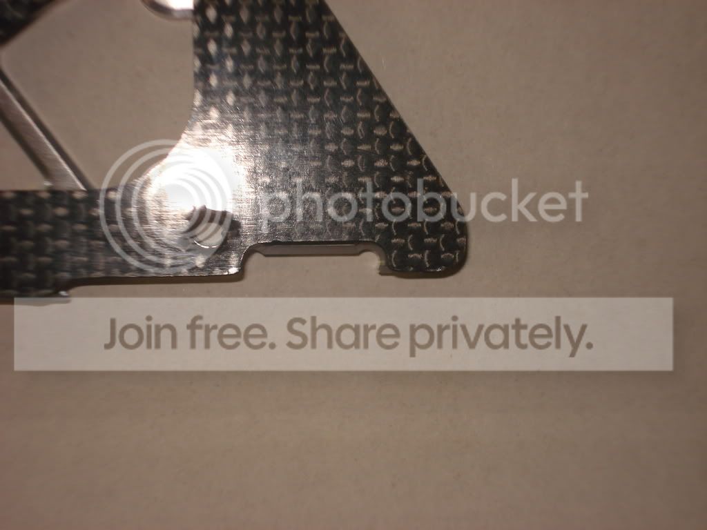

Here's some pics to show what I was talking about when I said I was having trouble. These are brand new FLM TVPs used for comparison.
I think the trouble I was having with the purple diff plates lining is because the cut out is further in than it needed to be.
More eyecandy.
All the holes were off in one way or another.
This is the hole that I oblonged with a drill to make the bulk head line up...still had to use a hammer to make it fit.
Same holes on the front bulk untouched, for some reason they weren't too bad.
I did notice the FLM holes are bigger but I think if I made all the holes bigger it would be detrimental to the overall strength and would allow for movement.
My parts are different from the FLM's not sure why this is a problem? all the holes are off in the same direction that need to work with each other. We all don't want to be exact everyone is different just like everything. I understand where you are coming from however take theres and line them up with the stock TVP's and they are way off. They are all different a little bit as everyone has there own idea of fit an finnish, not saying mine done need some work but just stating that everyone has there own ideas. They have many fitments issues as well.

I just wanted to compare them to what I would consider a "standard" and give Jason an idea of what was going on. I still think a bigger drill bit in some of the holes might help alot, I just want to make sure it will not void my warranty. I have changed body panels an cars, not to mention being a liscenced Airframe and Powerplant mechanic. Trust me, I'm no rookie when it comes to working on stuff. If I can fix this myself, there would be no need to send it back. Like I said, I don't want to modify it and be left holding parts because I modified it to make it work. I think it can still happen.
Parker go a head and modify it just don't get carried away. Please PM me with the changes you made along with pictures if possible this way I have a clue whats going on with them and all. Don't worry I will take care of you either way.
We aren't drilling any holes any more they are all cut using the same tool used to cut the outer perimeter as we feel it leaves a much nicer finnish. Some of the holes have been opened up since these were sent to you as this is the only complaint I had when I installed the sets on the trucks around here. let me know on anything else and if you have any other questions.
