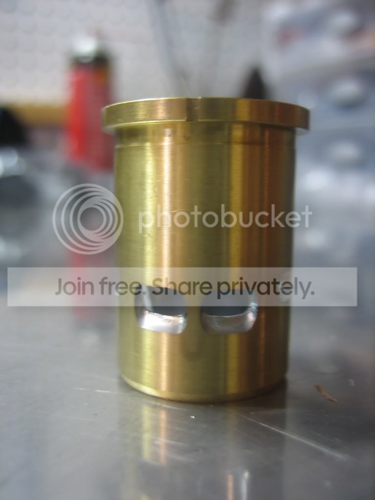

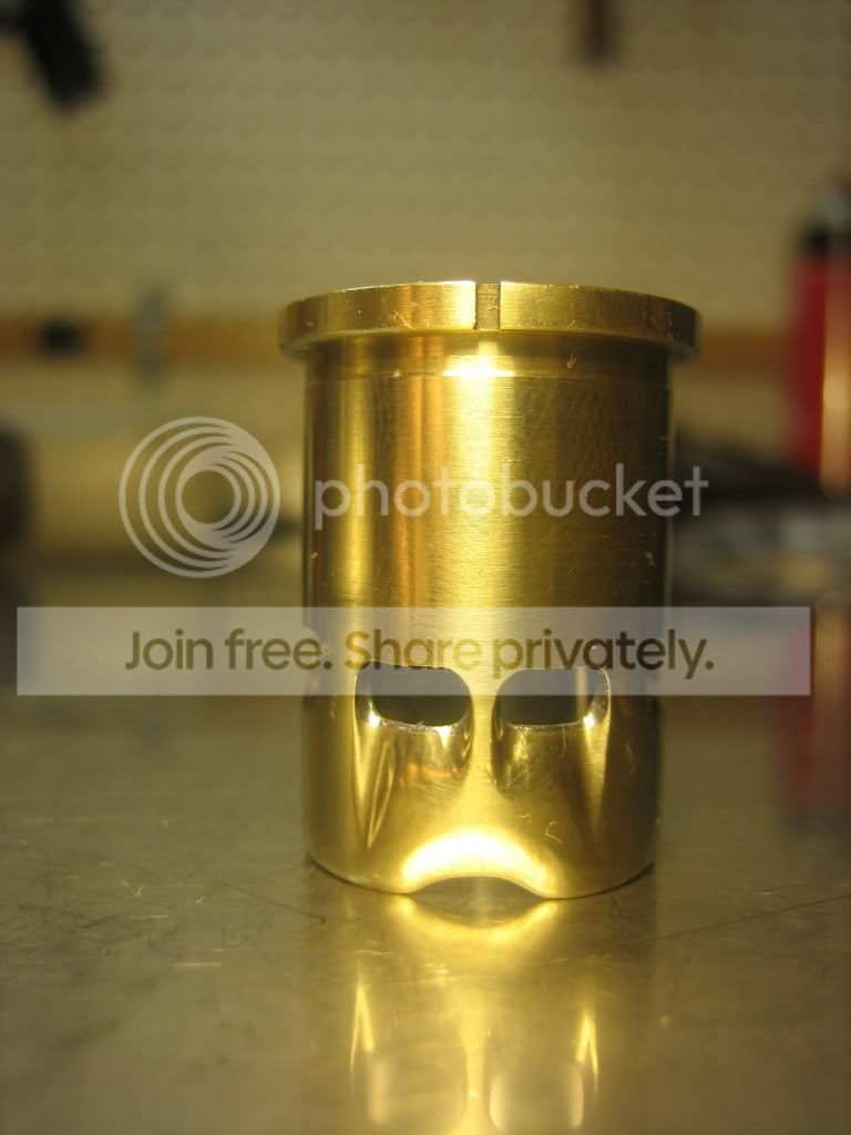

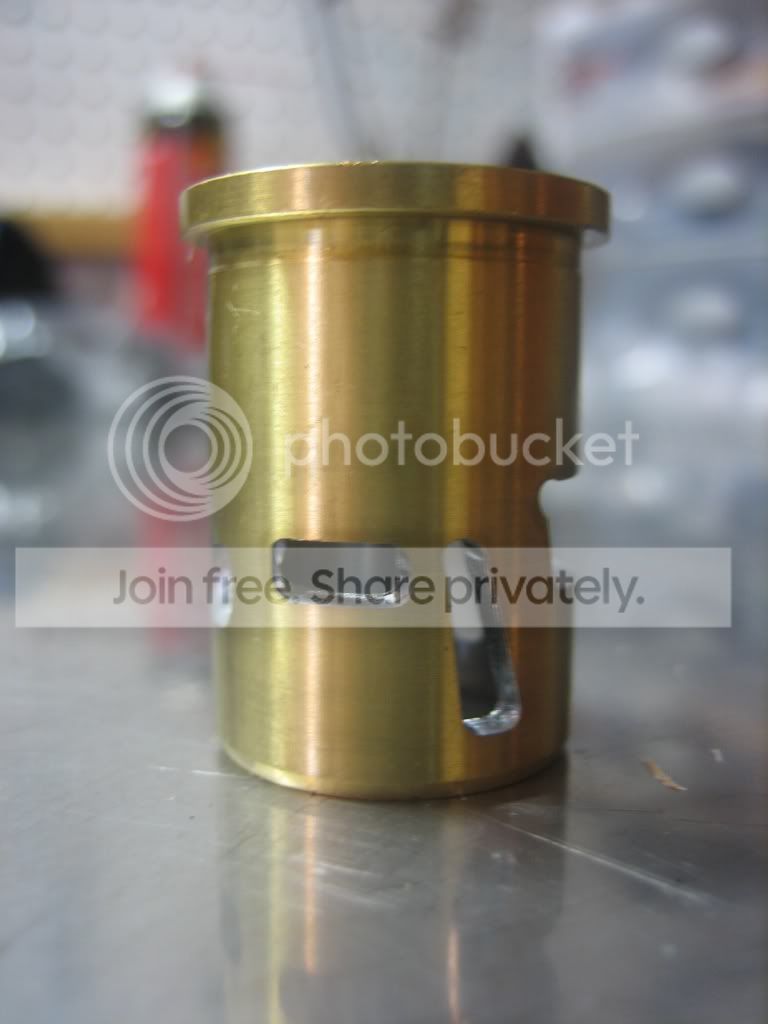

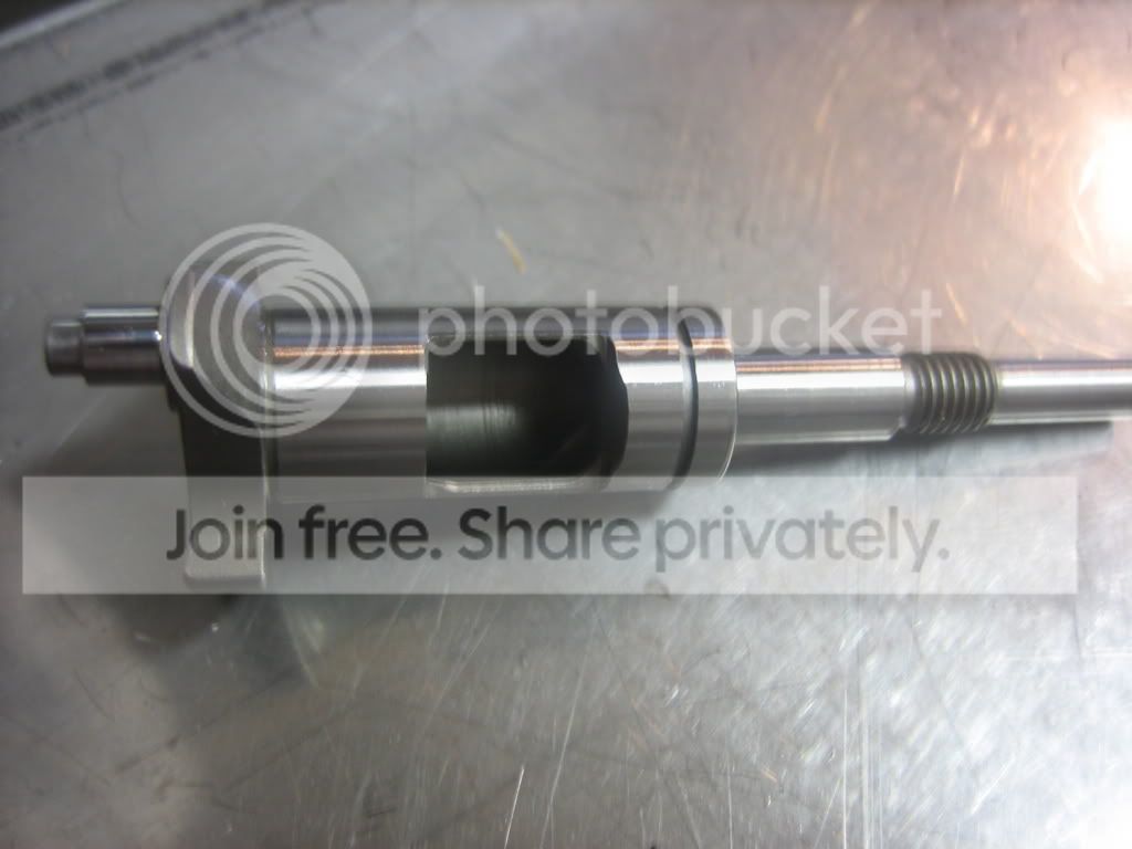

Well I purchased a new Mach 427 for a nice price on the bay for my basher truck but will be placed in my Racer for now until I purchase a picco for the racer. Anyhow here are some photo's of the stock sleeve and crank.

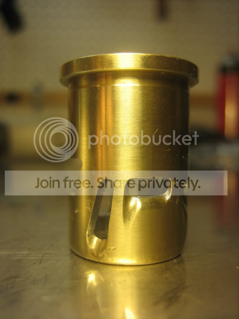

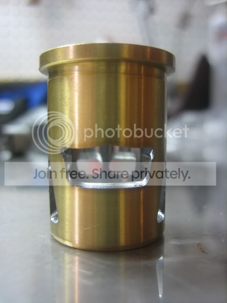

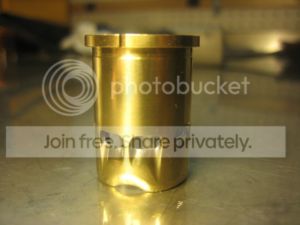

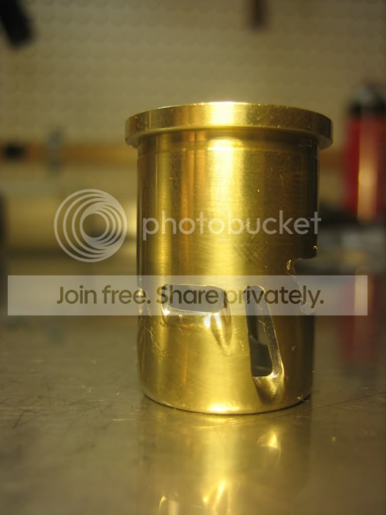

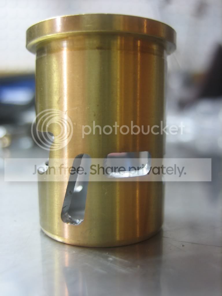

Now for some ported and polished Pict's of the Sleeve:

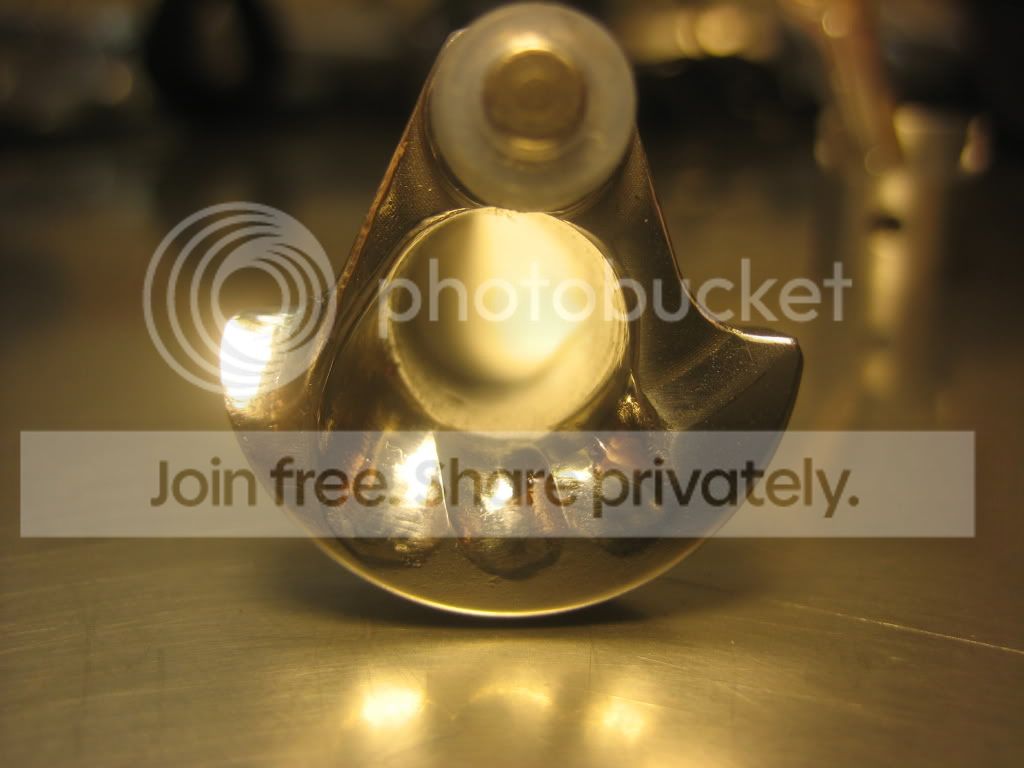

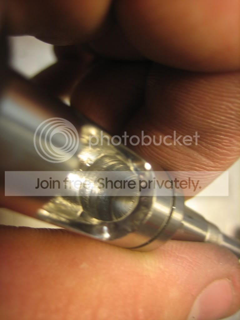

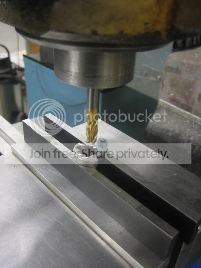

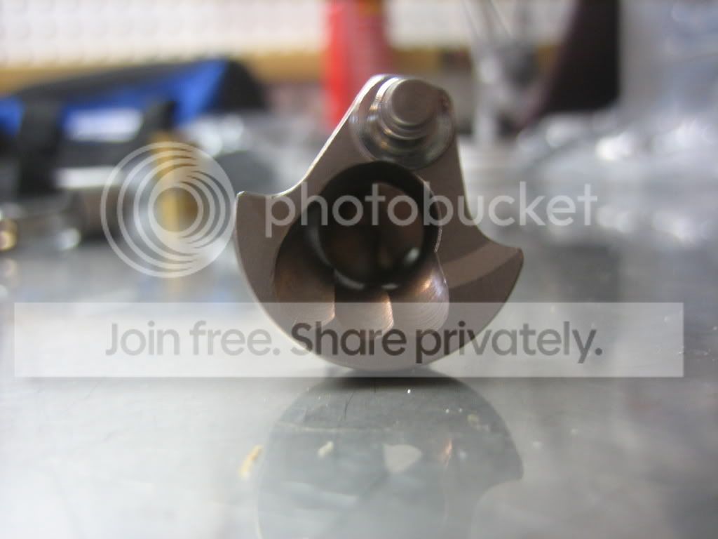

A few shots of the Crank in the Mill being lightened a tad and ported and polished along with a little timing alteration:

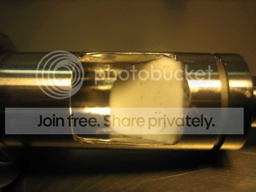

And the Fill Job:

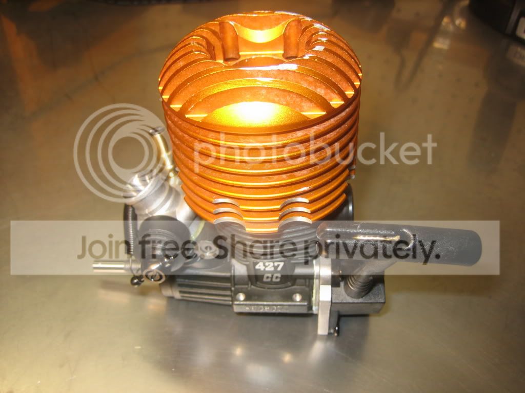

Sealed & Assembled Picture:
I also did a tiny little porting on the opening of the Carb along with a nice polish job. Sorry no Pict's of this. I may break this thing in and add a few scoops in the head button but we will see. It's a bit cold out right now.
great job man I ran that engine in my savy for a long time good torque fair power but very reliable tried to tear it up lol let us know how it works :resp:
Update: Sorry guys I have yet to run this thing. Its just been too cold out side. We also had about 18" of snow on the ground which has now settled & melted down to about 5" but average temps have been around 8* and most days have been windy. This thing may have to wait till spring to come out and be broke in.
Well I got the chance to break this in engine in on January 24th. I ran about 5 tanks thru it so I could run it at the Monster Truck Winter Nationals in Sioux Falls SD that I was hosting. This was broke-in in our heated shop which was at 70*.
So along come's the 31st., time for the show. We had a heck of a blast and lots of run time.
This engine is the king. I have never ran an engine that has as much power as this thing. It was very fast, I let a few others drive it as well who have been in the hobby longer than I and they were completely amazed of the brutal power.
Not sure what i'm going to do but one of them want to purchase it off me who is the one thats been into R/C's longer than I. I'm just not sure if I want to let it go. Sorry I have no video's of it but boy does it go.
First of all...AWESOME mod job on the mill :resp: And I`ll bet it`s a good feeling for you that the engine has a killer preformance! Once again...great work!
Ya its a great feeling. I have never see this much difference before. This was a fresh mill so I don't know how it would have ran before this but I have seen the Mach 427's run in other savages and this thing would have absolutely killed them by probably double. I've never had a mill with this kind of power.
