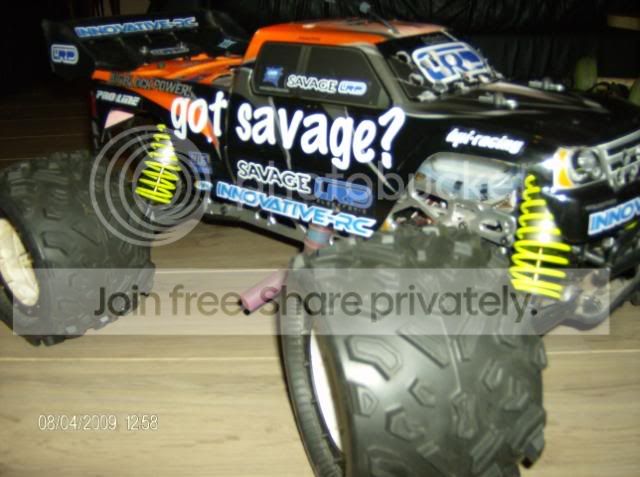

Hi all, well my hard anodized shock bodies and TiNi shafts arrived yesterday so i got my shocks rebuilt and filled with 45wt sillicon fluid and used half inch of tubing on the shafts to drop it a bit, 47t steel SS spur, i managed to get the 19t bell in so now its 19/47, motor saver sav100, put some new fuel line on, HPI large fuel filter and tidied it up with some fuel line clips that iv had for some time but never used, i also recieved my mugen mbx5 pilot nut for use with the nova shoes and mugen springs as i noticed one of the shoes wasnt being pulled back fully and has worn a little more than the other two as a result, but now the springs sit in mugen nuts grove much better.

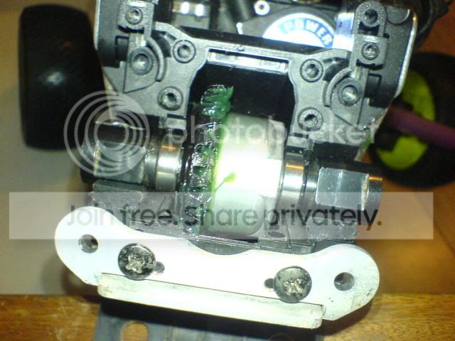

Fitted an I-RC ultra heavy duty centre front dogbone and replaced the three centre drive cups with the chrome hardened version, I'm forever going through the standard black ones so il see if these last any longer.

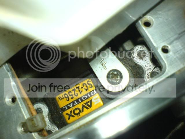

Got Savox SC1256TG 20kg Ti geared digital coreless servo for steer duties, this thing is a beast of a servo, very loud but very torquey! My servo saver spring is now far too weak and il be getting the new heavy duty spring in a couple of weeks when theyre in stock in the UK.

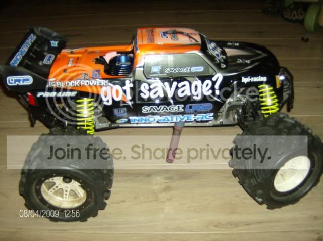

Quick piccie update.

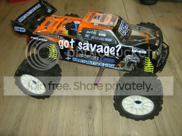

This is my truck now.
Few changes, fitted a set of Proline VTR 4.0" 1/2" offset rims with Proline Caliber VTR tyres, very narrow but also very light, the weight iv shed by going from the 40s big Joes to these is unbelievable! the truck feels so much lighter.
These are awesome, perfectly balanced, when i had them mounted to the truck while i had no diffs or dogbones in i could spin them and they spin forever, perfectly true with no wobble and no noticable heavy spots and no part of the wheel settled to the bottom when they came to a stop.
I did buy a set of Proline Wabash rims and 23mm adapters for the big Joes coz my axial beadlocks are now in the bin, but i just couldnt get the adapters to sit square on the XL axles, they are the Proline adapters for XL axles but there was just too much wheel wobble, almost enought to make the truck jump as it rolled! shame, they looked good, but seeing the weight difference i don't think il use the 40s/big Joes again.

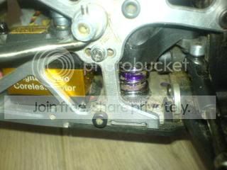

HPI heavy duty servo saver spring for a tight servo saver.

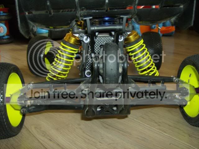

And my favourite change of all, the machined bulletproof 29/9t diffs and Flux composite bulks, iv gone through 2 more shimmed rear XL diff ring and pinions since the last pic update, the LRP.30 eats them for breakfast!
Front.
And rear.
The LST shocks and I-RC kit is coming off soon, iv ordered a set of alum big bores, not because iv had any real problems with them or the way the truck rides with them but because they are heavy and feeling the weight loss after just changing the wheels, swapping them for big bores would make the truck that much lighter still.
