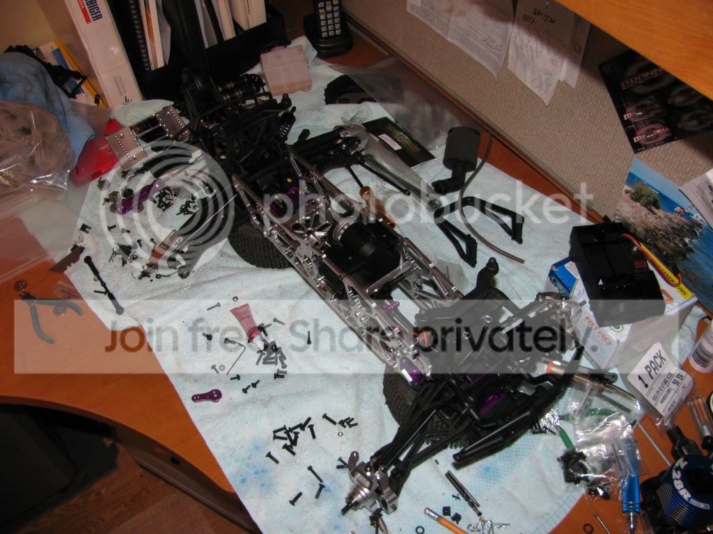

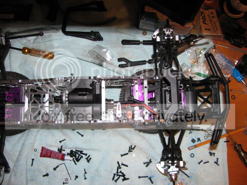

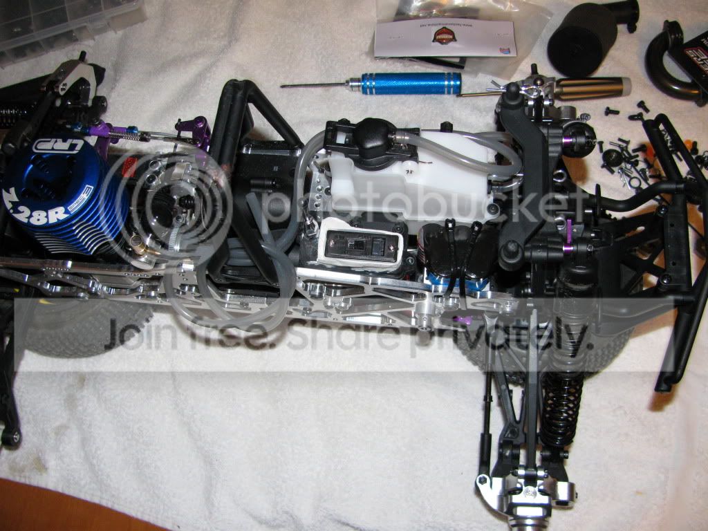

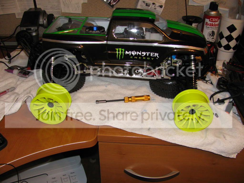

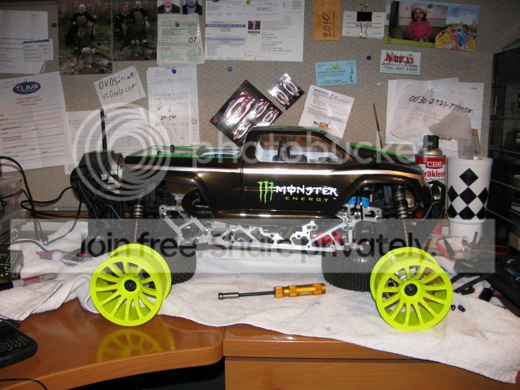

OK people, the desicion was made not to strip and reanodize everything because of cost. So I decided to finish this truck.
Below are some pictures of where it sits as of this morning. I couldn't get it all done yesturday, but its coming along.
Enjoy

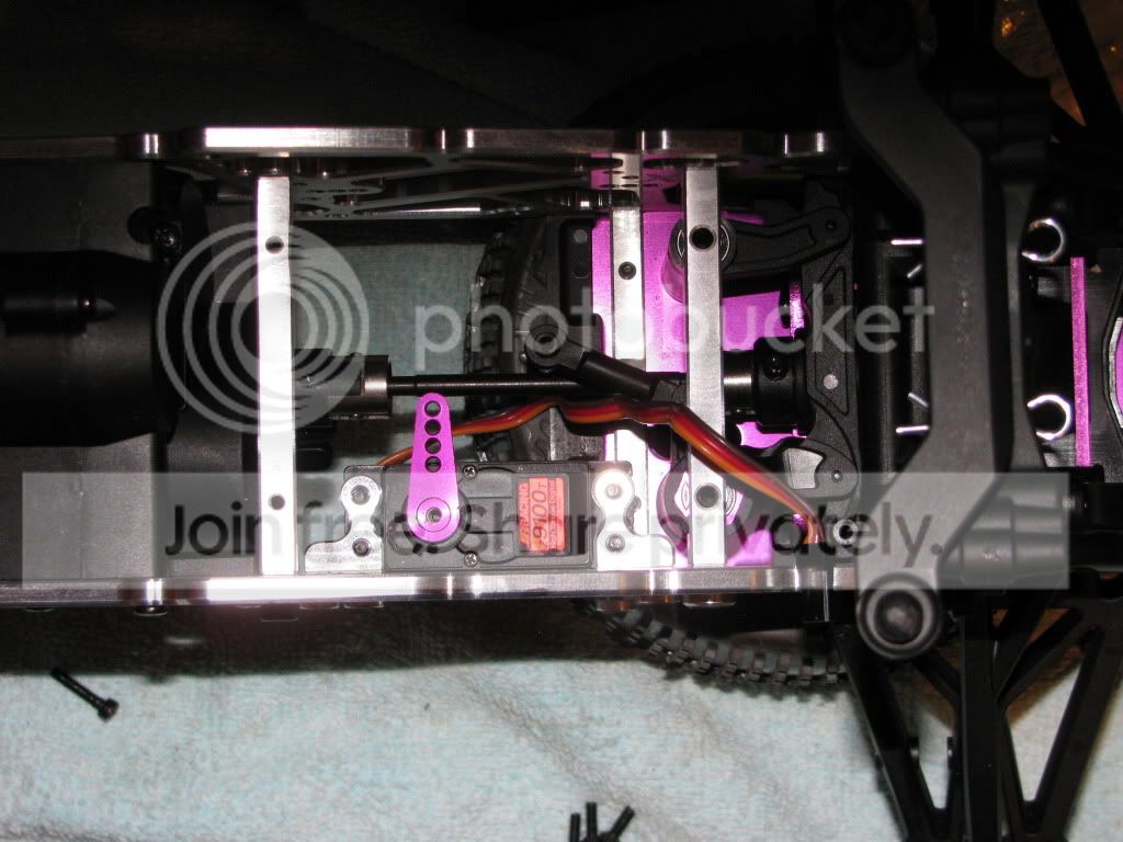

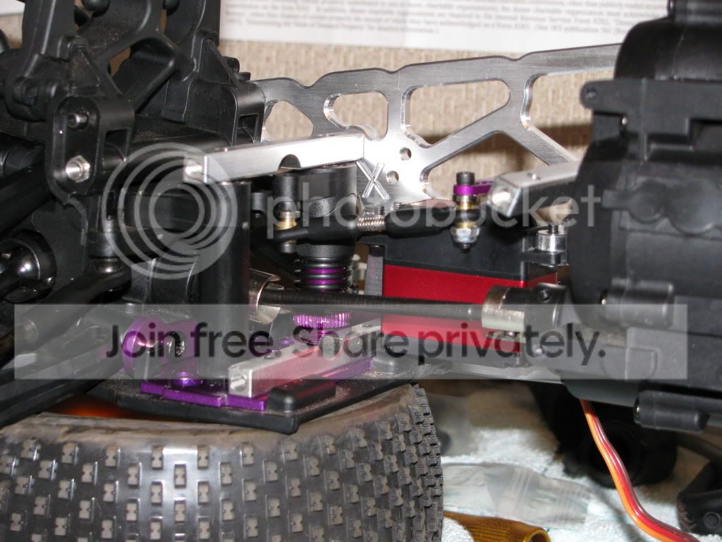

Are you going to flip the steering servo around or get a longer linkage? Is there an advantage to running like that?

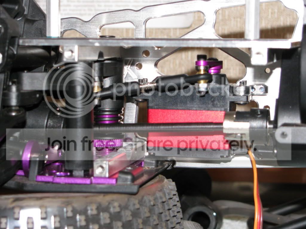

I will show you in a quick video. If you go to your LHS and get a DUBRO RACING KIT #2266 and a piece of 6/32 rod stock you will be able to make what I did. It is heavy duty and allows it to move freely without binding. The other reason I flipped it around is the angle of the short shaft I didn't like. I will be posting some pictures below.
Linkage setup:
You can see there is a pretty sharp angle. The dubro kit is mad for planes and is heavy duty. I has brass ball ends and also has this tappered piece that allows for more angle with no binding.
Let me know if you need more info.
Great tip bud! :resp:
Thanks for the info! Unfortunately my LHS is not that great :( I'll see what the have though.
I have the Baja link right now, gonna see if that will work. If not I'll defently give your way a shot :)

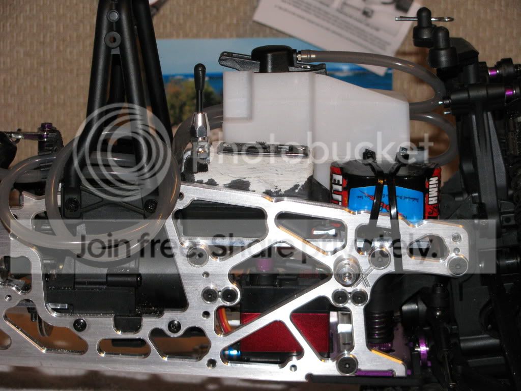

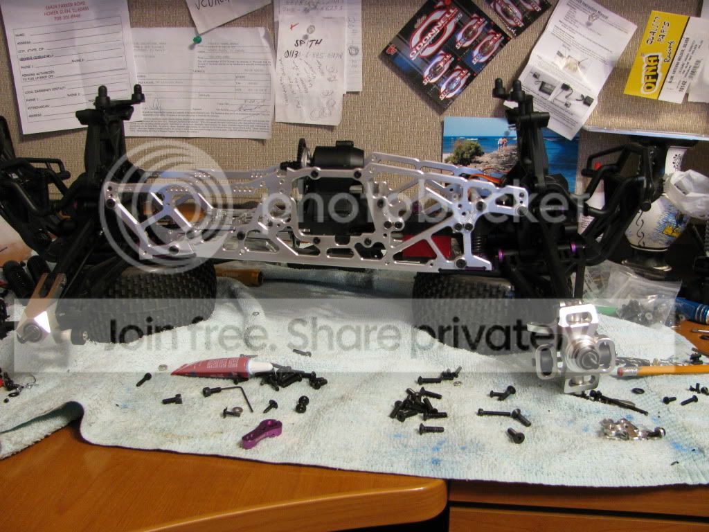

After a week of being outof town I got to work on it yeturday evening and this is where it stands. Pay close attention to the modified reciever box to accept a switch with charge jack.
great looking build, this is gonna look exactly like the build I'm gonna be starting shortly, with a few small difference. yours looks great tho! sorry in advance for building a twin, it was unintentional. lol
No problem on the copy. It doesn't bother me. As long as you are happy that all that matters.

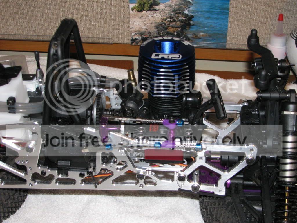

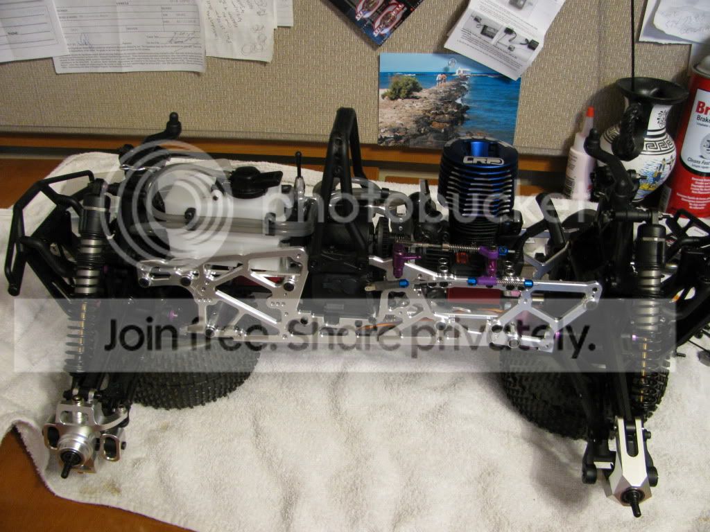

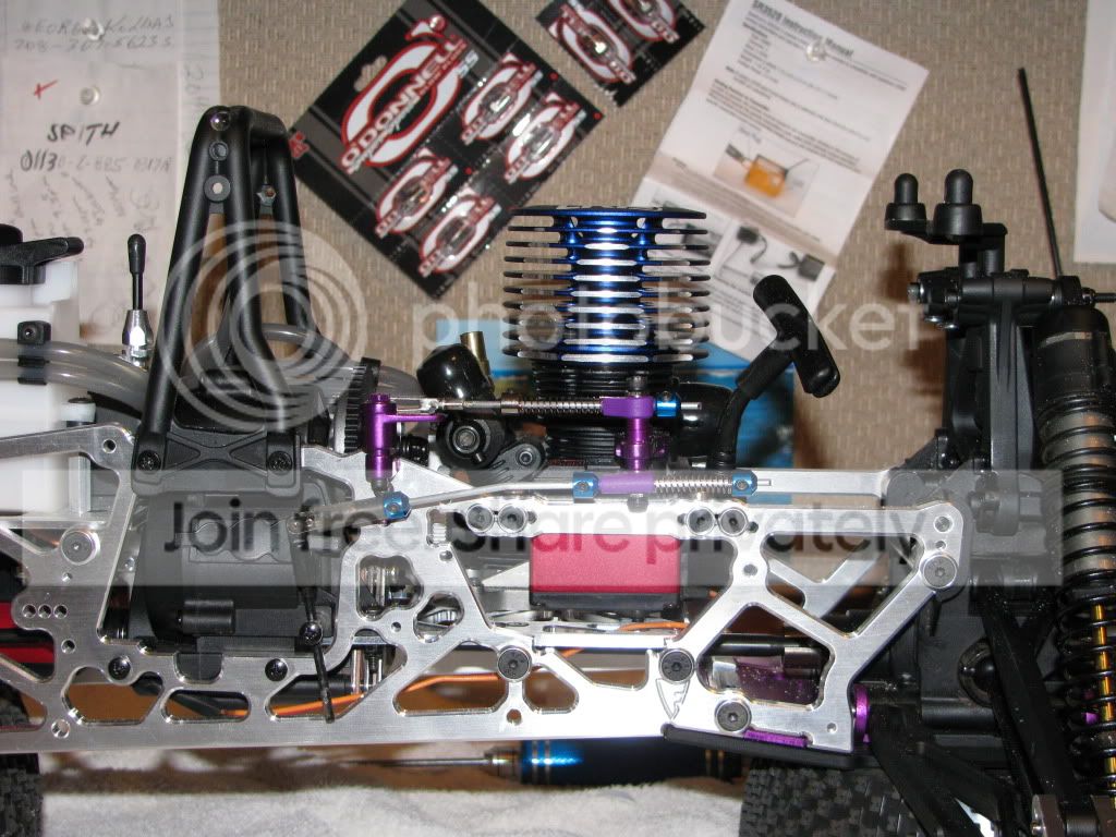

My midtank setup is officially finished. I just have to dye the wheels black and call it a day.

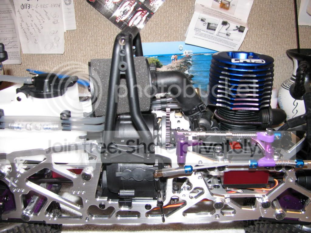

I added an Jammin JP4 pipe to the LRP motor. Had to use a Team Assiciated Header and redrilled it to fit.

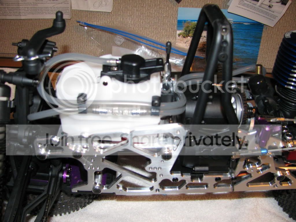

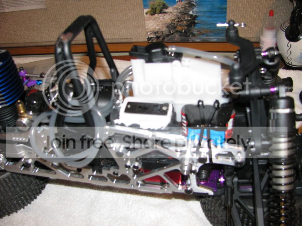

The fuel lines are nice and neat. The fuel filter is run in between the fuel line mounts on the tank. It is a clean setup.
Looks real nice bob. Cant wait to spank it with the flux, and watch you convert it t[YOUTUBE][/YOUTUBE]o bl, lol. Maybe the lrp will stick around a little longer than the 5.9
no doubt, sweet build.
glad to see you using the silver-meaty washers; which ones did you use?
