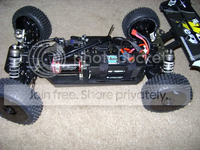

as of right now there is one thing i do not like about it and cant figure out why it does it... but when i do wot the mech brake servo mount twist into the spur gear causing the ace servo metal case to hit the spur and shot sparks everywhere... everything is tight so I'm dumbfounded.

the tekin motor is EXTREMELY smooth, even with the MMM you can tell a huge difference. its much smoother throughout the powerband.
even on 4s and the 1700kv motor the buggy had plenty of power. it actually was PERFECT.
before the racing started i pulled the brake servo as it was not working right. with motor brakes the buggy ran great so i do not plan on running mechanical brakes in this.

over all the buggy is great. with 20/50 gearing the temps where as follows
motor- 140F
esc-90F
batts-80F

How is the weight distribution? I looks like the batt and motor being on the same side would make it off-balance - have you noticed anything like that?
SUHWEET ride tho - congrats!
