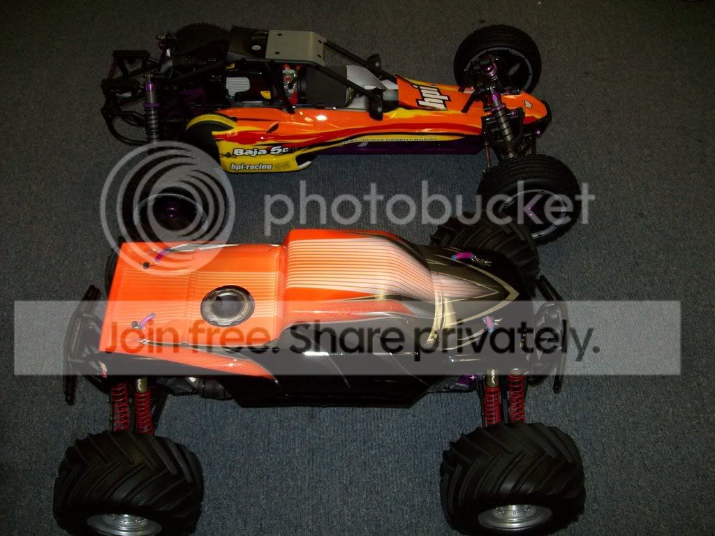

I recently ordered a Desertboy 17 conversion from GCM making my Flux almost 1/6 th scale
here's my build in pics and some comments:
--> 1st i widened the axles with the integy XL hub carriers en XL x wide axles.
then the chassis
desertboy 17 conversion chassis made by gcm
batteries are now inside the chassis
steeringpost mount:
servo mount en esc mount
esc mount & reciever mount in progress ;)
my receiver is now in my Rusty receiver box so its safe and my antenna is attached to the chassis.
batteries inside the chassis but i need better straps (that has been taken care of now)
allmost complete... still needed XL body in fiberglassssss.....
home made skidplate:
the finished BEAST!!!!
just made some runs with it and its great! handles like a charm, doesnt roll over anymore, no wheelies on 4cells but still on 6cells its great! now i cna really enjoy driving it and its still loads of fun, i'll post some vids when they're ready!

i run both on 6 and 4 cells :) on 6 cells it still pops wheelies like before and the agressiveness is awesome to say the least but 4 cells is more for just driving fun especially in the woods where i don't have alot of space and do more crawling over some trees and in ditches and stuff :)

well i have some problems with it it has cracks all over the body and the holes for the bodyposts are cracking also so its a hard shell with no flex and if you bash it tends to brake instead of flexing ;)
i'll order a proline baja body for it next time!
