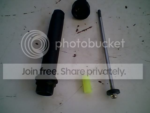

1/2 ench fuel tubeing

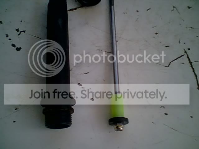

place it onto shock shaft snug it down to the piston

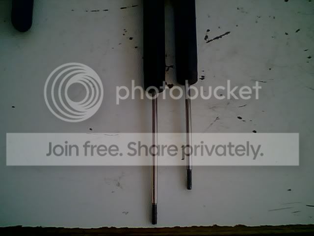

stock length of shock next to the modded length shock on the right.

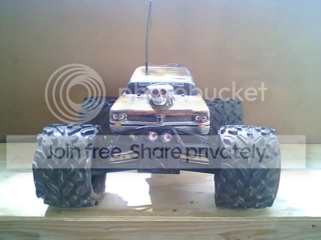

one my trucks with a arms level with ground

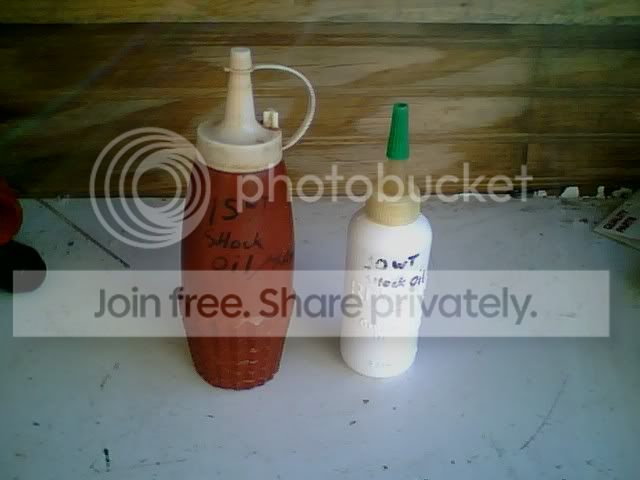

i use these kinda bottles to put the oil in my shocks .. don't laugh lol I'm sure if yall got a lady in the house ..in my case 2 of um .. lol youve seen the revlon hair dye bottles in the trash can.. they work awesome for refilling shock oil. so do the picnic mustard and ketchup bottles as well...
