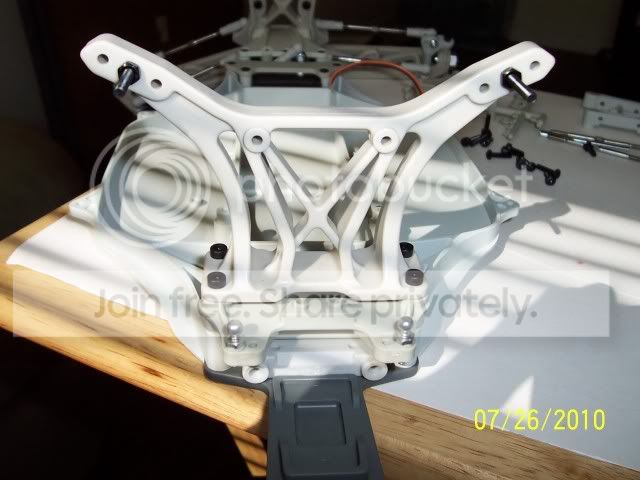

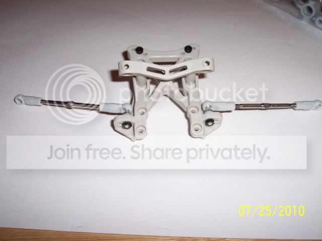

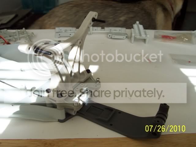

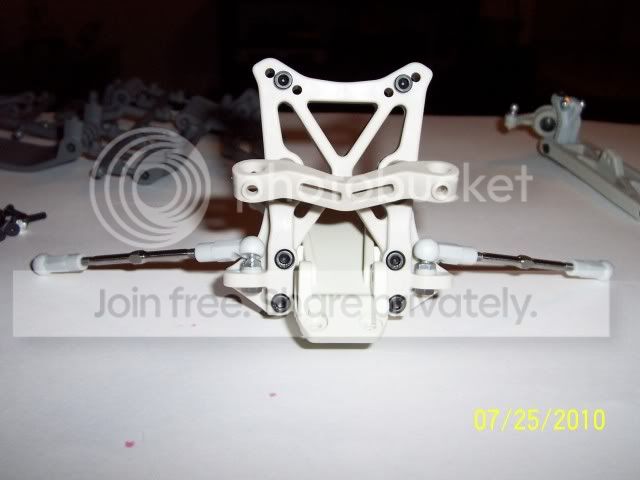

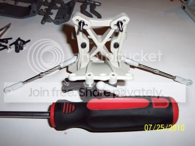

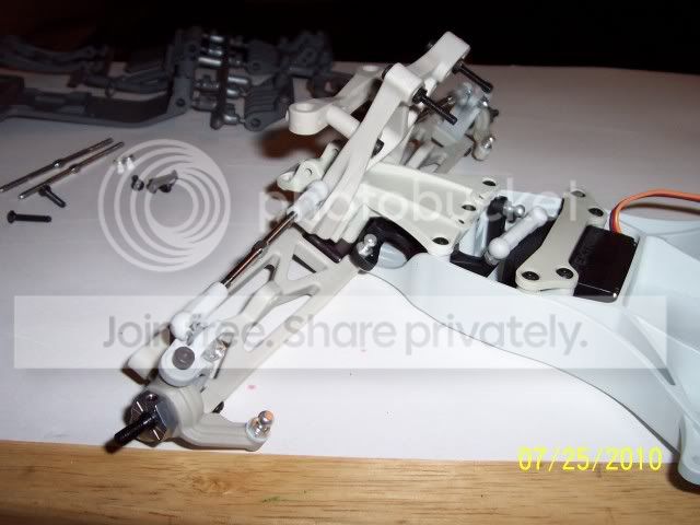

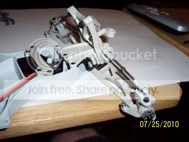

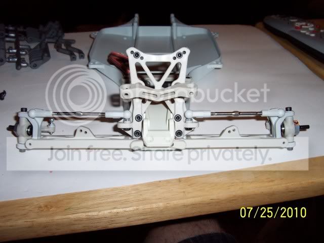

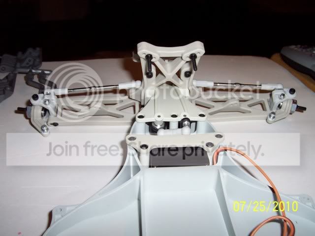

Got some more work done tonight along with pics during the build process. Mainly got most of the front end all done minus shocks and bumpers. Also still need to hook the servo arm up to the servo saver, but can't do that until I got the funds for a new Rx. I maybe pickin that up on Monday or Tuesday along with gettin the ESC ordered. Well, here are the pics.
Front shock tower with upper arms mounted.

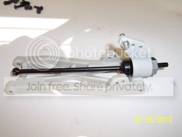

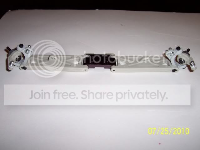

Lower arm mount, lower arms, hubs, carriers, and axles installed.
Shock tower and servo saver mount mounted together.

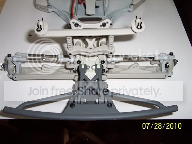

Everything shown above mounted to the main chassis. Along with tie-rods and bumper mount/skid plate.
That's all for now. I'll start on the back sometime mid-week. Or, after I get the Rx so I can at least finish the front end. So, stay tuned for more.

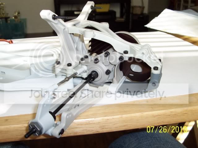

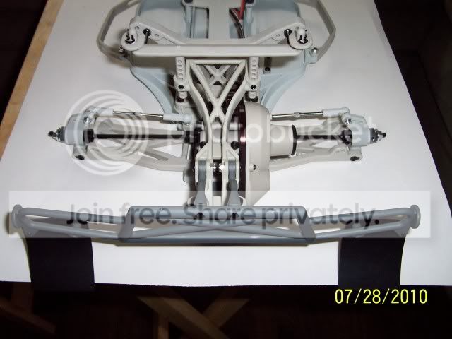

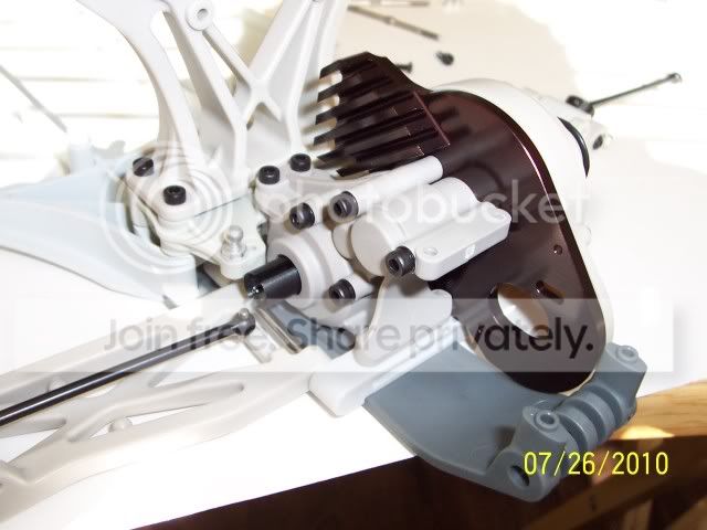

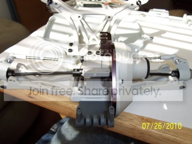

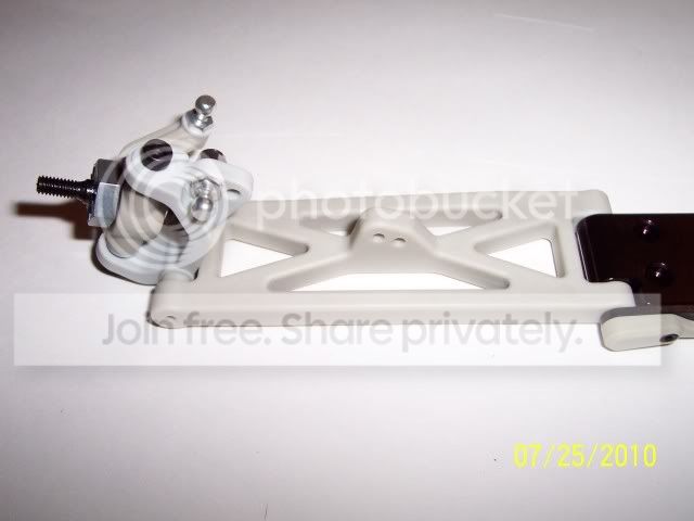

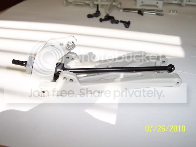

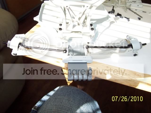

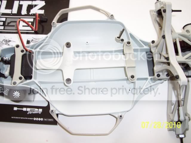

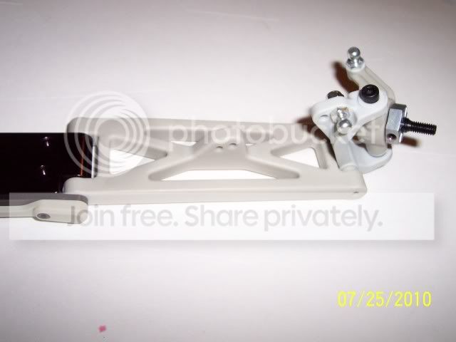

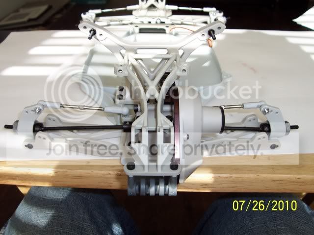

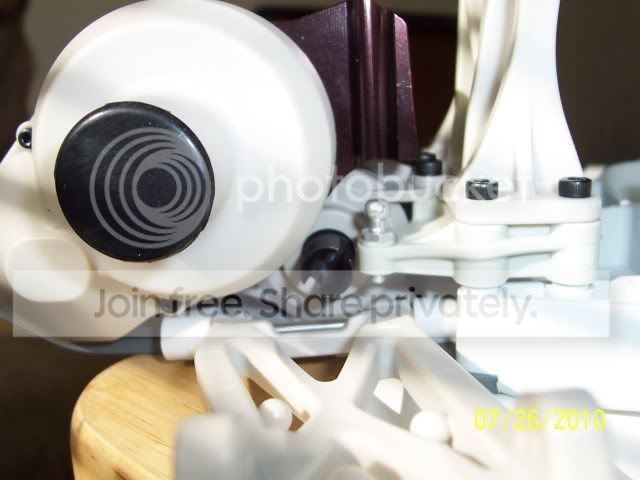

Got most of the rear done today. All that's left is the shocks, bumpers, body mounts, battery strap, and all those other odds and ends. Then all I have to do is get a motor, ESC, Rx, pinions, and battery and it'll be ready to run. Gonna pick up a Rx tomorrow and possibly order the ESC, if not, I'm gonna try and get the ESC ordered on Friday. Anyways, here's the pics.
Right rear arm.
Left rear arm.
Rear skid plate and shock tower.
Same as above, different angle.
Arms mounted to rear end.
Trans mounted.
Different angle.
Another different angle.
Rear upper brace installed.
Rear veiw of same pic as above.
That's all for now. Gonna try and finish the rest this week or next. Stay tuned.

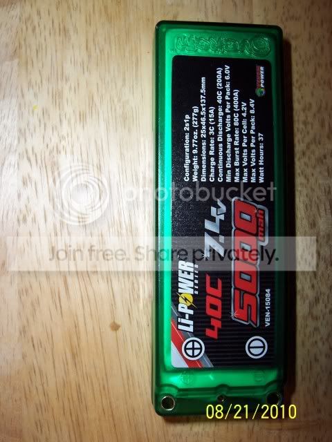

Pick up some more goodies yest. afternoon. I now have 99% of everything I need to have a runnin blitz ese. All I have left to get now are some pinion gears. The LHS was all out of the ones I was lookin for. I'm gonna call another LHS and see what they have and maybe pick them up on Monday after I get off from work. Now for the pics of the new parts.

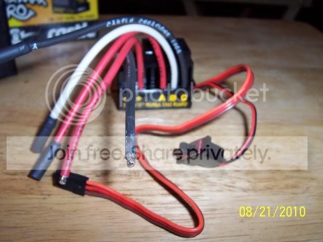

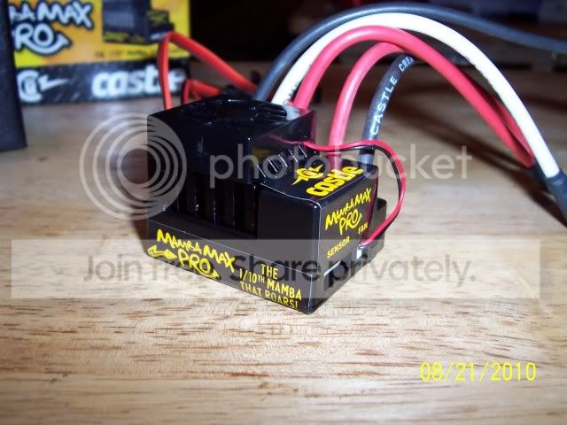

Castle Creations Mamba Max ESC. All I need to do is solder on the battery connector and mount it up. Also, in the box was a discount coupon for a free Castle Link USB adapter. All I have to fet now is the usb cable and download the software.
Spektrum SR300 Rx. (never got the one fom tornacl)

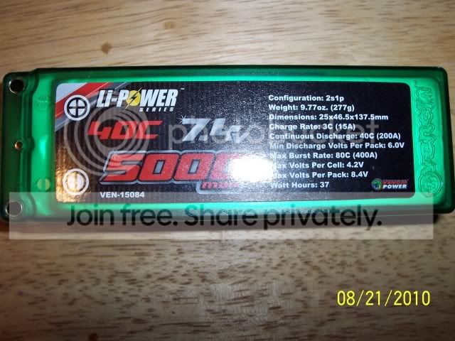

Venom 7.4v 2s 5000mah 40c hard case LiPo battery. It's got a burst rate of 80c. I actually got 2 of them, 1 for me and 1 for my wife's Losi Strike.

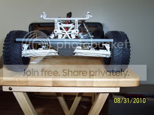

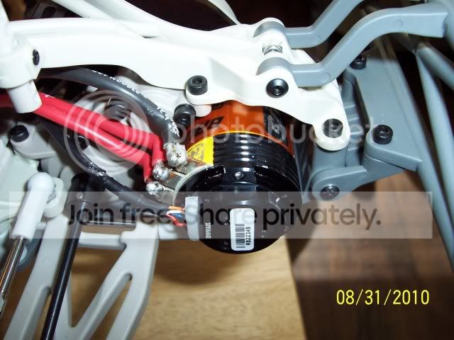

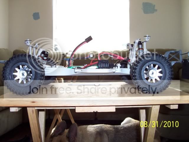

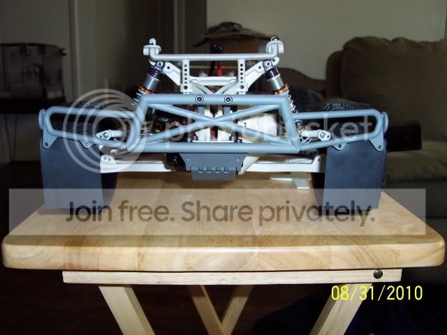

The Blitz ESE is finally finished. For my shock set-up, I went with HPI 40wt (400 cs), B piston, no internal limiters, and 11mm of pre-load for the front. HPI 40wt. (400 cs), A piston, no internal limiters, and 11.5mm of pre-load for the rear. As it sits, the arms are just above level. Now for the finished pics. I haven't got the body painted yet, gonna try and work on that this week.
Novak 17.5t sensored brushless motor. 77/30 gearing.

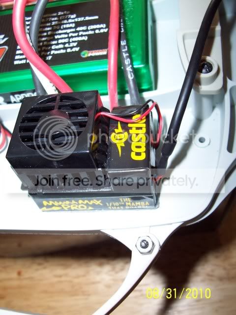

Mamba Max Pro ESC. Only settings changed via Castle Link was the LiPo voltage cut-off, BEC voltage output, and brake power.
Front view.
Rear view.
Side view.
Would have gotten more pics, but the camera batteries died on me. I also picked up a JConcepts undertray lid (or whatever they're called). Getting ready to go run the first pack thru it now. I'll update tom. afternoon.

I'm diggin those venom packs... interested to hear your feedback on those as well.
