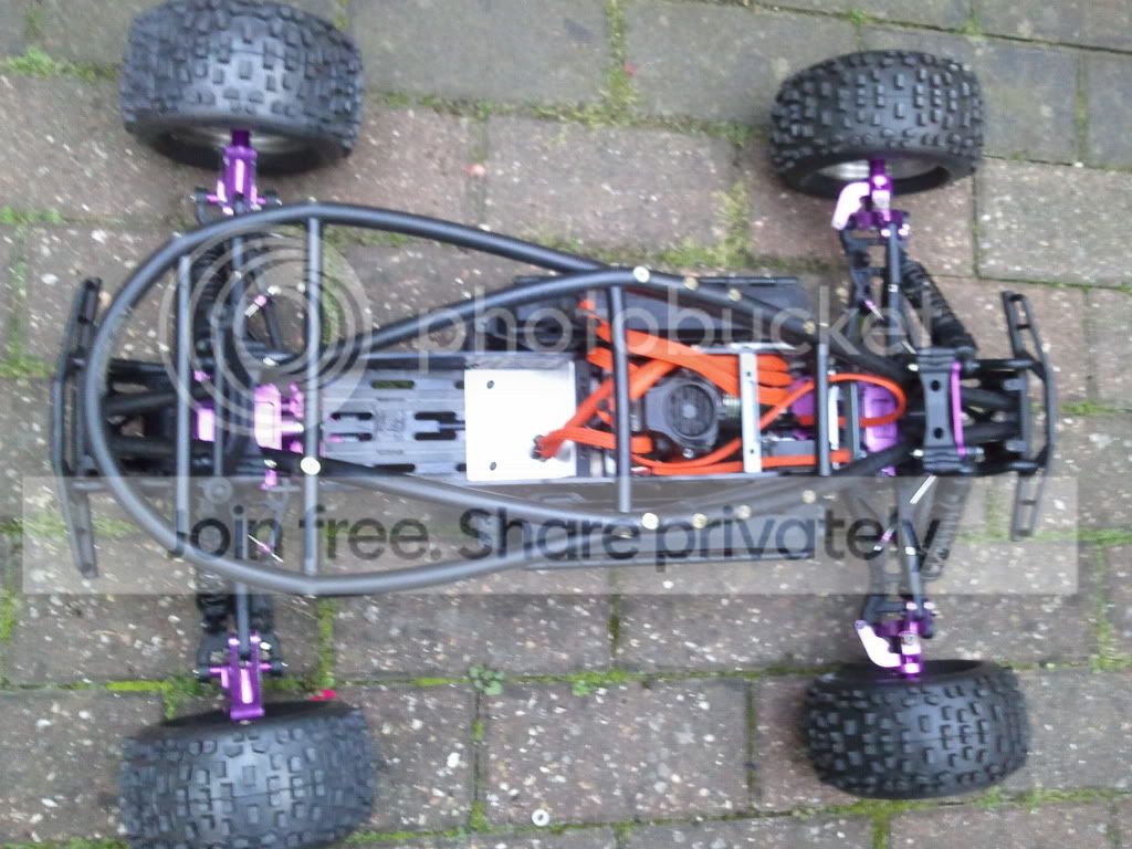

Ok ive been working on getting the truck into one piece this weekend... It has been apart for so long. The centre diff is complete, and i have put the LiPo boxes on as i am prepping for 9s... And also made a start on my own custom nylon roll cage... Its not completed yet as i still have to make the front shock tower protection and after thats completed, i will be setting the camber and shimming my axles and other little things like meshing the motor and CD....
Tell me what you think?

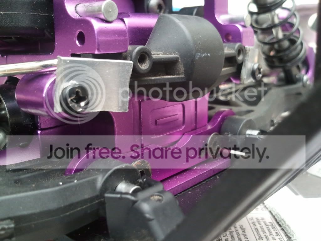

First... I bought a cheap tap screw set to try and tap the bulks for my sway bars... anyway that didnt work so i improvised... It works and will hold for the time being... Not pretty but i don't care.. i just want to run teh truck

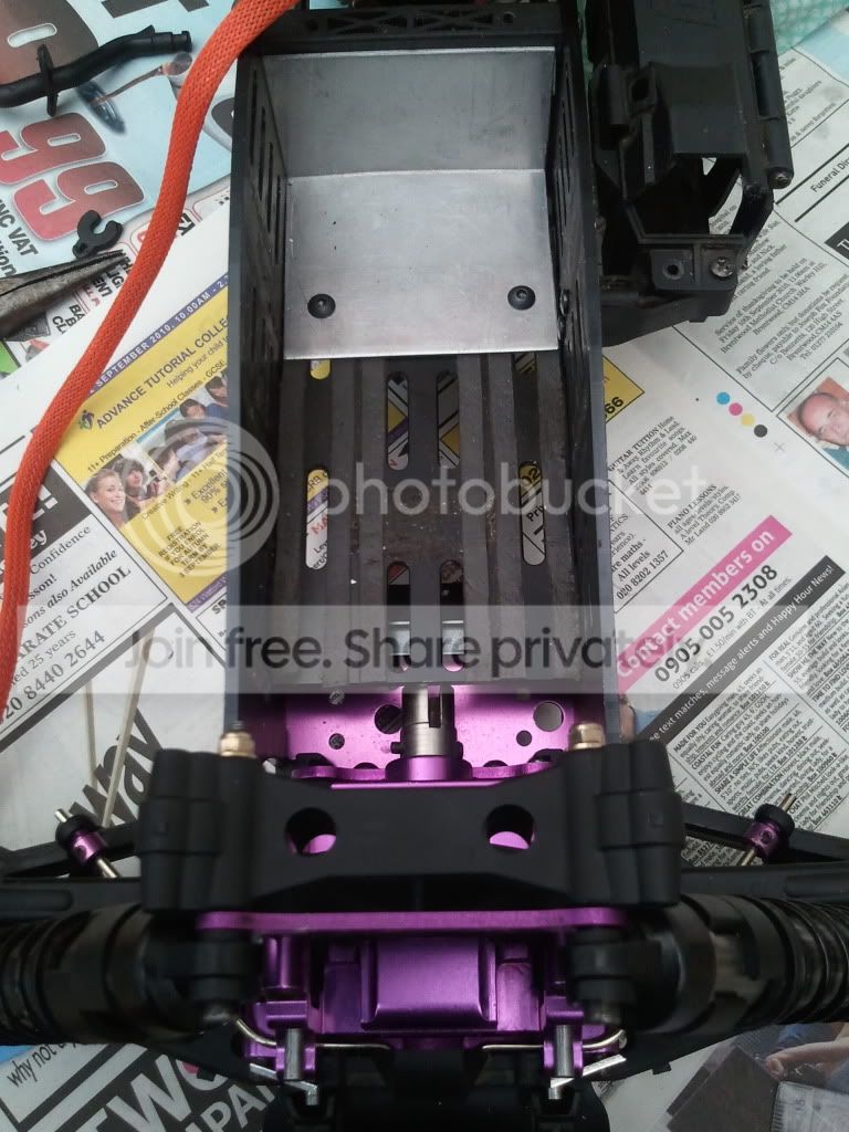

Made an internal LiPo stop. Will prevent the LiPo flying into the centre diff...
Ok the pics of my cage....
How it started...

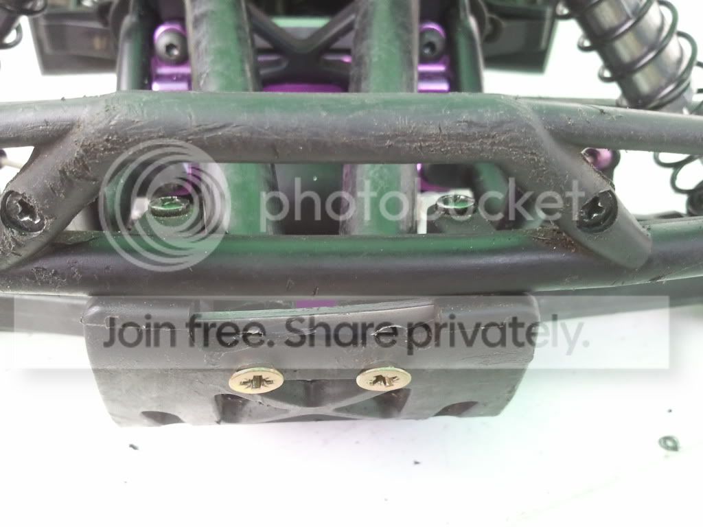

I attached the nylon to the bumpers... this way, force is transferred to either bumper rather than the TVPs or anything else...
To hold the screws in place, as to not rip the plastic bumper, i used a small alloy plate....
Making the rear shock tower part of the cage...
And thats where i got to today... The rear needs a little more support, but i stopped early as i was getting tired, and didnt want to mess up the job...
Here are some more pics
I haven't got a picture yet, but i have put all my weight on it although its not finished. It does take a lot of force but with a lot of flex absorbing the impact.
Thanks Mainst for the inspiration.... You know you would have had my business if it were not due to my chassis... :wink:
Will keep you posted as to what it will look like when finished...

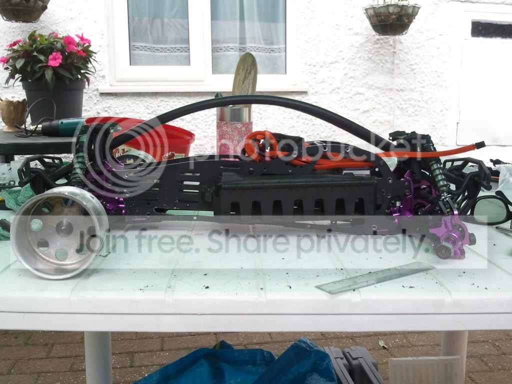

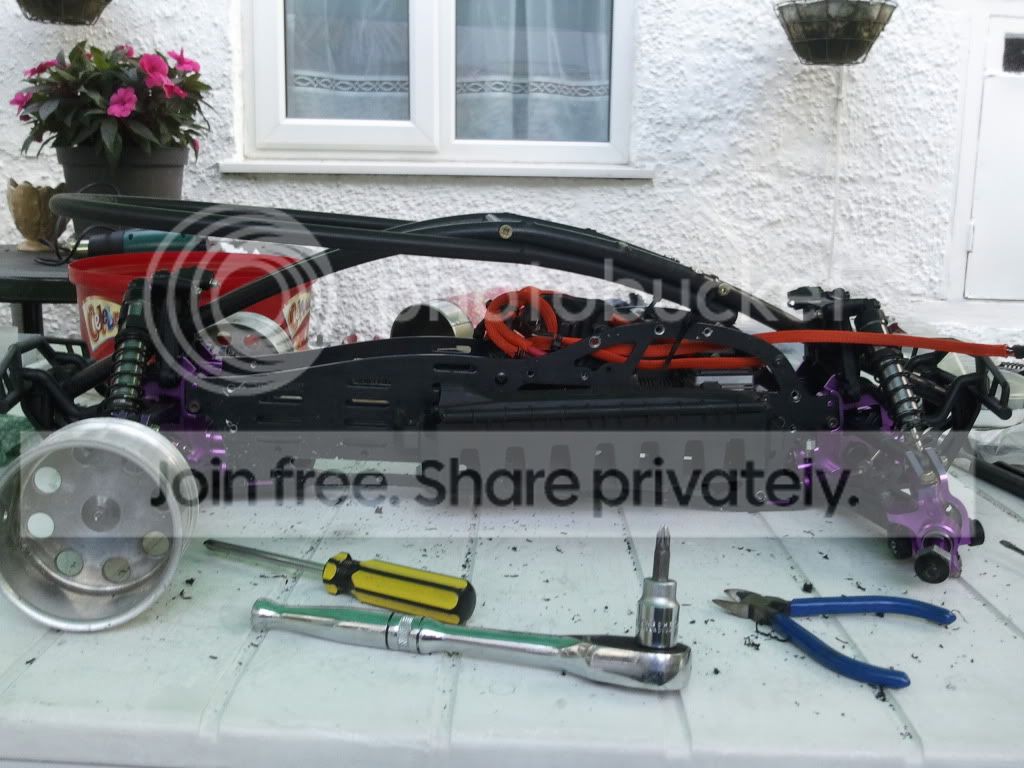

small update to the cage...
still not completed but it is very strong now whlist maintaining a lot of flex... I can now put all my body weight on it...
These are the rear supports. They are very strong but offer a lot of flex to a point
The cage isnt finished yet... should be done in the next few days...

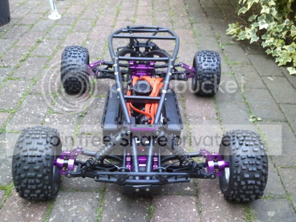

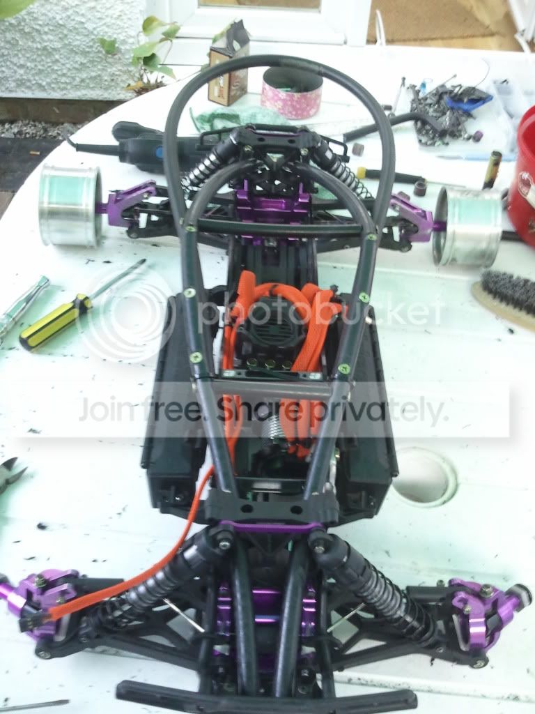

Cage Update...
I have spent enough time on the cage now and the final part didnt come out how i would have hoped for...
i thought the cage would have looked better.....
I bought some 2mm nylon sheeting and this stuff is very strong, flexible stuff!!!
i'll let the pics do the talking....
as you can see the cage does not look great at all!!! and it just obscures my ease of accessing the internals of the truck...
so i thought i would remove the large centre cover part, and leave the front shock tower cover on to protect and offer some form of aerodynamic down force at high speeds (if it works)....
I would prefer to run the cage as is but the front shock tower support should offer some form of protection...
Plus i spent quite a bit of time on it, and so i don't want to remove all my wasted work....
I am going to make some rear A arm deflector things out of the nylon, should be robust and protect the rear a little...
