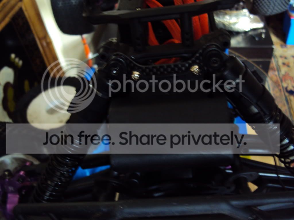

wing mount on and rush battery box mounted that house my reciever
THANKS JASON!!! Quality products!

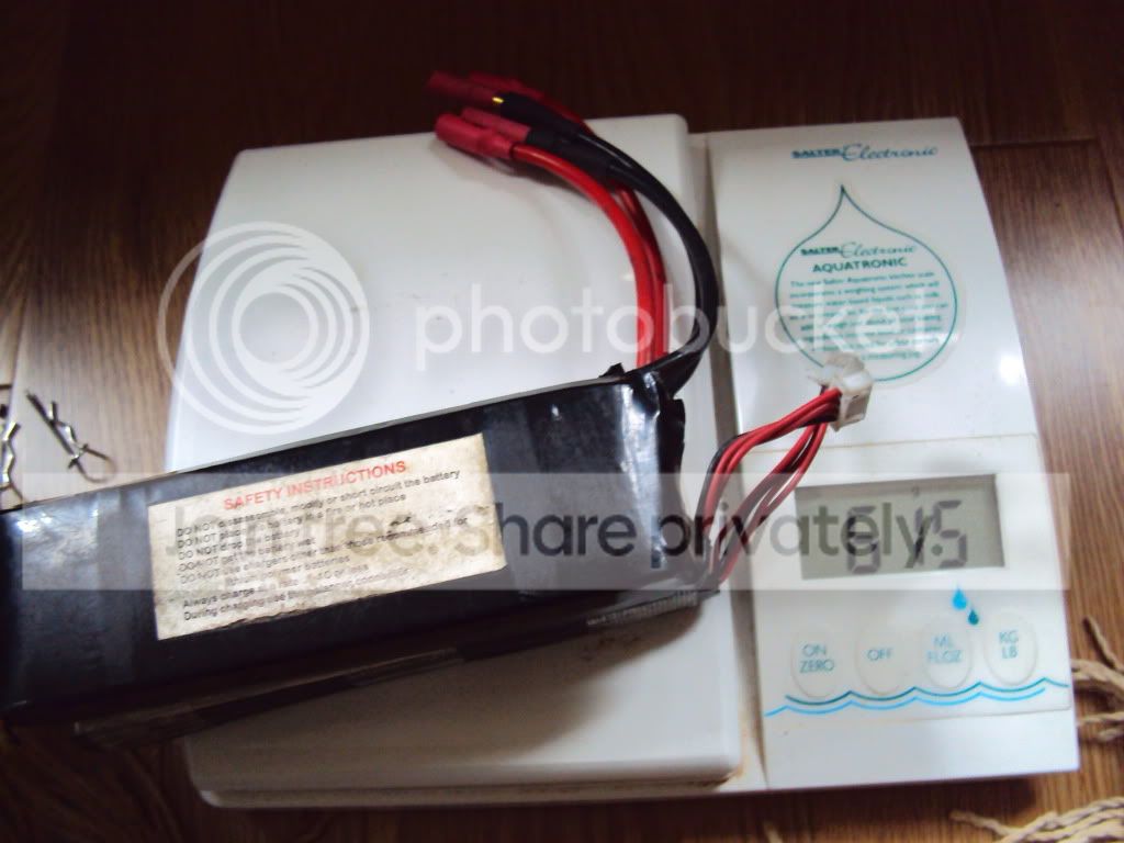

3700mah 3s lipos
3700mah batteries. 1.4lbs

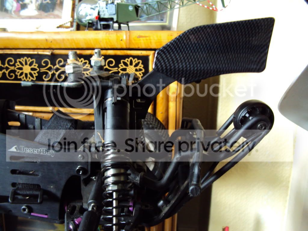

Yes the supports are damaged. NOT CUT, it was a very big jump that caused that haha
A new wheelie bar will be needed. If you get tired of soljas wheelie bar when he sends it to you... you can send it my way 🙂

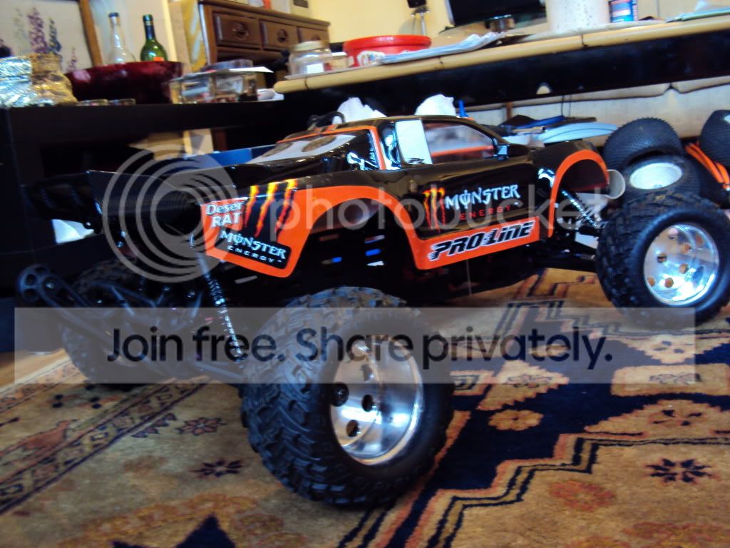

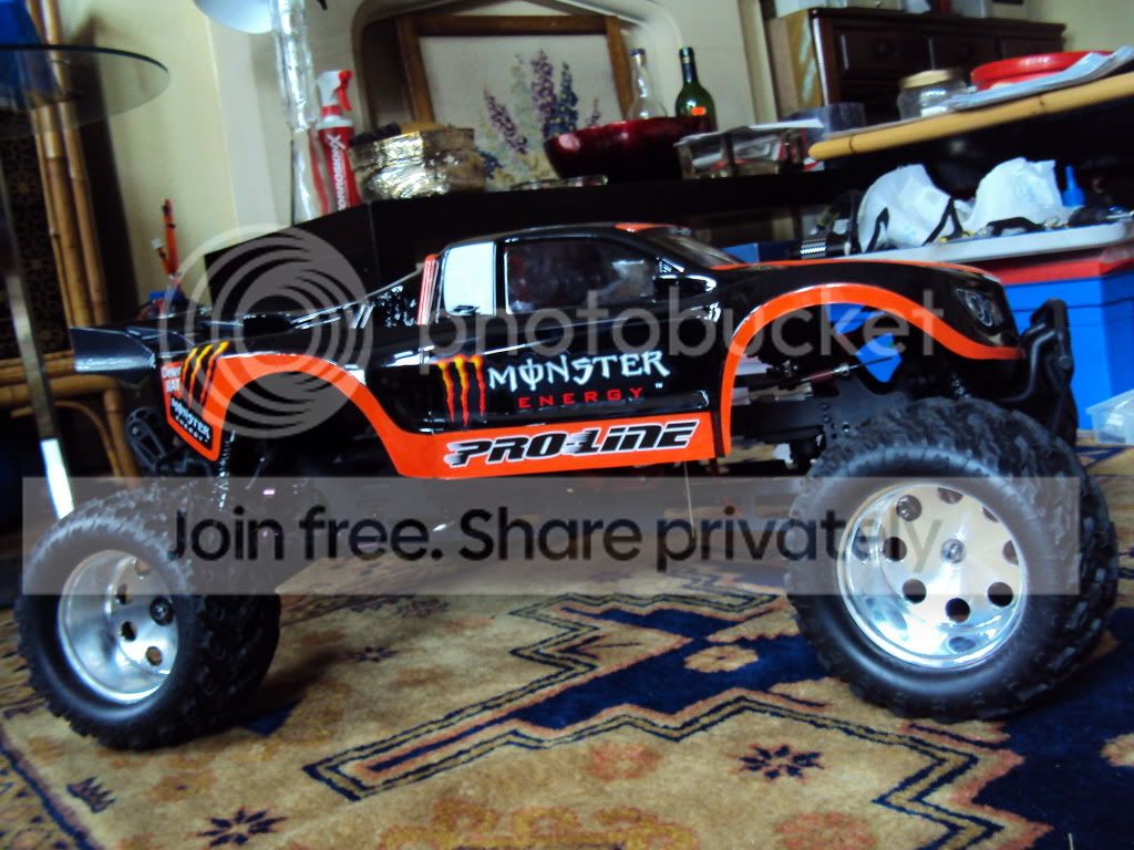

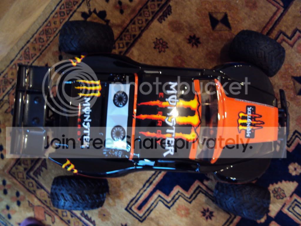

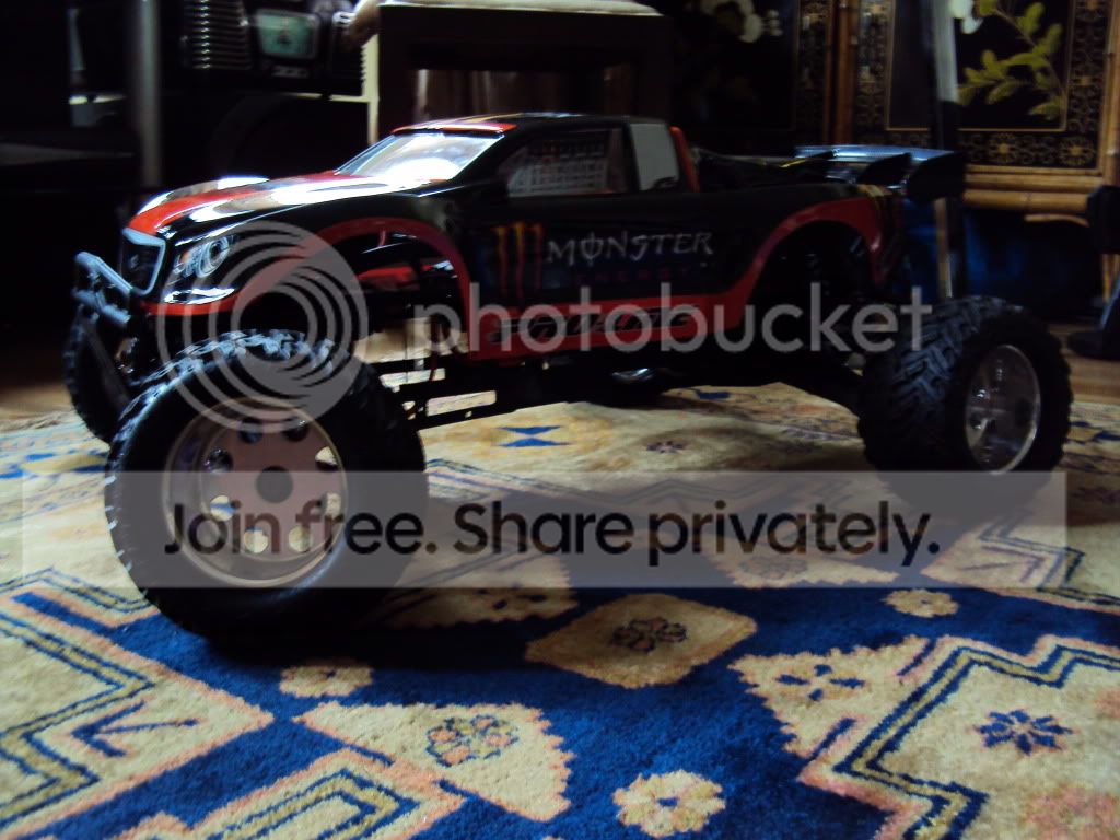

Just finished my new body... Its a desert rat for a slayer...
For my first every paint job, i am very happy. I went overboard with the monster energy stickers but I'm loving it and i doubt the condition will look this good after the first run
here you go.... Pictures arent great but you get the idea....
What do you think???
wow, I love it ! Make that the queen lol jk jk.
