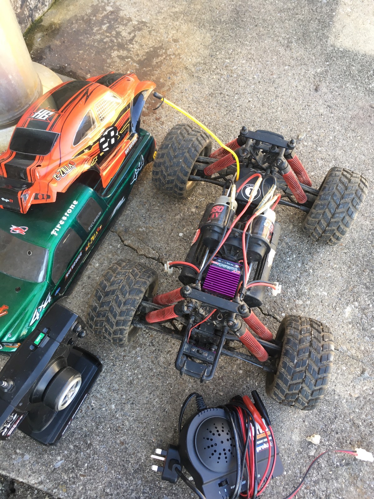

Hi can anyone help me, can I use LiPo battery's with this speed controller?
