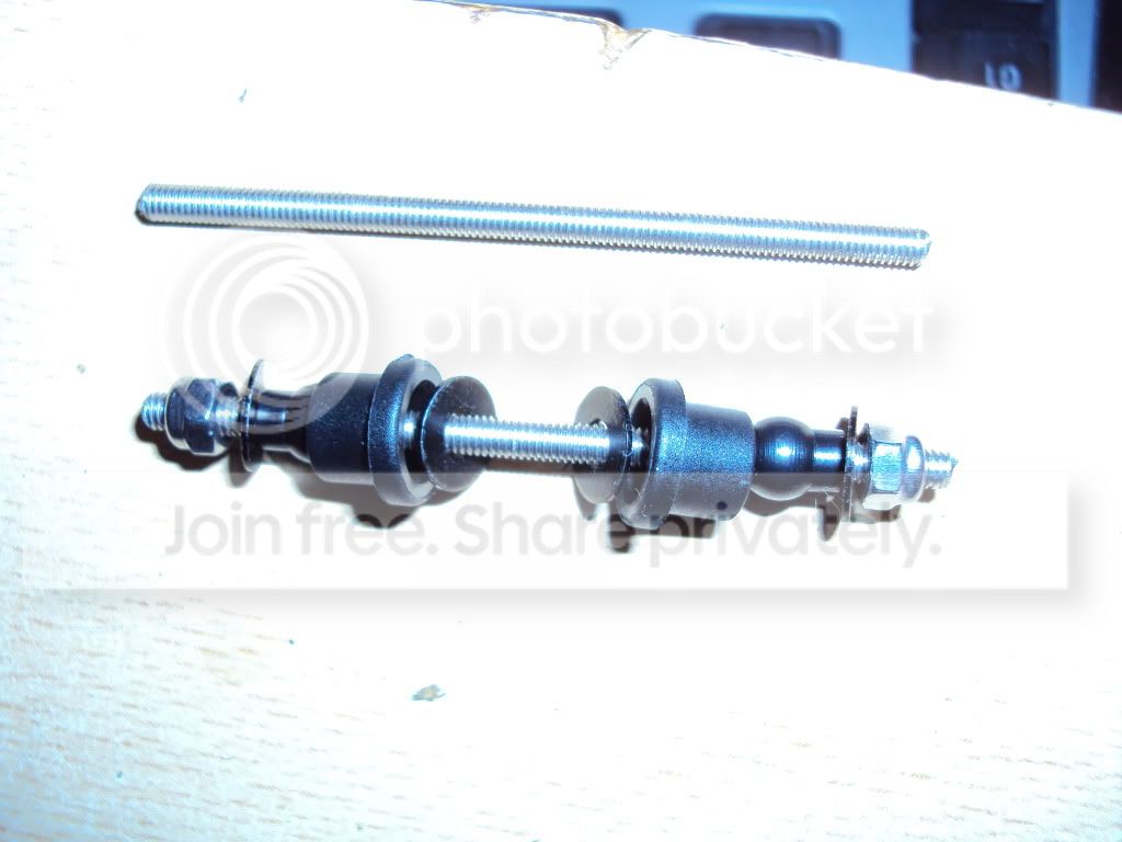

I'll move onto the installation now, which isn't all that difficult, but cannot be done with the parts that come with your truck, or the parts that come with your shocks, if it can, I was not able to figure out how, as the proper setup of these shocks are four, one on each corner, the mounting bar that goes through the shock tower is the same length as the stock version, and therefore, about 3mm-4mm too short to be used with an 8-Big Bore setup, before I purchased these shocks, I took alot of measurements and looked at alot of pictures to see whether eight would fit, and clear all moving parts, after finally deciding that they would, I went ahead and bought them, after you have constructed your shocks, and filled them with oil, which I will show a guide of how to do at the end, you will of course want to install them, now I had some real trouble getting the bottom swivels into the A-arms, it was just like one wasn't made for the other, after some "gentle persuasion" they finally popped into place, now you can use the standard cross head screw, or you can use the 2.5mm allen-head screw that came with your Big Bores, I personally used the 2.5mm allen-head screws, then you want to install the upper sections of the shocks, for this, you will need an M3 threaded bar, the length of about 60mm, you can make them down to about 55mm, but this makes it awkward to tighten both nuts at the ends, I found a very good little store in England that sold these parts online, the website can be found at the end of my review, how you setup the top section of your shocks is personal perference, but this is how I setup mine:

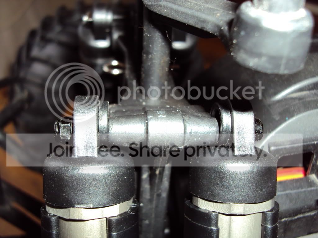

Note: The rear four shocks will clear all moving parts, even at full shock travel, the front two shocks, at the farthest part of the truck, will also clear all moving parts, but the two shocks closest to the steering turn buckles, will rub ever so slightly at some positions of shock travel, I've not yet found a way to remedy this, but in all honesty, the contact is very little, so I might decide to just leave it how it is.
