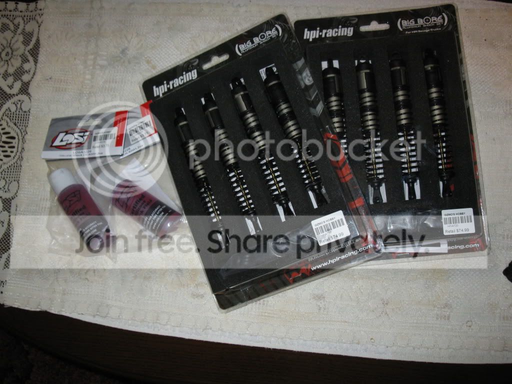

My big bore shocks arrived today.

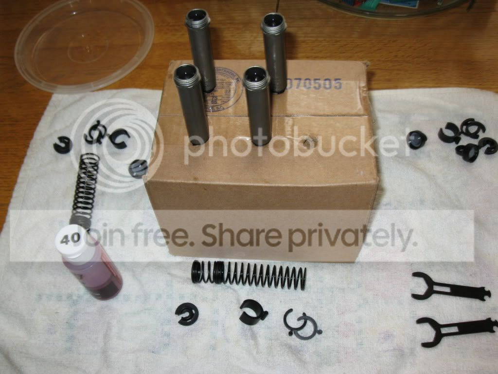

make some type of rig so my shocks can stand upright for a long period and let them bleed overnight.
+1 frddy.. If you don't have one of them modified you can always cut some holes in a shoe box and use it..Thats what i did the frist time i did my BB's.
Thanks SavyScott. I thought of that this morning.
I call this the poor mans Shock Box.:hardlaugh:

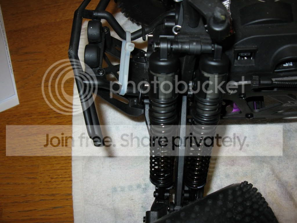

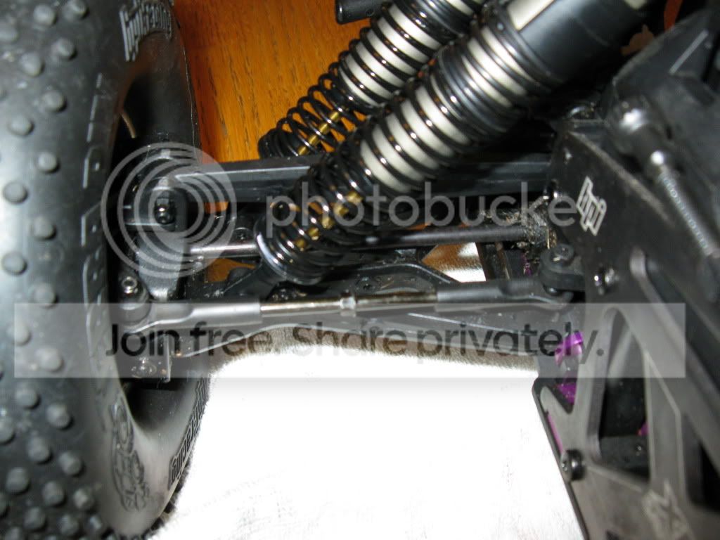

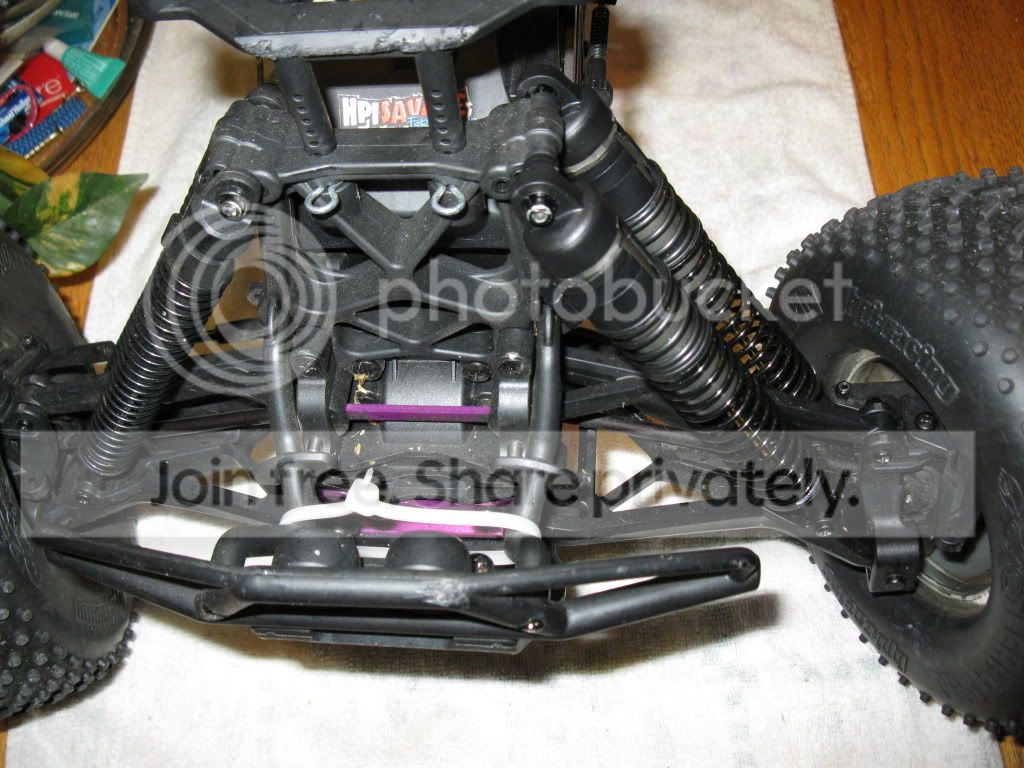

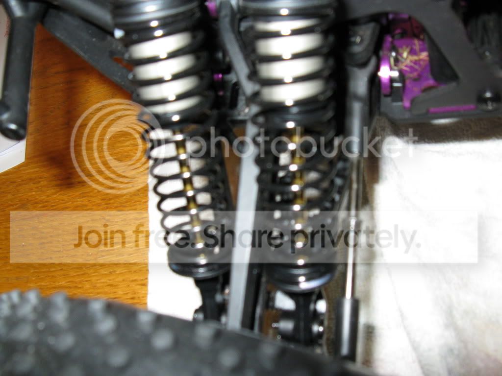

I started installing the 8 big bore shocks today and so far the only problem ive ran into today is the Cap Head Screws for the upper shock tower eye is too short as seen in the pic below.
The shocks clear all moving parts on the steering and Suspension.
The reason the shock on the right is leaning to the left is because it dosent have the spacers on them.

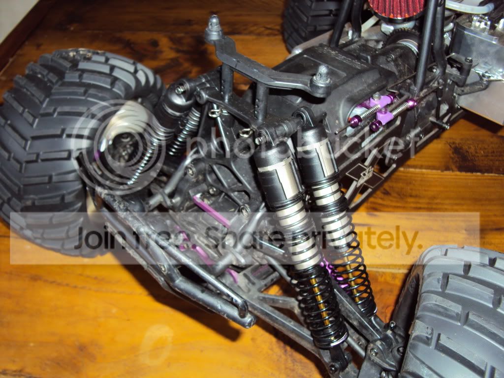

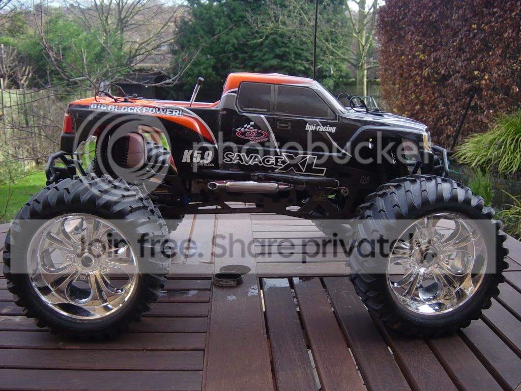

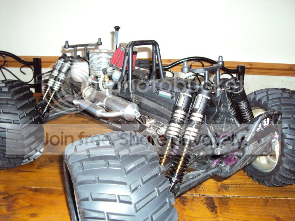

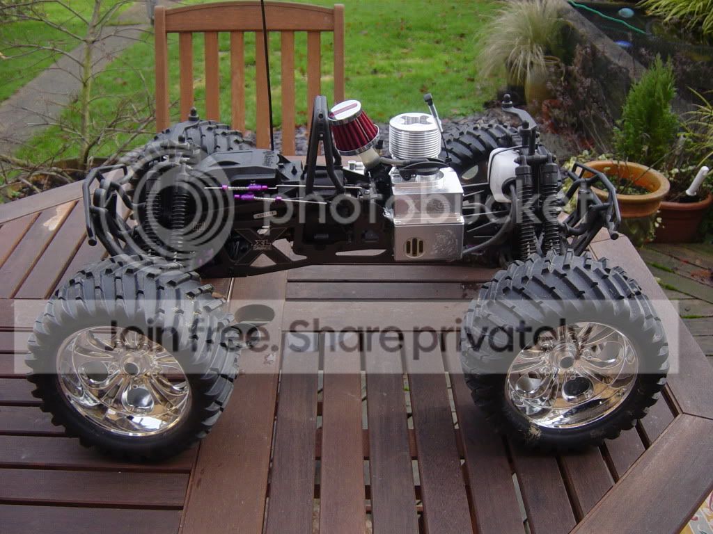

A friend of mine from the U.K and i are working on a custom build for the 8 big bore shocks.
He has orderd a 1000mm M3 bar and M3 Nyloc nuts and is cutting them at his machine shop to custom fit the xls.
He is then going to send what i need to install my shocks.
Here is some pics of his xl.
