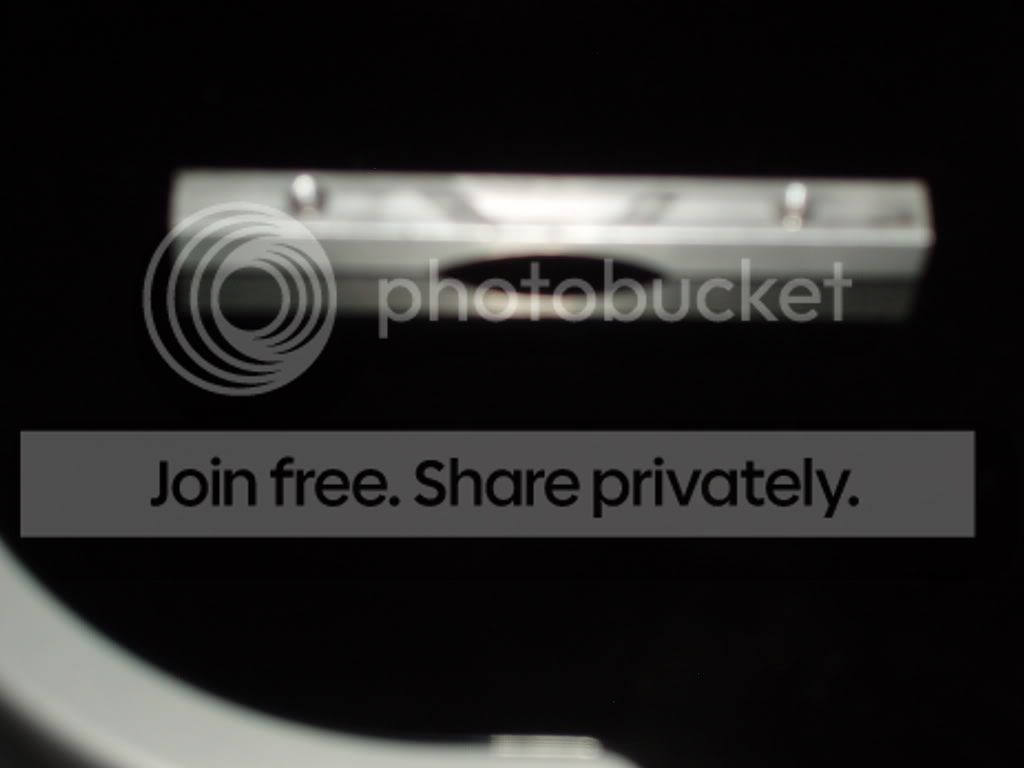

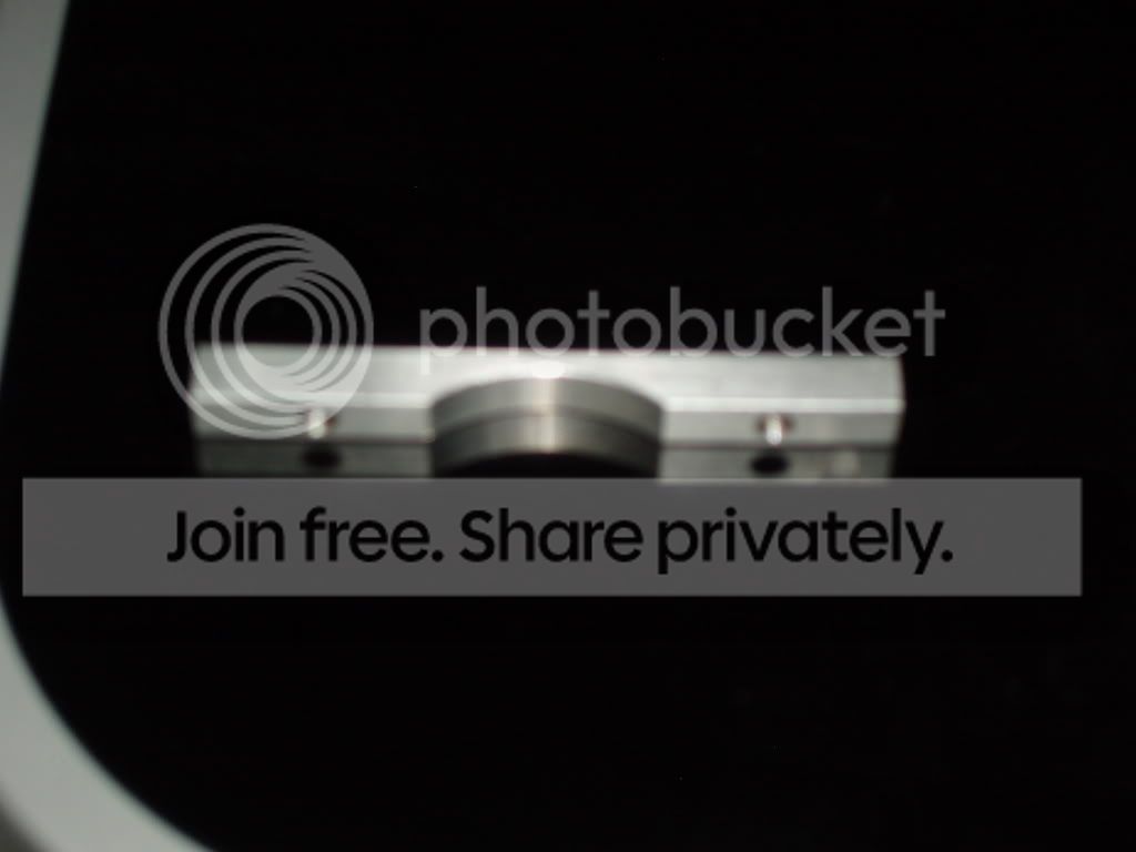

it took me awhile but i found what was being a pain in the ***. it was the front aluminum bracket where you screw the engine plate in to. so i am goin to shim or sand down the top of it till it works. thx again to all of you that helped me out.
****Srry for the big and blurry pics****
here are some pics of the bracket:
