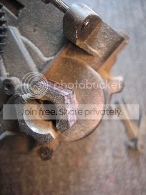

Pads on steel brakes isnt really an issue. You just don't use pads. Steel on steel with a mod like the one shown below does the trick and brakes just as good as fiber discs but does so also when soaking wet.
However, I did eventually move to fiber brakes because the steel discs are too thin. They wobble around on the hex and can get unalligned which will have the same effect as hitting the brakes slightly - this does also happen with the stock mount.
Give me steel discs as thick as fiber ones and I'd use them.

I fixed my brakes the other day. I used Gani's idea but did it without the mod. If you have an extra set of steel shoes laying around all you need to do is add one of them to the setup. It is almost 2 times the thickness of the shoes. So I added it in and left out the shoes. It works like a charm. At first it grabbed way to hard but if you can adjust your radio and teach your finger not to brake like a hammer you can get some great performance out of it.

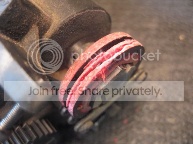

For those who are runnin metal on metal brakes, there is a draw back to that set-up. Trust me, I know cuz I've already tried it. Alot of people think that stainless steel is really strong and durable, but it actually isn't as strong as you think. Believe it or not, the steel "calipers" on the brake set-up will eventualy wear down the stainless disks. Then, once they start gettin worn out, that's when they start wearin out the "calipers". Like I said at the begining of this post, they will both wear out and you'll be back to the same situation again. So, to save time, just switch over the the dual red fibers and be done with it. Then, when those go, give the PRC replacements a shot. I haven't tried them yet, but possibly will down the road when I need new disks.
xtemsavage, I don't doubt a word you say. I've even got the dual red fibers on hand. But guess what I found out. They aren't a straight swap if you are using steel disks. So I had to do something quick. I'm going to find out how long they last. If you would, could you let us know when your Fiber disks give up the ghost? Would be interesting to see the difference in durability.
Pike, if I remember correctly, when I ran the SS disks on metal "pads", they only lasted 1/2-3/4 of a gallon. I can't remember exactly how long they lasted, but it wasn't that long. The red fibers I'm runnin now only have one tank (250cc) through them and so far work and stop the truck just as good as the SS brakes. But, I've also got a skid plate to help protect everything under there.

I also have run the SS breaks and they lasted roughly a gallon not even..
I got the red fiber ones last year and they have lasted about 4-5 gallons, i just noticed mine exploded because i have the center skid plate and the disc hit that LOL
how is that possible? I would guess a small pebble or rock or something got in through the TVPs. Unless the skid plate got pushed into the disk to cause that.

I just noticed mine exploded because i have the center skid plate and the disc hit that LOL
Yeah i got a nice ding in my skid plate. The plate is like 3mm from the breaks and literally touching the trans ..

I inspected my stainless brake set after running 4-5 tanks threw them. I don't see any wear yet.
I did have to turn the brake pressure down to about 25% on my rx from 60% where I was with stock single brake pad setup.
These brakes are brutal, easily flips the truck when applied to hard.
Crash, are you still using them? How are they looking, feeling?
