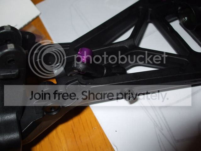

Finished the suspension stuff. Mostly. Turns out the sway bars are supposed to mount to a hole in the arms that doesn't exist. Can anybody point me to a pic of the arms with the hole so I know where I should be drilling?
It's not much, but here's a pic of what I got done today:
Thanks. I'll give it a shot.
