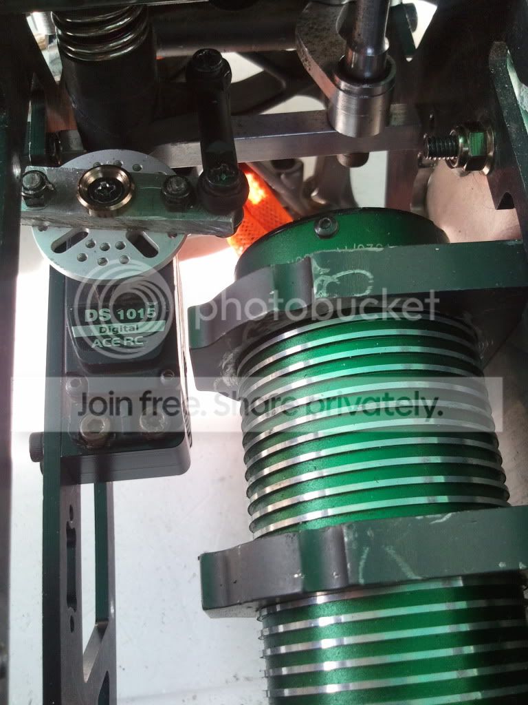

Got the motor and mount from GCM a few days ago and finally had some time to mess with it yesterday. Ran into a snag though. Originally I couldn't get the pinion to mesh with the spur because the mount hit the servo. I shaved down the end of the mount as far as I could without ruining it, and managed to get the gears to mesh. Now the servo horn gets hung up on the motor itself. I'm thinking a smaller horn might fit better, but not sure if it will fully actuate the steering linkage - as if the turning radius wasn't bad enough already. Looks like a lot more fiddling is needed.
Yep the problems you are running too a normal... the chassis was only designed to work with stock parts...
I had problems with the motor hitting the servo, and then the servo arm hitting the motor...
I made a custom servo horn which was the perfect length to give maximum throw whilst clearing the motor... Plus it is extremely strong and doesnt bend/strip like other arms i have used...
Not the prettiest thing but works very well... made from 4mm alloy! Overkill! but thats how i like it 🙂
At one point before i did my centre diff conversion. I had my servo mounted on the outside of the TVPs so it could fit!!!
it worked really well with a longer servo horn.
Keep on working on it, and you will get it all to work...
Outside the TVPs... I'll have to give that a shot. Certainly can't grind down the motor itself for more clearance. Should have thought twice before going with a motor the size of a beer can.
Yea it is a minor hitch i guess... I'm not the only person that has had to mount the servo on the outside of the tvps...
Luckily the tvps allow you to mount the lipos in the rear, otherwise the servo and LiPo boxes wouldnt be able to both fit on the outside 😉
