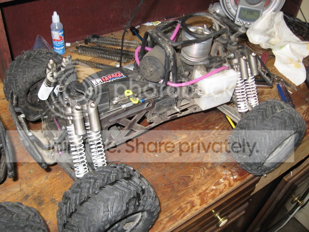

On ebay I found 8 cen shocks for 34 bucks shipped ... gotta say they are way nicer then the stock savage shocks .. Just bolted on no problems at all .. Will be doing some serious bash testing on these .. Will let you guys know how they hold up ...
Shocks mounted ..

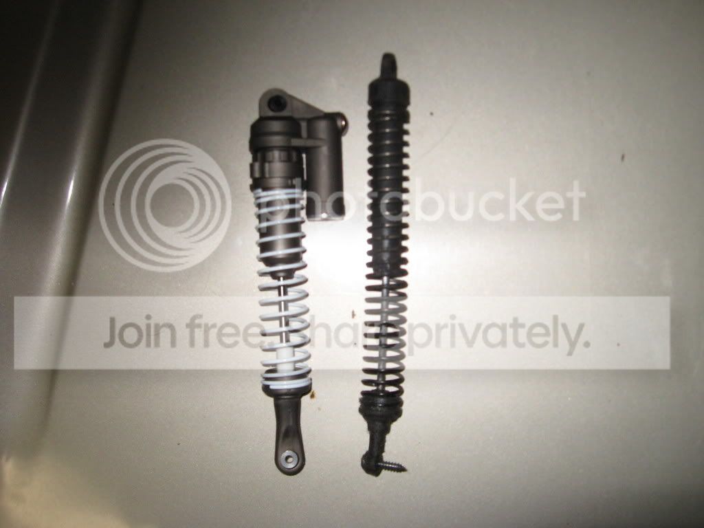

Side by Side comparison..

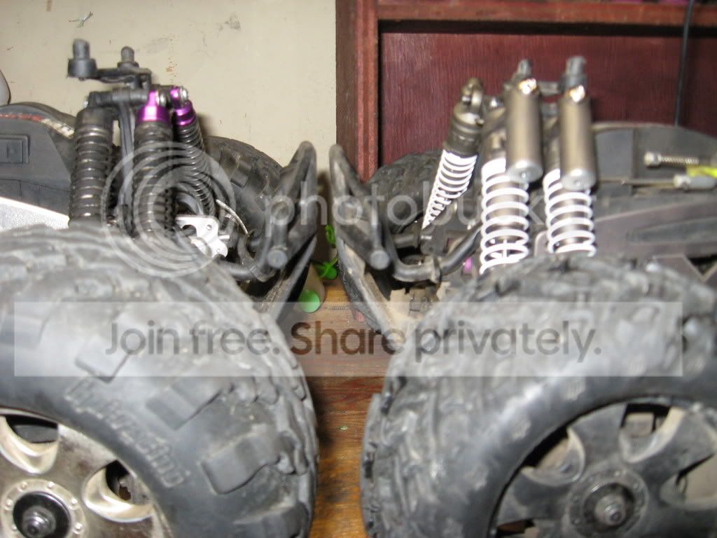

Ride height difference..(if any) .. Note running a lower profile tire w/ the cen shocks .. still they are the same in ride hight

no modifications whatsoever required...you will lose a small amount of ride height is all...unless you make some sort of bracket to raise it back up slightly...but they will, in fact, bolt straight on...

Little to no mod required, better than stock, and I am assuming fairly light in comparison to the LST shocks......hmmmm. I may have to look into these aswell. Are they aluminum bodied? forgive me for not doing my own homework on these.
No they are plastic bodys. The only issue I had with mine was if I ran the resevoir on the outside, if the shock gets hit hard enough from the side the shock cap will get cocked sideways and loose all the fluid. I turned them to the inside and all was well.
