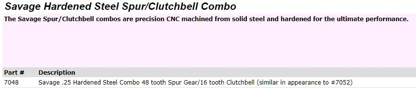

If you don't want to spend the money for the gen 3 slipper, many find the 48/16 combo to be perfect.
Both spur and clutch bell for less than the price of the gen 3 slipper.
