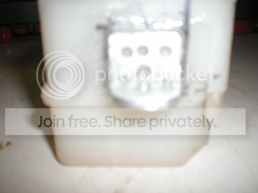

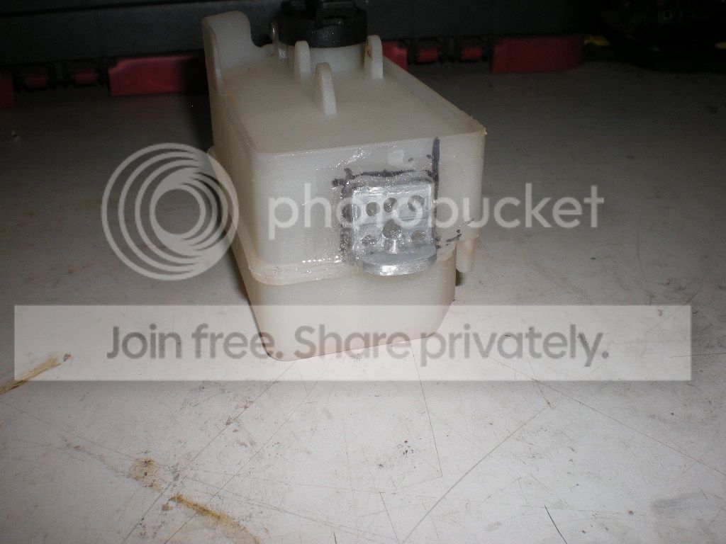

A couple years ago I had a brain fart and piled my MMT into a concrete lite surround and tore off the whole left front and in that process I also destroyed the tank mounting hole and split the tank a bit, I made a new mount and repaired the split with Plumbers Goop and attached the new mount boss and so far it holds up fine
I swear by that GOOP, solid repairs and strong as when new...
