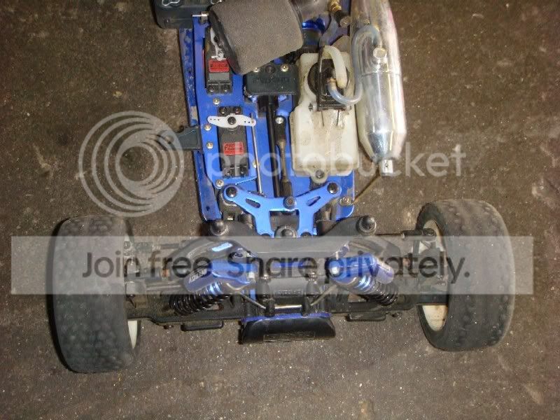

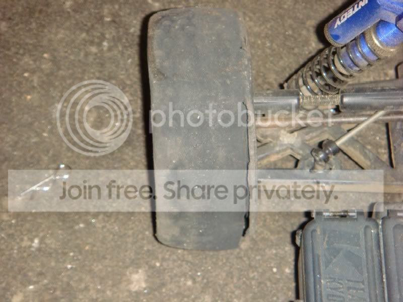

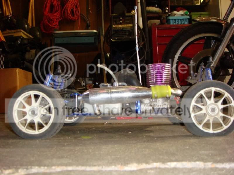

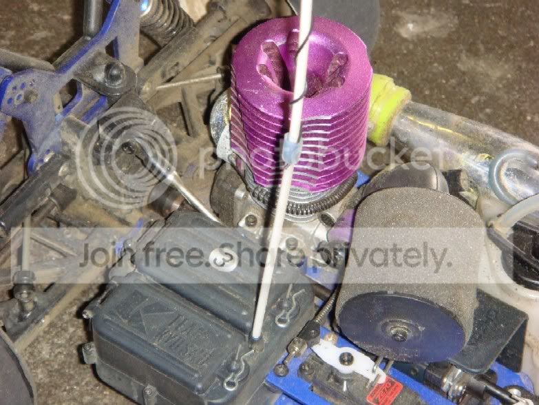

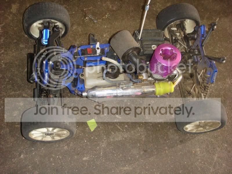

OK took some pics of the k4.6 powered Inferno. I resized the pics to 800 x 600, I hope they are small enough, if not I will resize them again.
The tires are completely useless right now. I went to the closest HS to get new rims and tires but no luck. I will get some before the weekend to take some vids for you guys.
OMG, those are the baldest tires I have ever seen on a 1/8th scale buggy. That is hillarious!

What are those, slicks? lol. Your upgrades sound pretty exciting.
There slicks now...roasted for sure...lol. So whats the top speed on that thing?
I have no clue. I haven't been able to get it up to top speed yet, all it does is roast off the stock Inferno rubber.

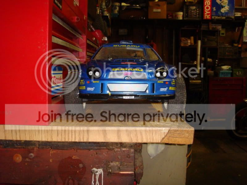

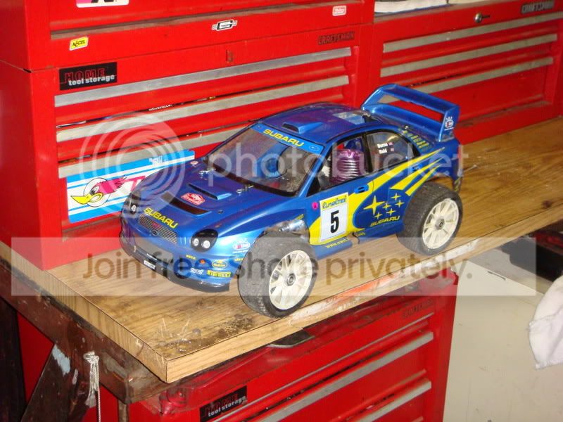

I did some searching on the dreaded devil, Ebay. I scored a Kyosho Impreza Rally, basically it is an Inferno missing all of the really good race parts, for $50.00 shipped :FarleyParty:
Sounds silly but it is hard as hell to find an 1/8th scale Subaru body. I plan on frankenstiening the rest of the Kyosho Rally. I may make my oun frame and use the diffs and spare Savage arm's I have laying around to do something crazy with.

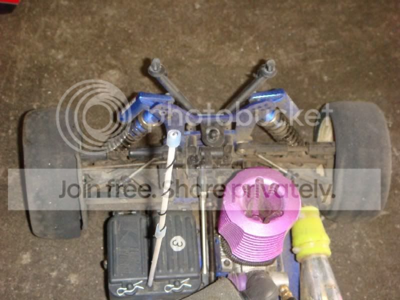

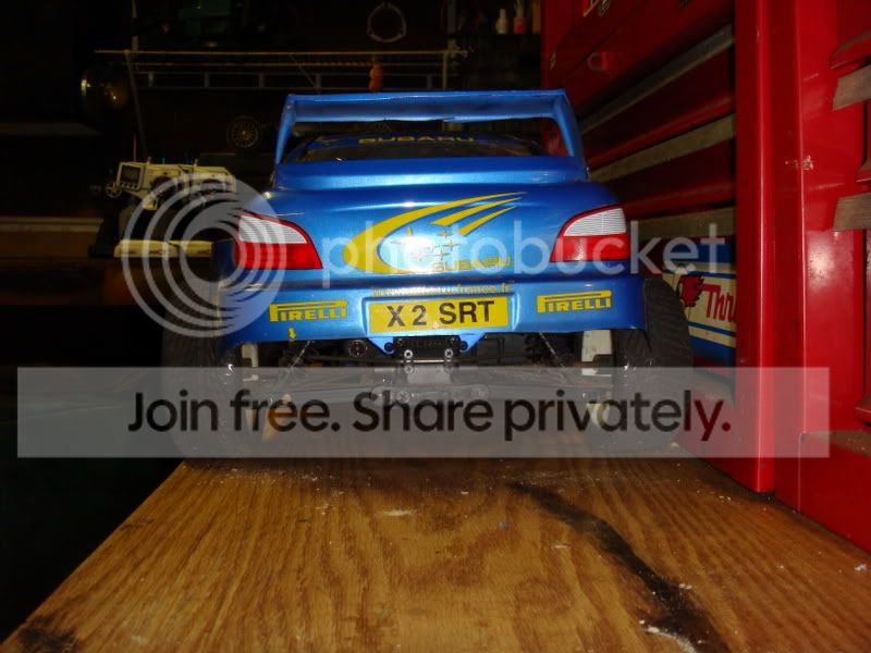

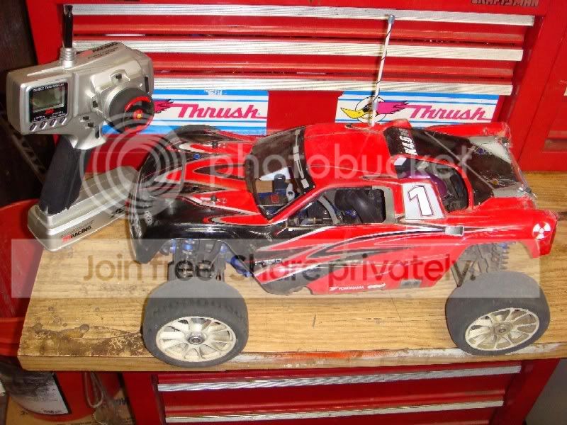

Here are some pics of the now STI Inferno.
Still powered by the mighty K4.6.
It looks like a huge Zip-Zap, I kinda like it. The huge wheels make it look like it came from some rally anime or something.
$50 bones ...Huh. You robbed the guy....lol. Yea, The cam idea is abit hairball, but it sure be nice to be able to take your own vids while driving. Having someone else shoot your greatest dirving is a hit or miss, situation. They turn away at the wrong time, forget to turn it on, run out of tape or memory, and not know the difference, oooops! the lense cap...lol I just think it's got potential.
