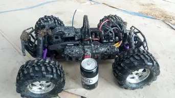

Yours doesn't have a receiver box? Mine came with this. It's not completely waterproof, but it's fine for driving through puddles and wet grass. You also want to get a waterproof ESC. The stock blur esc is not waterproof. I went with a Mamba Monster 2 and have been happy with it so far.

I abuse the absolute hell out of my truck using that stock box, haven't had any issues with the radio getting wet. Rain, slushy snow, wet grass, sloppy mud, puddles 4-6" deep, nothing has gotten to the rx yet.
If you're really worried, you could stick the rx in a balloon for extra water resistance. Other than that, I don't think I've come across any other receiver boxes for our trucks.
Unless you plan on driving directly into the drink and playing the boat game,a savage will sink like a lead weight. i would think that the stock box is pretty water tight unless you have drilled a bunch of holes through it for wiring
i just put a new box on mine. i made plates to cover the open area where the throttle servo went. i drilled a small enough hole through the into the reciever and didnt do any drilling on the cover so the connectors would barely slide through and i used ATv to seal around the wires.
i made a cover for the area where the on/off used to be.
I have the receiver box from a vorza buggy on my savage, Part#103674. It is appx. 2
" x 1.5" x 3/4. There is also HPI #106960 and HPI #108261. Both of those are smaller but waterproof.
Yeah I toasted my receiver in a ditch,maybe 8 " water. Lost control went throu ditch. It ran great for a bit,shut in off, then would not start. I think I shorted out receiver(water in prongs)..oh well replaced receiver.
