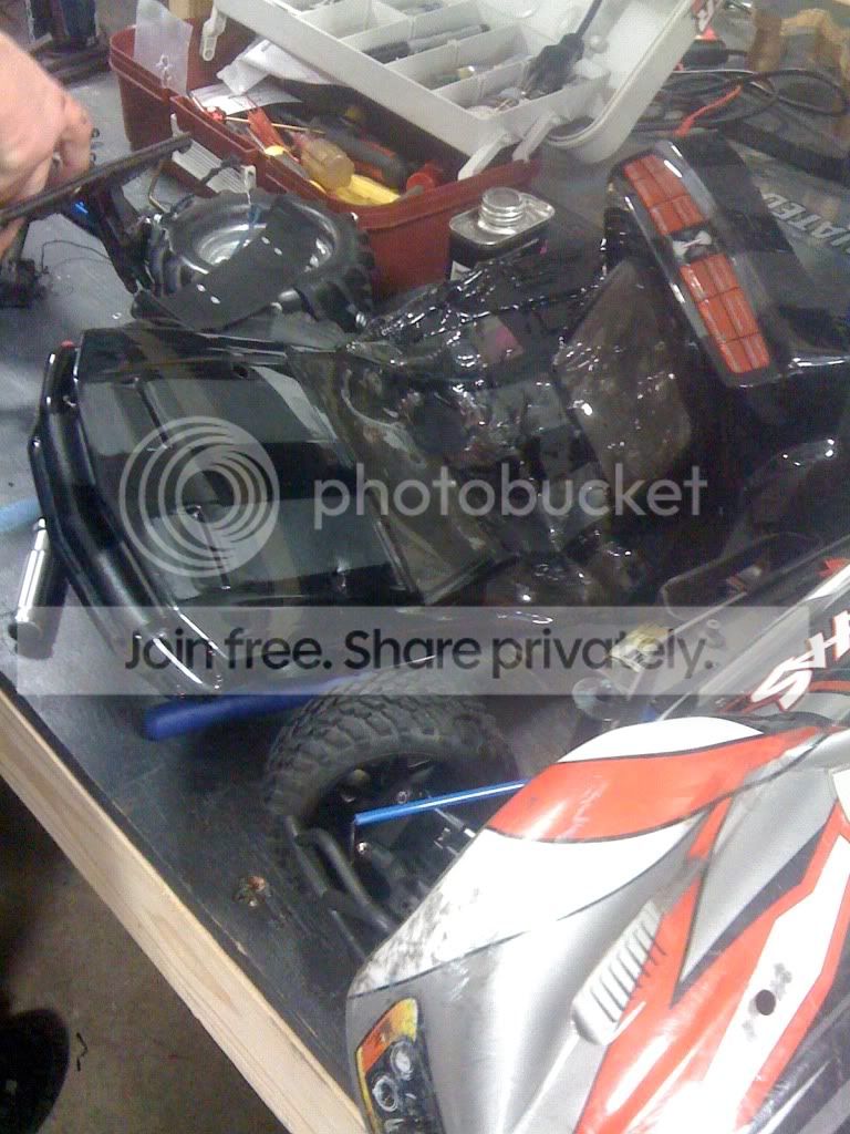

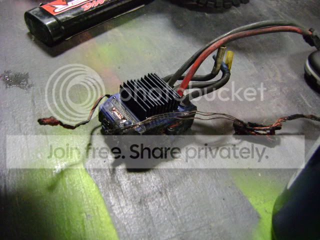

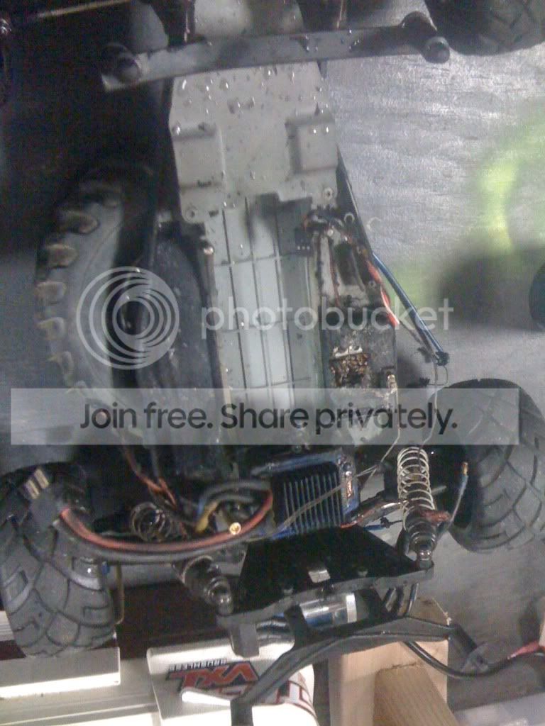

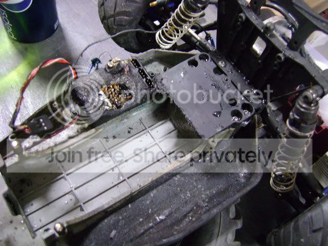

this is what happens when a battery manufacture puts the wrong label on the battery and the lhs doesnt notice... and sells to a newb that doesn't know better
The battery used in the truck was sold as a 2s 5200 venom LiPo... SO that's what the kid thought he was getting, he charged her up and proceeded to race.... half way thru all you see is a huge smoke cloud coming from his truck, he quickly grabs it and starts running outside with it when half way to the doof POOF a 2ft fire ball ingulfs the kids hand.... he then gets it outside and throws snow on it to put the flames out.
he left the battery outside for a few hrs incase something else would happen, well after about 3 hrs he went and got it i looked at it and to my surprise there were actually 3 cells in the pack.... this WAS NOT AT 2S battery!!! the kid was charging it as a 2s battery funny thing is the balance lead on the pack was also for a 2s pack...
since he was only charging 2 cells during the second race of the night that 3rd cell went under voltage and went up in smoke....
just goes to show you, make sure you know exactly what you are buying and have in your hands before you even turn that charger on... these battery's are very dangerous in the wrong hands, however do a little research/reading and just be carefull with them and you will have a set of reliable batterys.

ok so i got the real story behind this thing.
it was in fact a 4cell battery (one was completely obliterated) they were ran in parallel so it would double the MAH but keep it at a 2s battery voltage.
so i guess in the end it was just a freak thing, but the kid contacted venom and they might be helping the kid out a little on a new truck etc, they are just waiting on the reply back.
CS gave the case to someone higher up in authority considering the circumstances of where this happened.
ill know more next friday whether they are going to give him any compensation.
Slight mistake there Baddasz. They were run in parallel, 2S2P.
Methinks the kid got a defective (duh) pack where one of the paralleled cells wasn't matched properly. A dude I know has links to a batt manufacturer in China. According to his contacts, out of 100 cells made, maybe only 2-3 are matched well enough for reliable use in parallel packs.
When you charge a parallel pack, you have no control over whether or not the cells in parallel charge up at the same rate or not. You could potentially end up with one cell at 8.2V and the other at 8.6 if you get a dud. 8.6V = POP!...
Point is.. If you MUST run parallel, run 2 seperate series packs with external parallel wiring so you can balance each cell. In a flux you could run say 4S or 5S each side and change the ESC harness to a parallel one.
