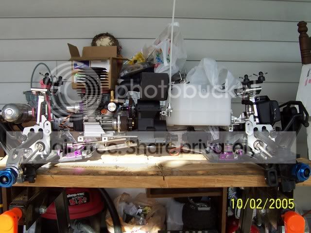

Finally took the time to upload some photos. This is what the truck looked like before deconstruction. The wheel base from front center to rear center is 14.5 inches. I haven't finished the tvp's yet so I don't know the final length.

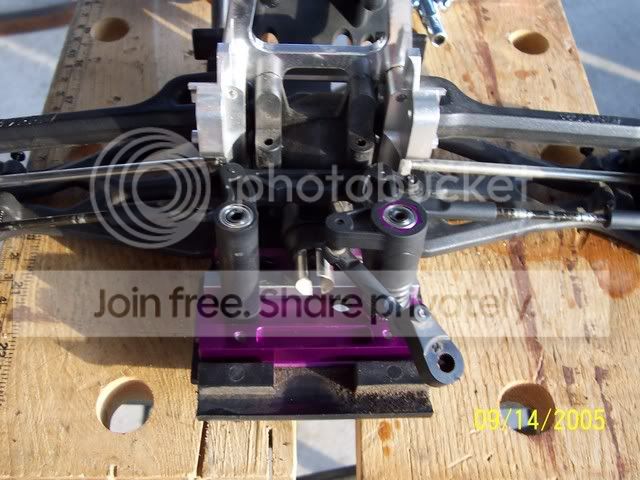

One of the front. Integy purple brace, xtra brace in front(stock motor plate brace), and ball bearing for steering servo saver.

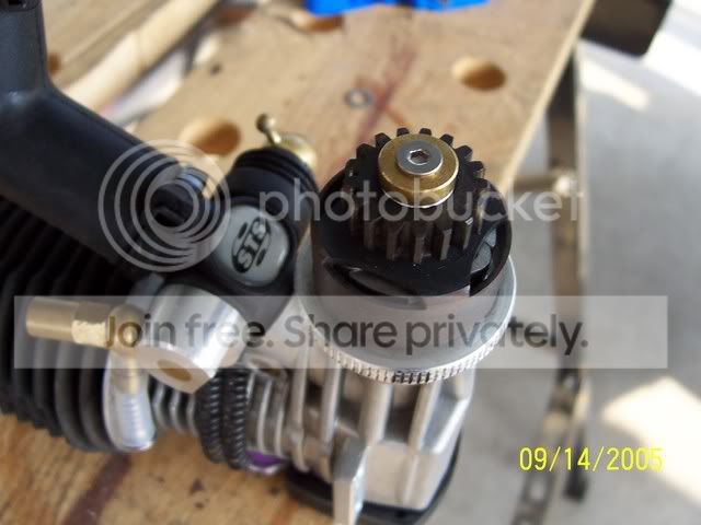

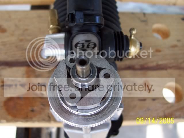

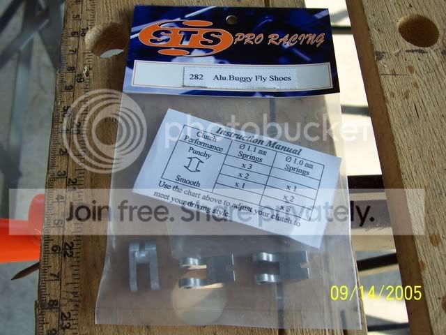

New STS alum. clutch shoes.
Clutch shoes installed. Two shoes have 1.1mm springs and the other has a 1.0mm spring.
17t Hpi racing vented clutch bell.

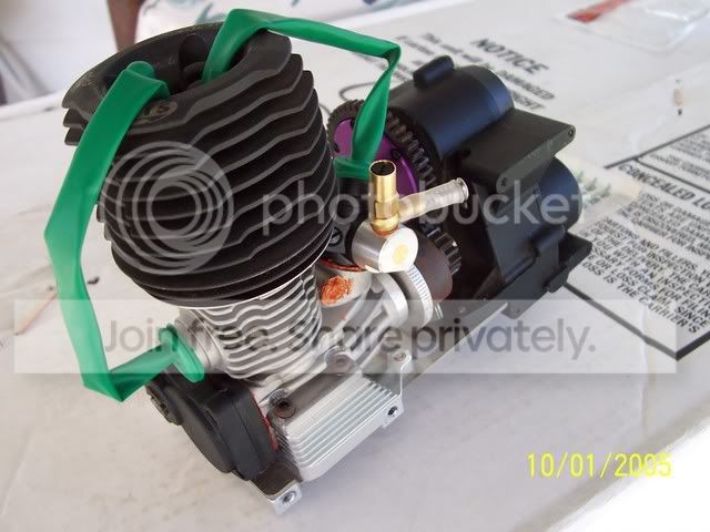

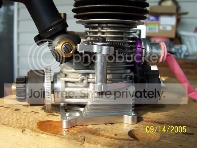

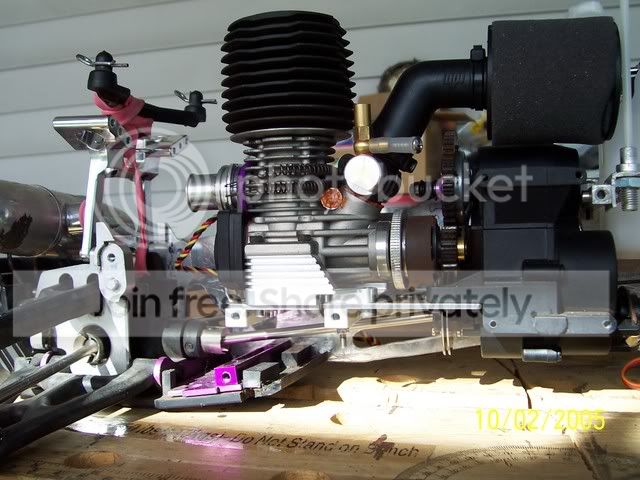

And this should look familar. STS linkage mod and Hot Racing motor mount.

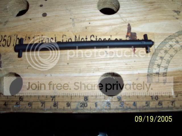

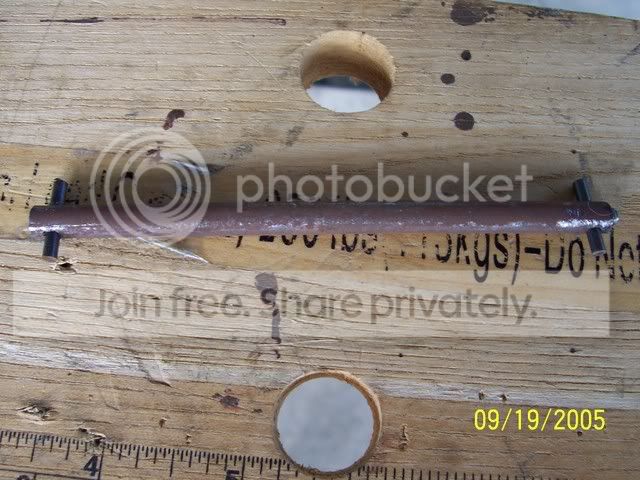

These are the only two pics I have right now. This is what took me almost all day Sunday to get made right to fit.
Custom made dogbone. Doesn't look perfect, but it works.
Same one, just took a wire brush wheel for my angle grinder to it and painted it black. Should help with rust for a little while.

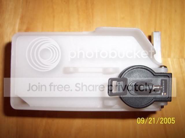

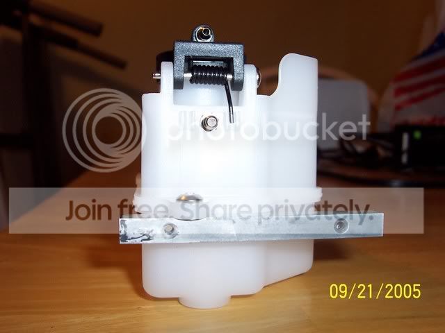

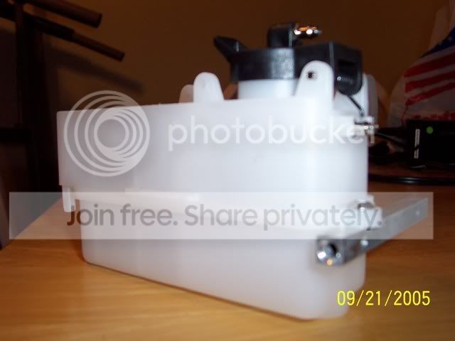

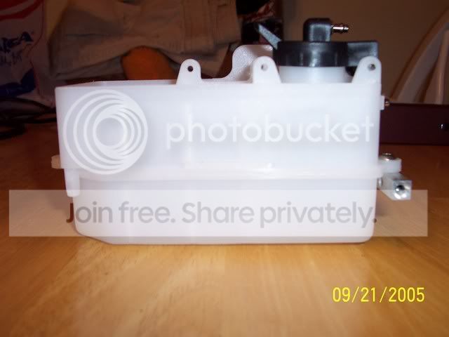

Ok everyone. Here's some pics of the tank I'm using. I'll let you guys guess the size and what it is from. And Jt, you know the answer, so you can't answer.

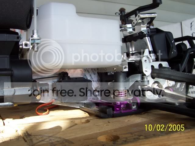

Here's new pic for everyone. This is all I have left to do is mount and protect the Rx. This is how much room I have left, and you'll see why it's taking so long. Plus, haven't worked on it for a couple days.

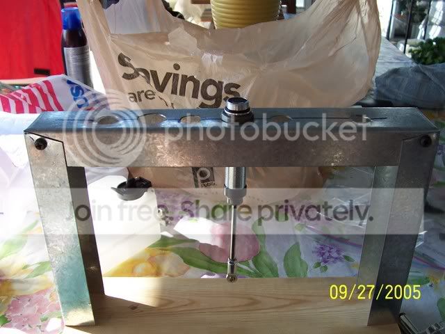

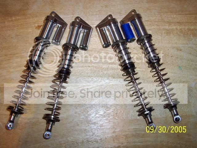

working on the truck again today. Decided to take a couple pics of the Integy MSR8 shocks while being filled with oil. Filling with 40wt. shock oil and using the 3 hole pistons. Also, pics show the stand I made at work to fill the shock. Makes it alot easier to fill instead of holding it the whole time.
Got a couple more photos of the finished Integy MSR8's. Filled with 40wt. oil and using the 3 hole pistons. Also alot of preload for may taste of driving style.
i like the stand you made bud that looks like it works great ! you also are doing a good job on your proj it is good to see another savey being turned into frankenstien ! good luck on the rest and keep us posted bud !

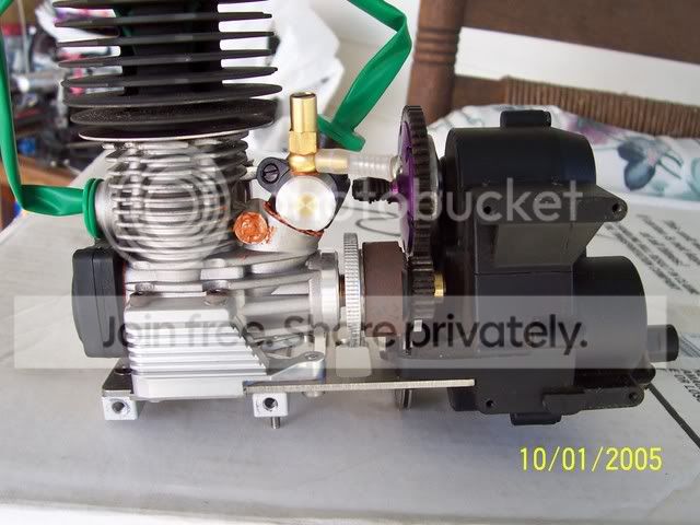

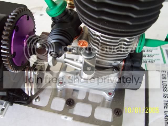

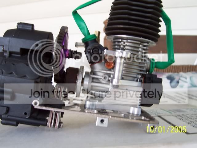

Well, I haven't got that much more done yet. All I've gotten done since yesterday and earlier today is finished sealing the motor (which thank you everyone on the site for the advice on doing that) and getting it mounted to the motor plate. Gears are messed perfect and tom. I can finish assembly. Okay, now for the good stuff. And by that i mean the parts I've upgraded to. The tranny is still the same, easy access diff from savage x and 3-speed with reverse. The motor plate is new and that's the HardCore Racing titanium motor plate. And the rest was mentioned in a earlier post.

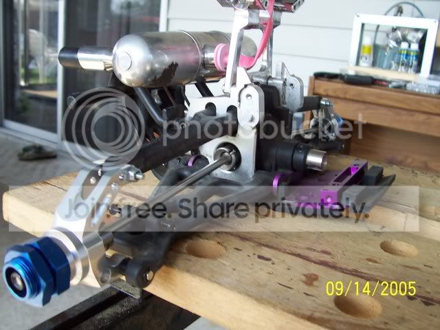

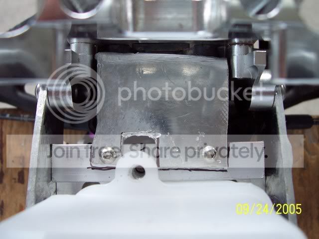

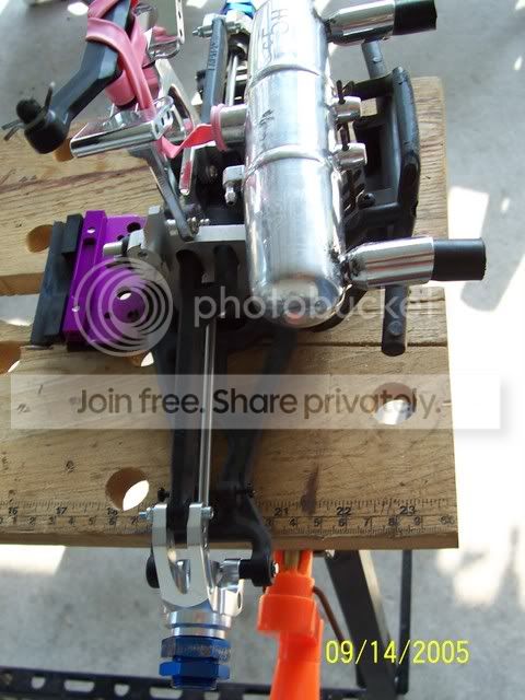

more photos for everyone. these are pics of the inside looking at the left tvp. everything is mounted, servos, tank, dogbones,motor, and tranny.
close up of the front
close up of the rear
