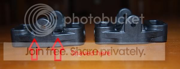

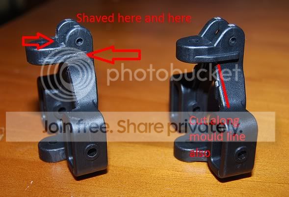

Shave the off plastic in all the places I point to
-Top of the knuckles
-Shave both sides of the carriers.
-Next shave both sides of the knuckles.
Once the plastic is shaved off you will have a better turning radius and your savage will feel like a different truck. Compare your stock carriers and knuckles to my modded ones and you will see the difference. This is an easy effective mod that will make a big difference in the handling of your truck.

martin34
134
Silly question time but i noticed that the knuckles are different to my xl ones.Do i do the same to my xl ones as in your pics?
Pope
3,442
Columbus Ohio
yep yours looks diffrent because his pics are all post mod. His looked just like yours before he started.
ryan86
Savage Basher
175
Sydney
My xl knuckles look different too. I don't think it will matter, but yeah, they are slightly different. One difference is, If you look at the outter bearing on fx's knuckles, above and below it there is 2 supports:
.O <---- Outter bearing
On my xl there is 4 either side.
\ll/
/ll\
Would have taken a pic but no camera with me. Probably makes no difference with the mod but yeah martin, they are different

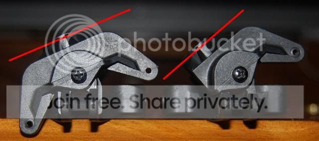

There are some more tabs on the xl knuckles that need to be taken off. When i get home from night shift i will take a pic or 2
ryan86
Savage Basher
175
Sydney
Sorry, i meant the carriers, the xl carriers are a little different aswell. Only one or two extras tabs to be cut. Pic later
ryan86
Savage Basher
175
Sydney
Here are the pics of my knuckles and carriers. Just a bit of extra shaving. I guess they did this to make them stronger but they only get in the way with this mod
ryan86
Savage Basher
175
Sydney
Forgot to mention that you still need to shave where fx said these are just extra spots for newer style knuckles. I just looked and saw where needed to be shaved,

Ive been working on this mod on my XL for a little while now.
Did the stuff on the first page a couple hours ago, put it all back together then viewed the second page and saw the trim instructions for the newer parts.
