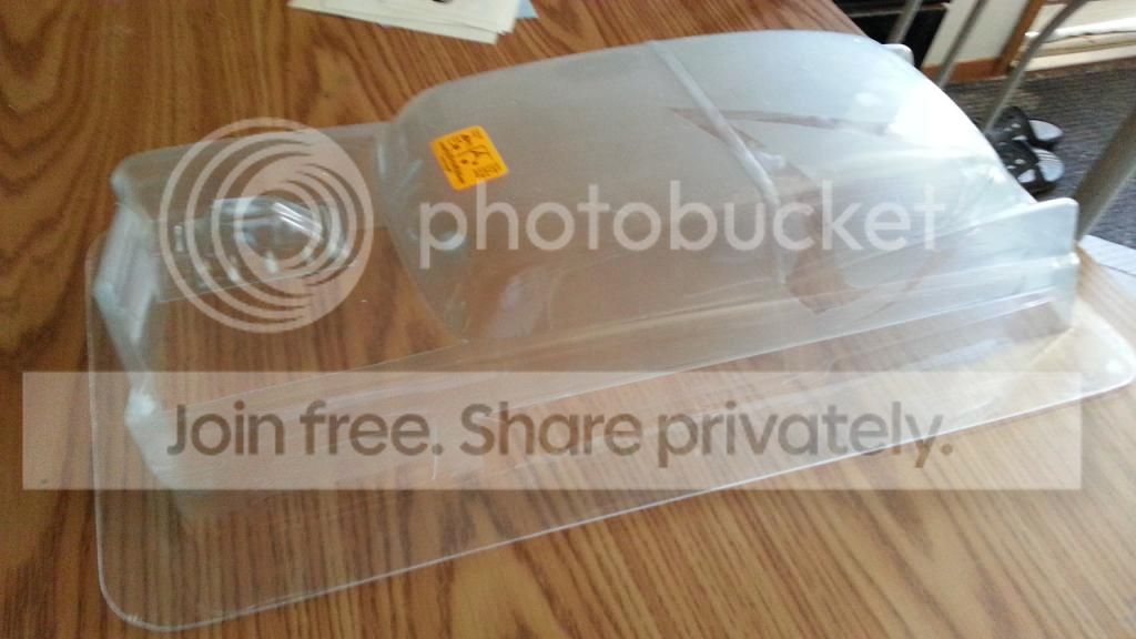

This is the HPI Racing's late 50's Grave Robber hearse. I had originally planned do a sharpie-art paint job but I changed my mind and going a different route.
All the supplies
The usual reamer and body scissors, hobby knife, liquid mask, paint brushes, masking line tape, shoe goo (gotta get drywall tape yet), body decal sheets (not using all of them) and the paint.

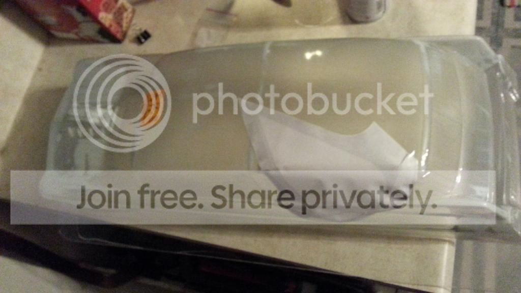

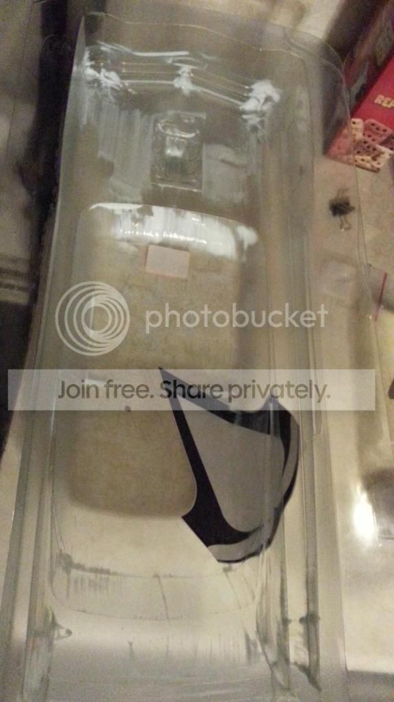

4th and final coat of liquid mask applied and drying. This body has no shortage of detail...lots of nooks and cranny spots. I taped the stencil of the AC logo where I wanted it on the outside and will cut it out of the mask tomorrow morning and get the flake and black laid down. Before you ask.....no, I do not use window masks. I can never get the edges clean enough. Liquid mask, very sharp hobby knife (I actually use a brand new one for every paint job) and a steady hand works best for me.
Outside
Inside

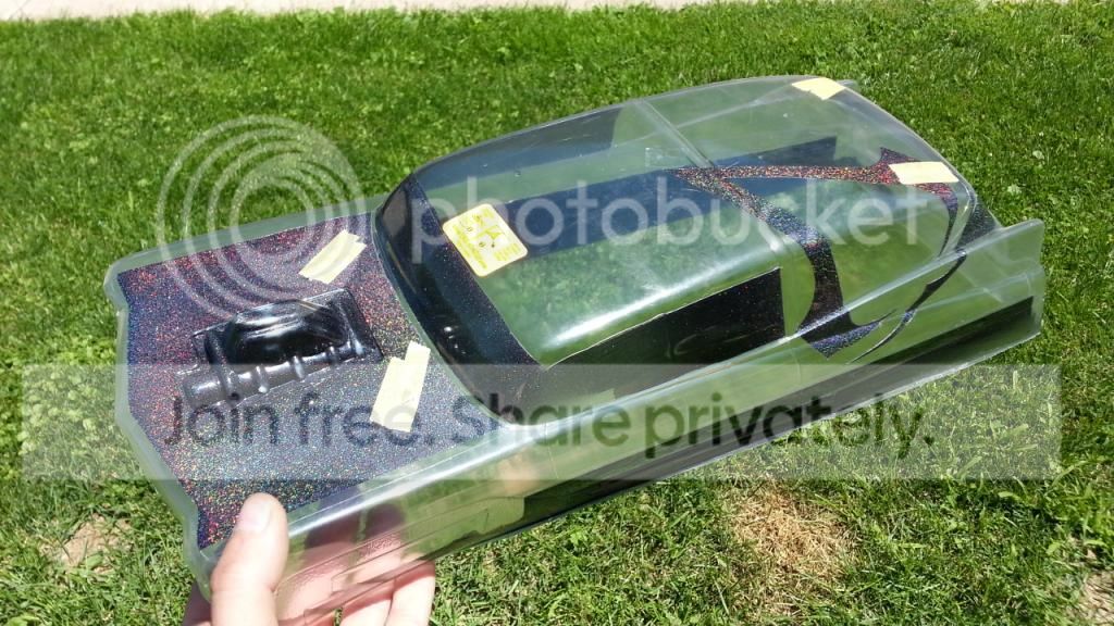

EDIT: Hour or so later I got bottom half, the hood (last minute decision), and the AC3 logo unmasked and sprayed the first light coat of metal flake on. It doesn't show up in a picture very well so I will wait to post a picture when I have some color behind it. Now I am flipping back and forth if I wanna go red on top or a deep blue. Both have always been a favorite color combo. What to do what do?!

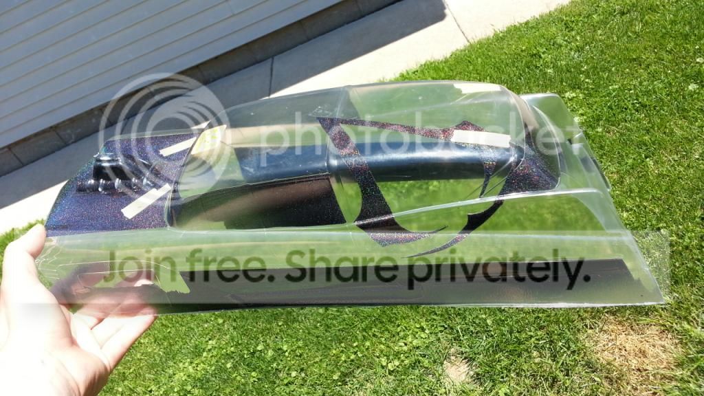

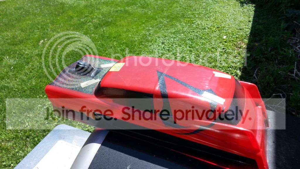

Here is a picture of the first layer of mask trimmed out. I shot that layer with the Tamiya Lame Flake clear, as mentioned I skipped the picture because it didn't show up.

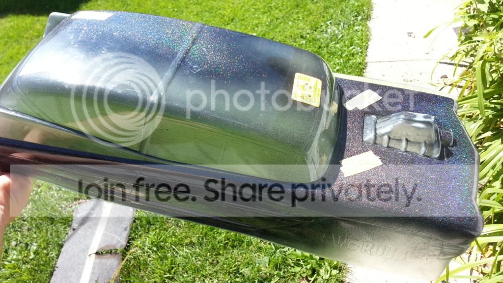

This next picture is the first color layer with the Duratrax (formerly Pactra) basic black. Took it in the sunlight. Really makes the metal flake pop.
2 more coats of the black then I will unmask the the majority of the body and hit it with the red. Yep, settled on the red. Since the blower relief is going to be silver I will pull that mask off last and just back the whole paint job with silver.

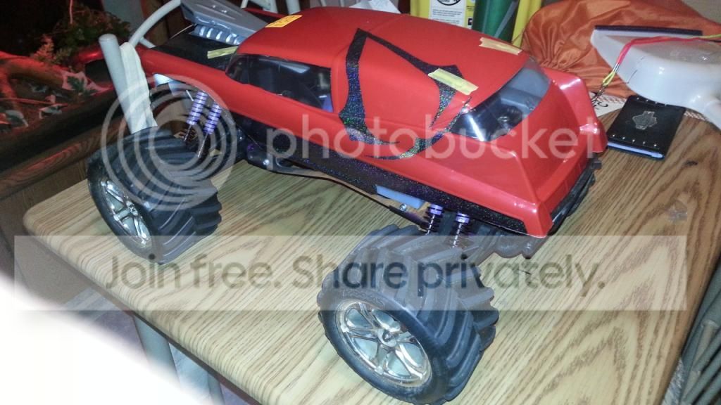

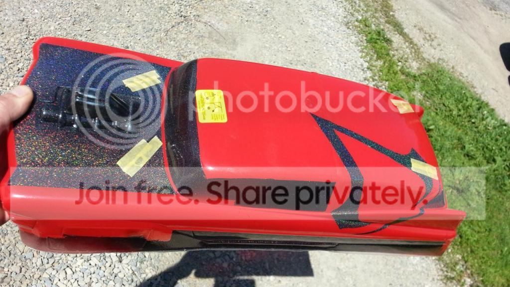

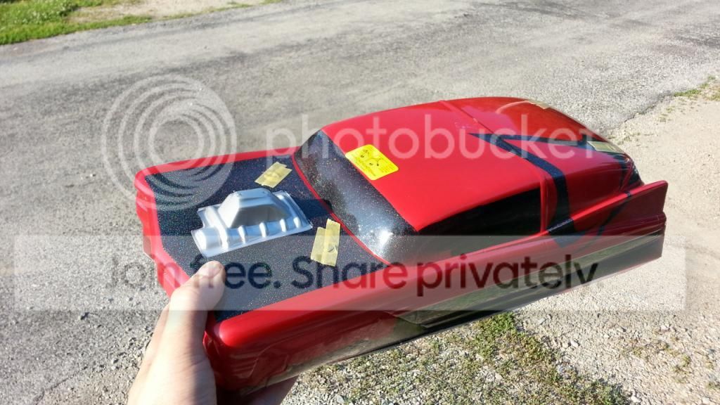

Here is the final coat of red and the silver backer all done.Paint is all laid down. I will let it dry over night then trim it all up and decal in the morning.

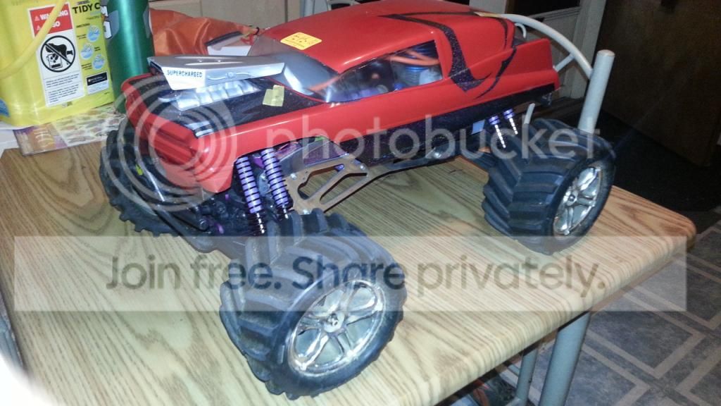

One side trimmed out and mocked it up on the truck. Still have to do the window tint, finish trimming, and put on decals,raise the rear body mounts, and pull off the overspray film. Now I realize I am going to have to do something about the purple stuff the previous owner did to it.

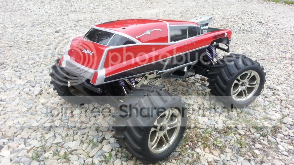

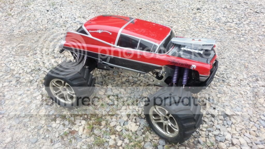

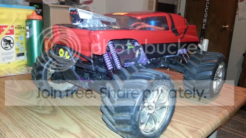

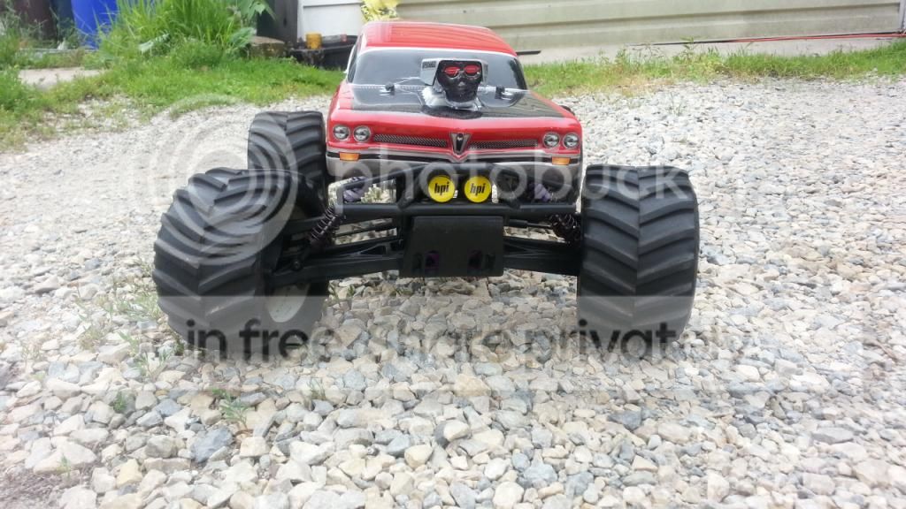

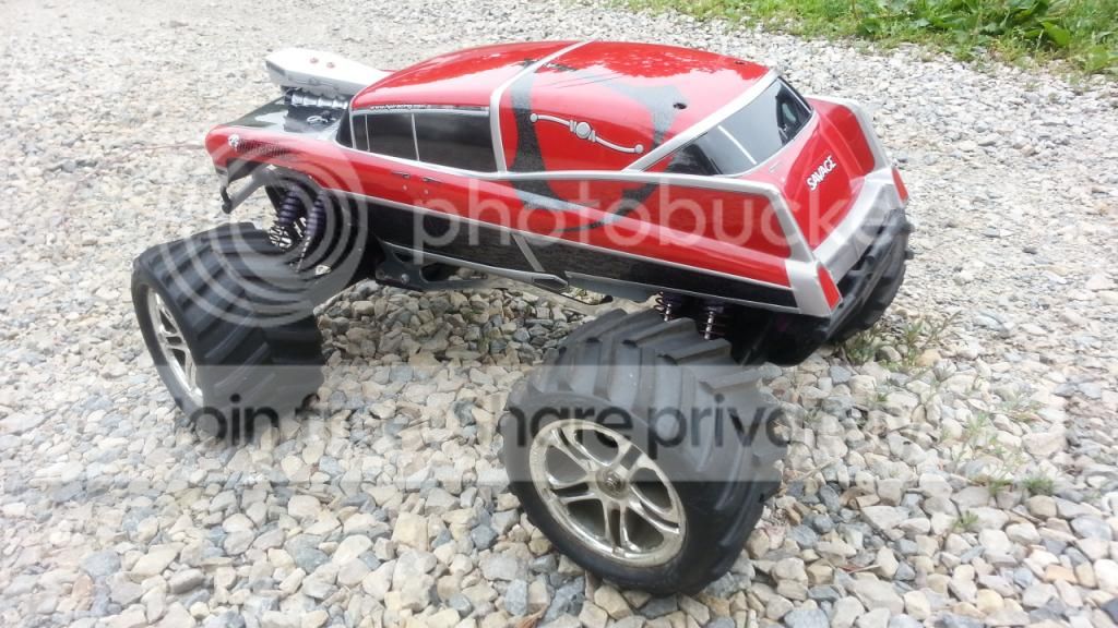

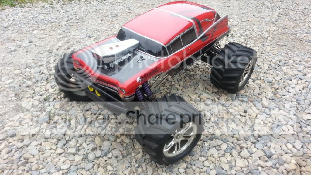

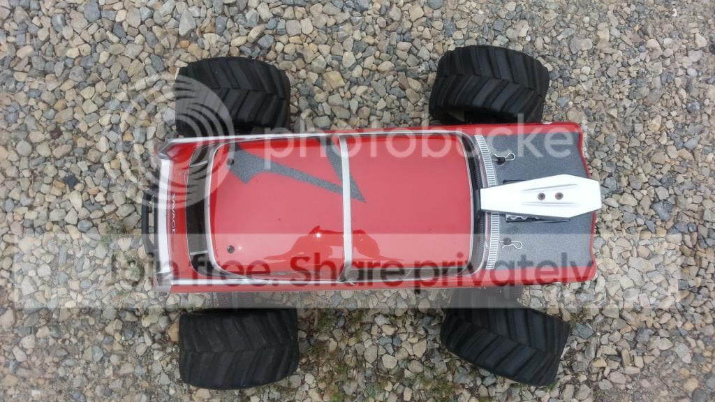

The wait is over!! Took 3 hours this morning to finish the trim out and decal application. I was waiting for the sun to come out to the best pictures but it doesn't look like it's going to happen. The Assassin's Creed motto vinyl is in the process of being cut as we speak so its not on there yet. Will be this afternoon.So, without further ado......Here is The Assassins new shell.
The rear posts are not quite tall enough to come through the body so I will either notch the rear bumper of the body to clear the truck bumper or see about some taller posts...Probably the latter. Now it time to go back into the shop and start working on the truck itself. First order of business to do a complete tear down and do something about the hideous purple stuff. That has got to go. Thinking black chrome or use Duplicolor anodizing kit and make it red.
So......what do you guys think?
Me personally, I would use the same black you used on the hood/ rocker panels. I would do taller posts instead of notching the body. I think the body could benefit greatly from a little rake. If you notch the body then it will just be dropped down further in the wrong direction.
Yep, settled on black to redo all the stuff that was painted purple. Got it all torn down and it's all been sprayed with oven cleaner to strip the purple and metal flake off. Hopefully it's all black original plastic and I can just clean it up really good. While I wait for the paint to strip I'll get the tires and rims glued up.
Noted about the posts. Taller ones it shall be. I looked around the web and most guys are raking this particular body and it looks tough.
