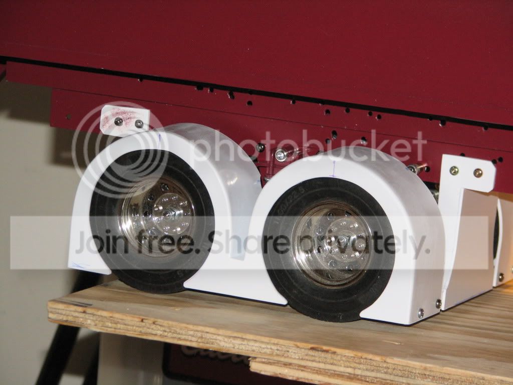

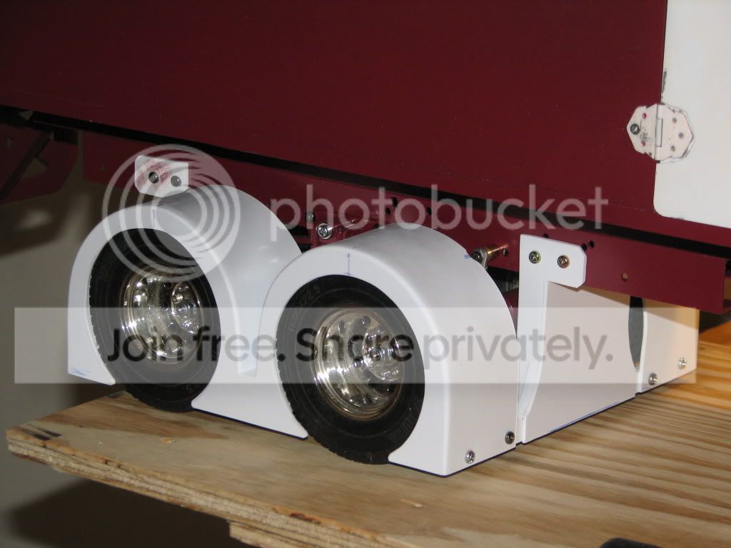

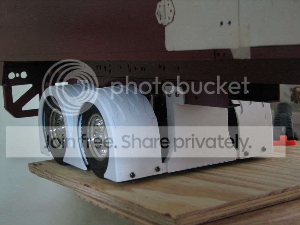

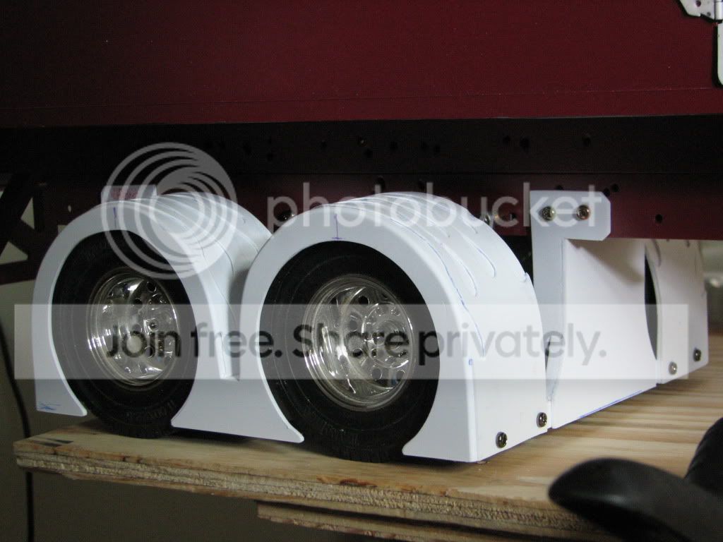

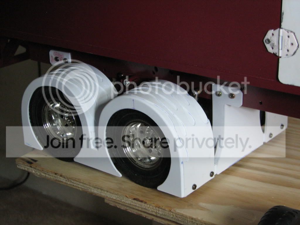

Well i think i like the end results on the fenders. They match perfectly to the truck.
Also put more of the 3D flames to match also.

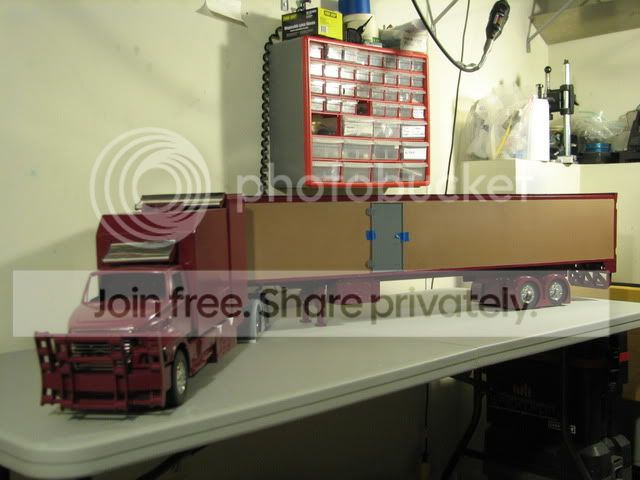

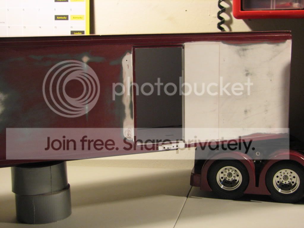

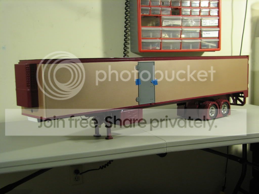

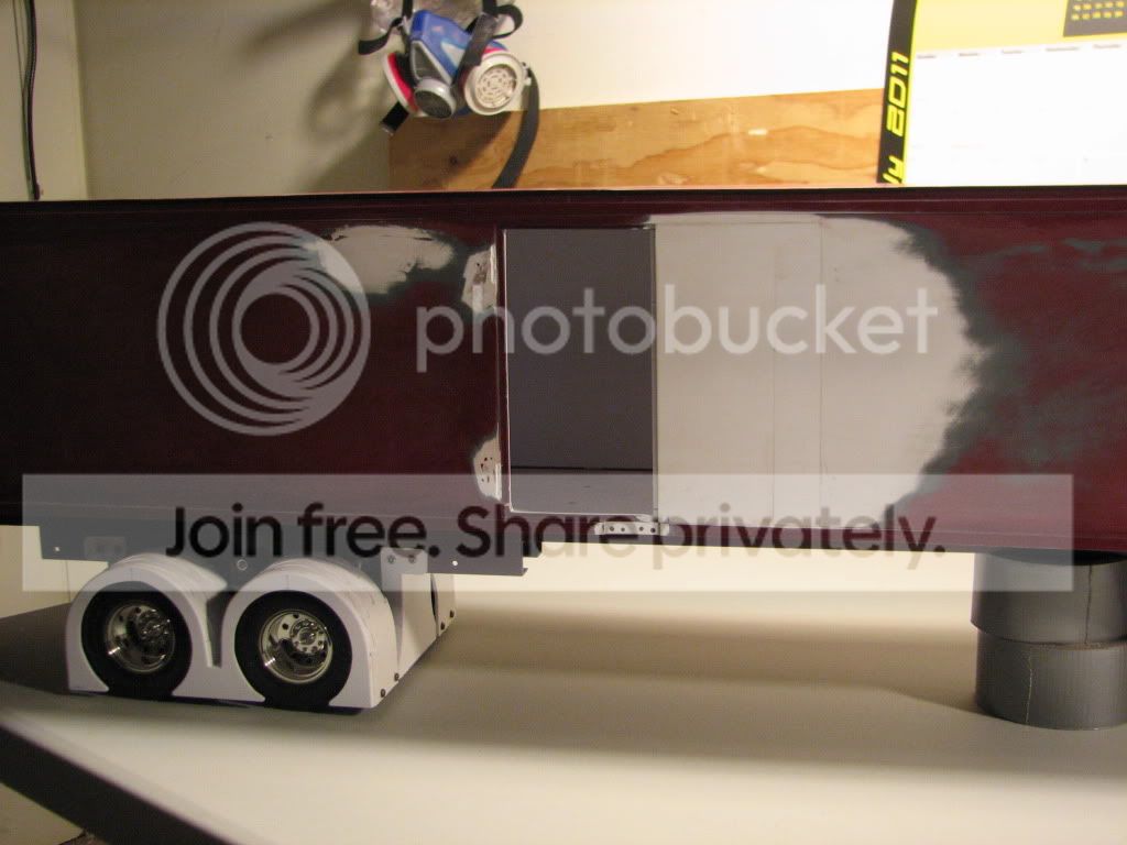

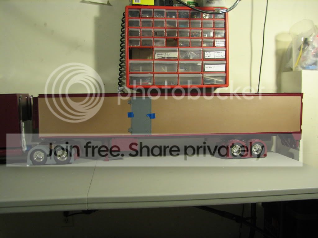

I am always doing more and more research on making this more realistic all around. I changed the trailer once more time. I took alot of steps back on this one for realistic look on the trailer. Did some body work sealed off some of the side doors to only have a one door opening like an in town delivery trailer.
On top of that i was trying to reconstruct the refrig unit and really destroyed the front of the trailer so when i fixed the front of trailer i took as the opportunity to make a better unit also i am going to build it so i can put the leg batteries in side. Along with access to them.

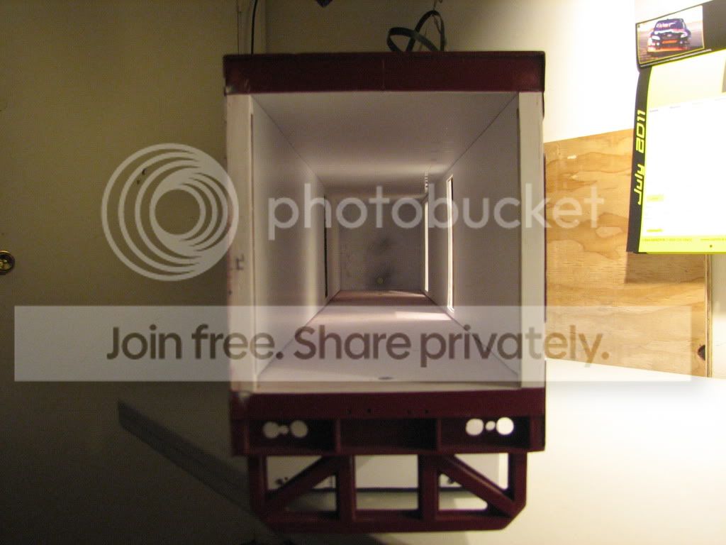

When i was doing all of this reconstructing to the outside i thought i could not leave the inside alone so i am building all the walls the front of the inside and i am making the floor so it can be removed to get the wires. It is adding some weight back that i tried to take off the truck but i have not really ended up with the final motor combo for it.

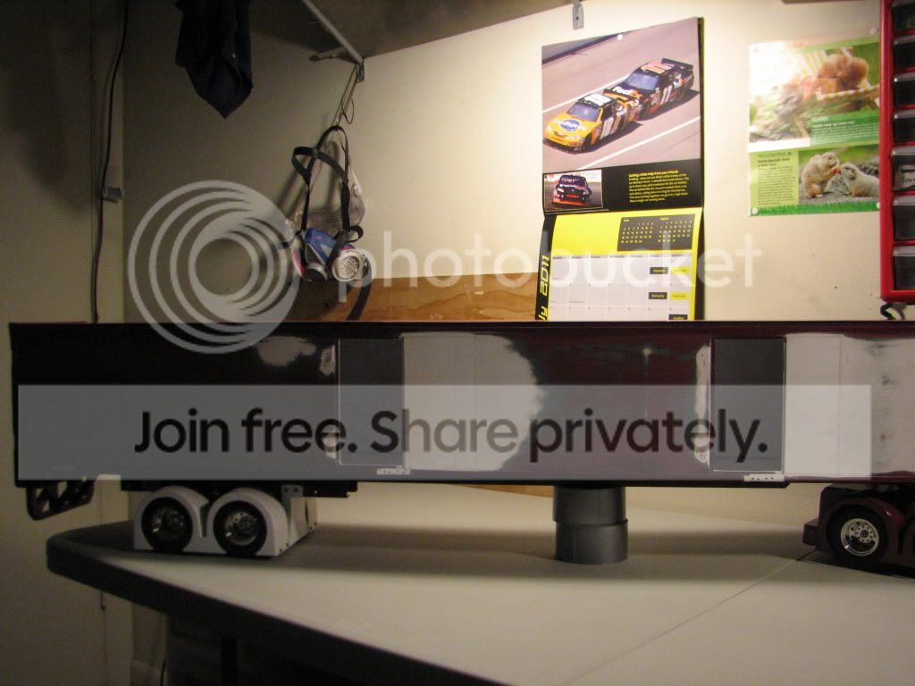

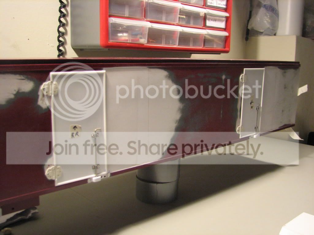

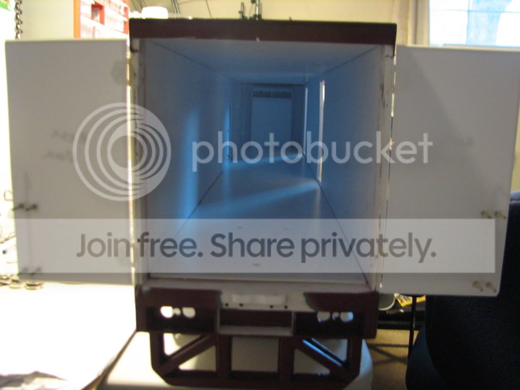

Well the last picture the opening of the trailer did not look right so more reconstruction has been done opened it up alittle to make it look more like the inner insulated walls.

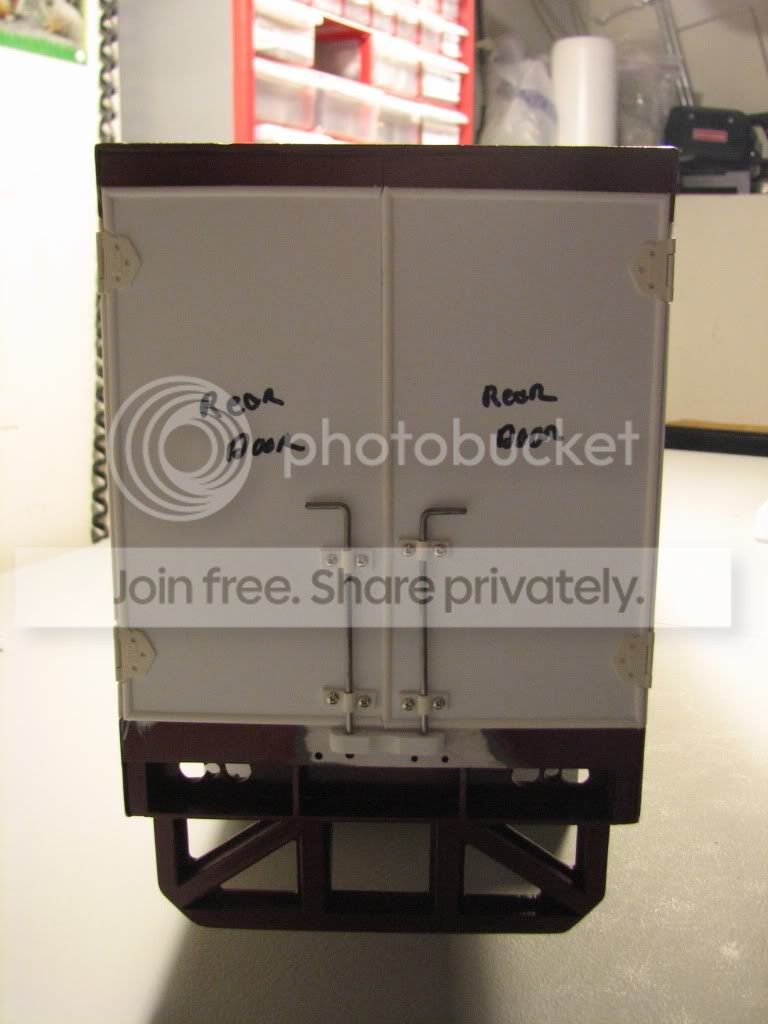

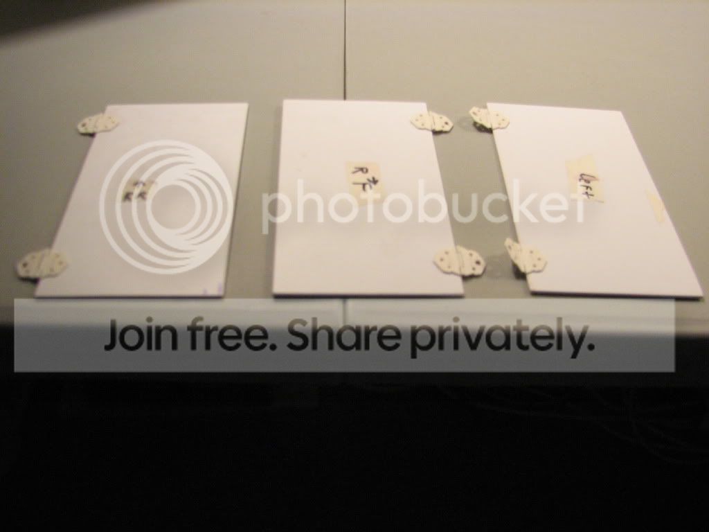

Almost finished all the doors. All of the latches are functional.

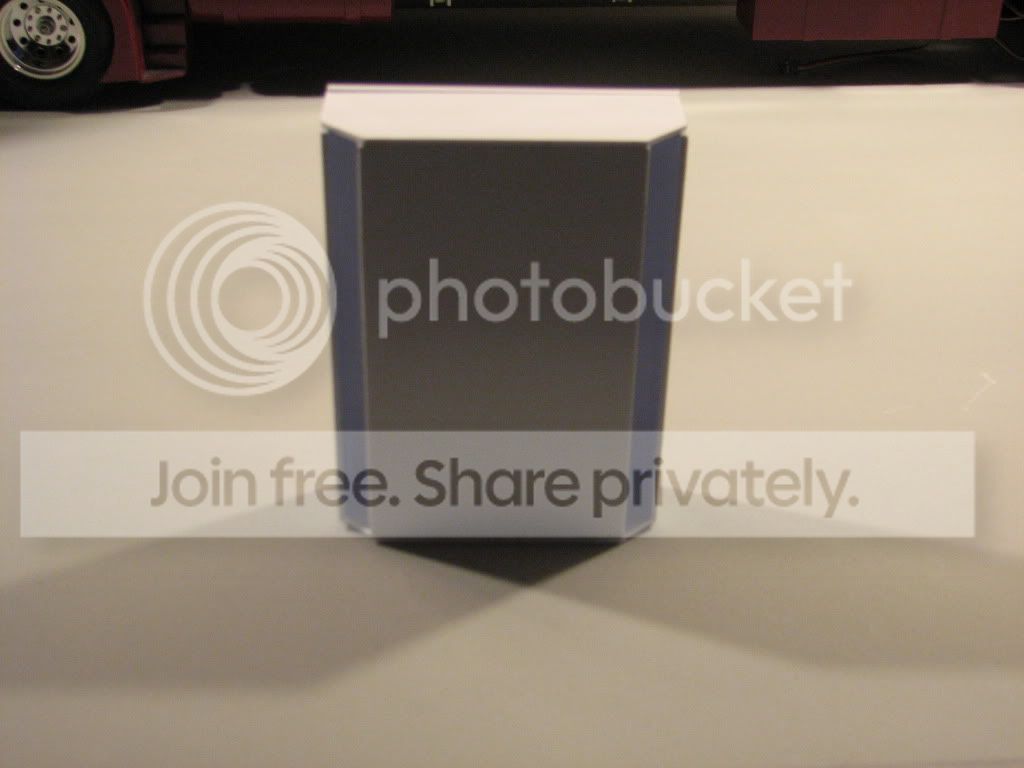

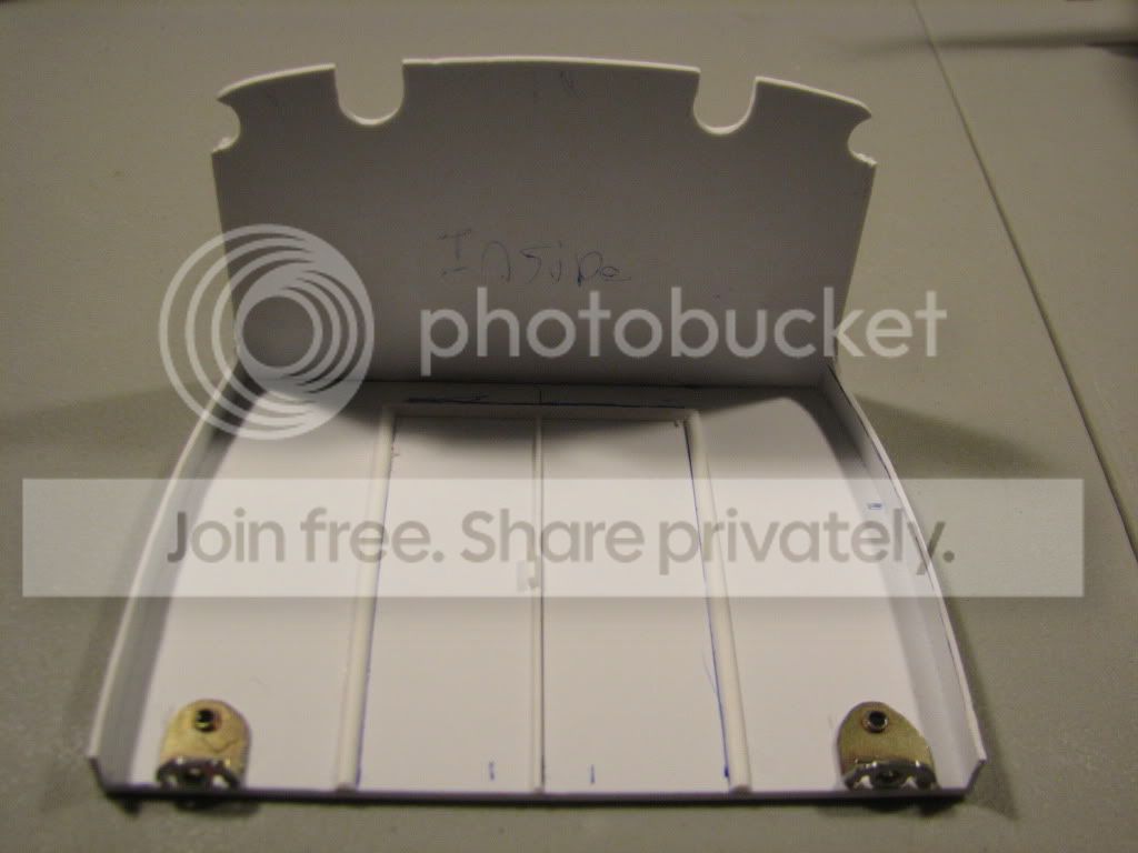

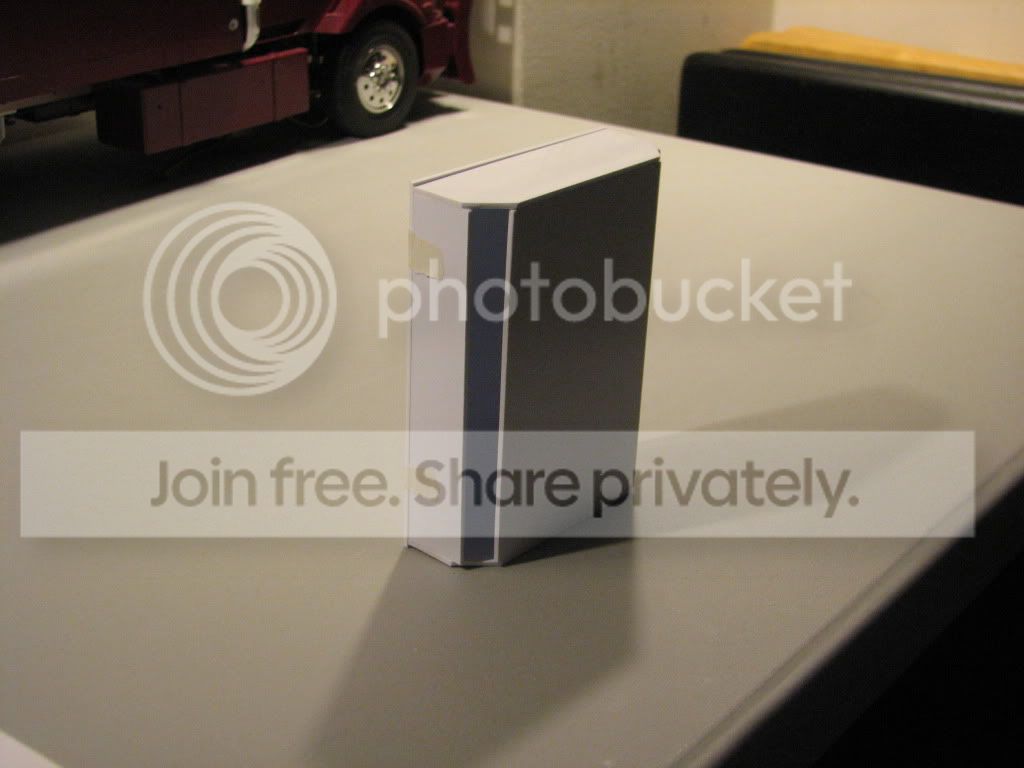

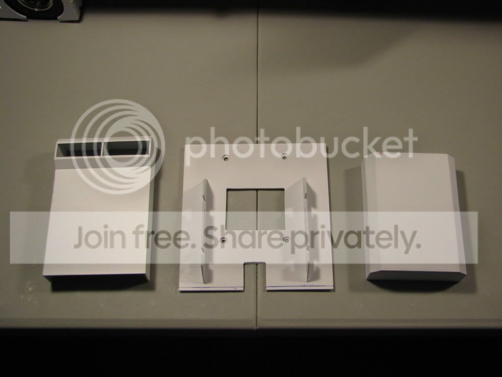

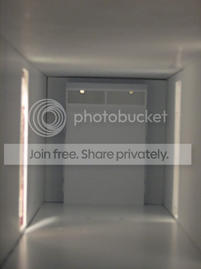

Just like the floor i made the front wall removable. The inner wall is going to be held in place by the screws going through the trailer wall to clamp together to the refrigerator unit to hold in place. I also made a vent box to do a couple of things. One to hide all the wires going to trailer and make an access to the trailer leg batteries i placed in the the refrigerator unit. The vent box is going to have four pegs coming out the side to latch into place and is removable from the inside.
Here is a shot looking down from the back of the trailer of the vent box in place.

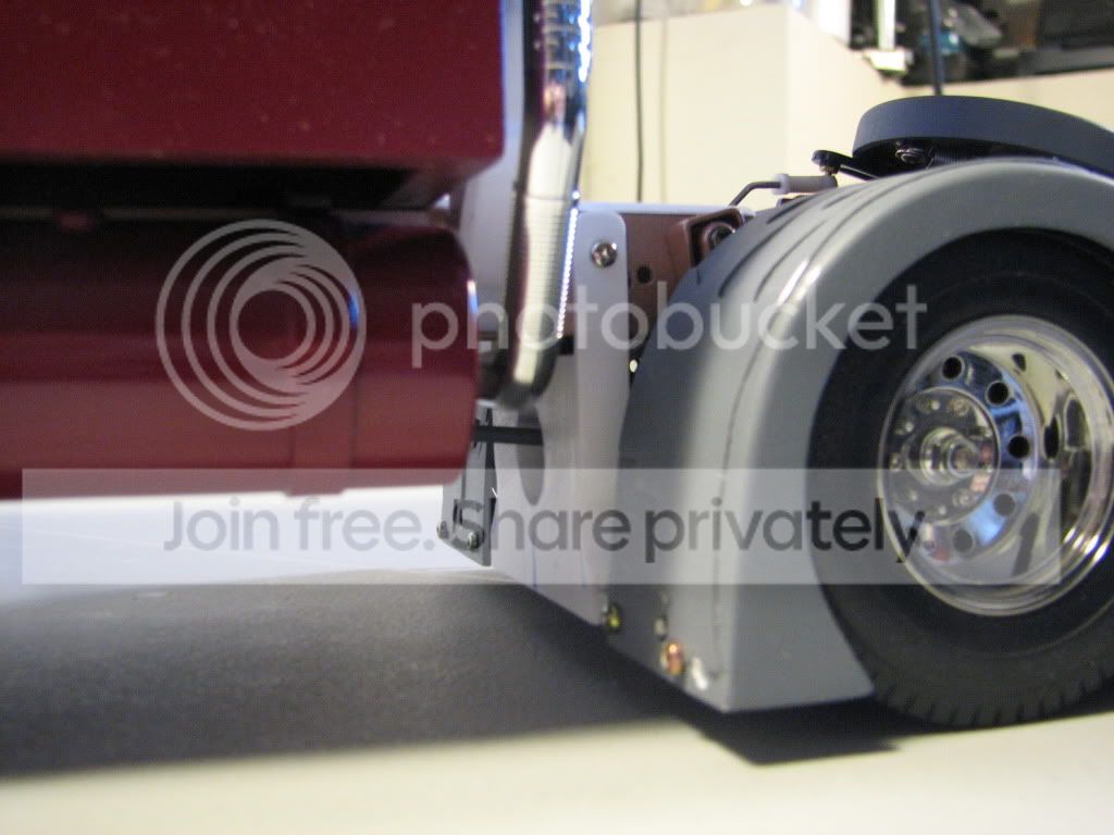

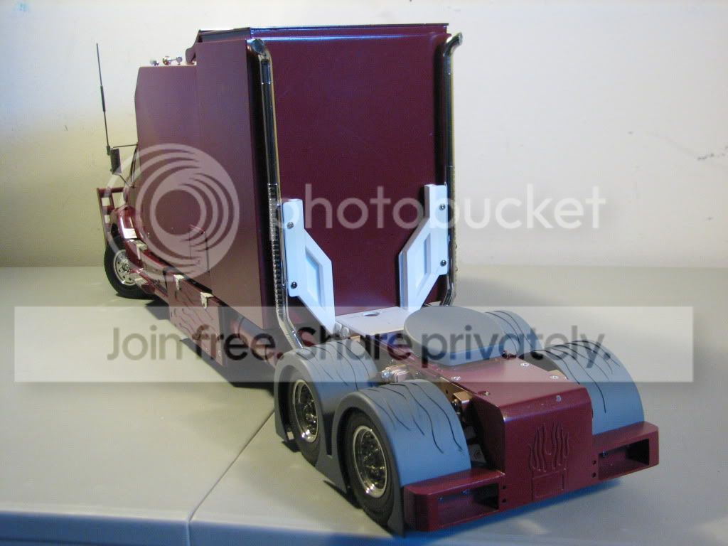

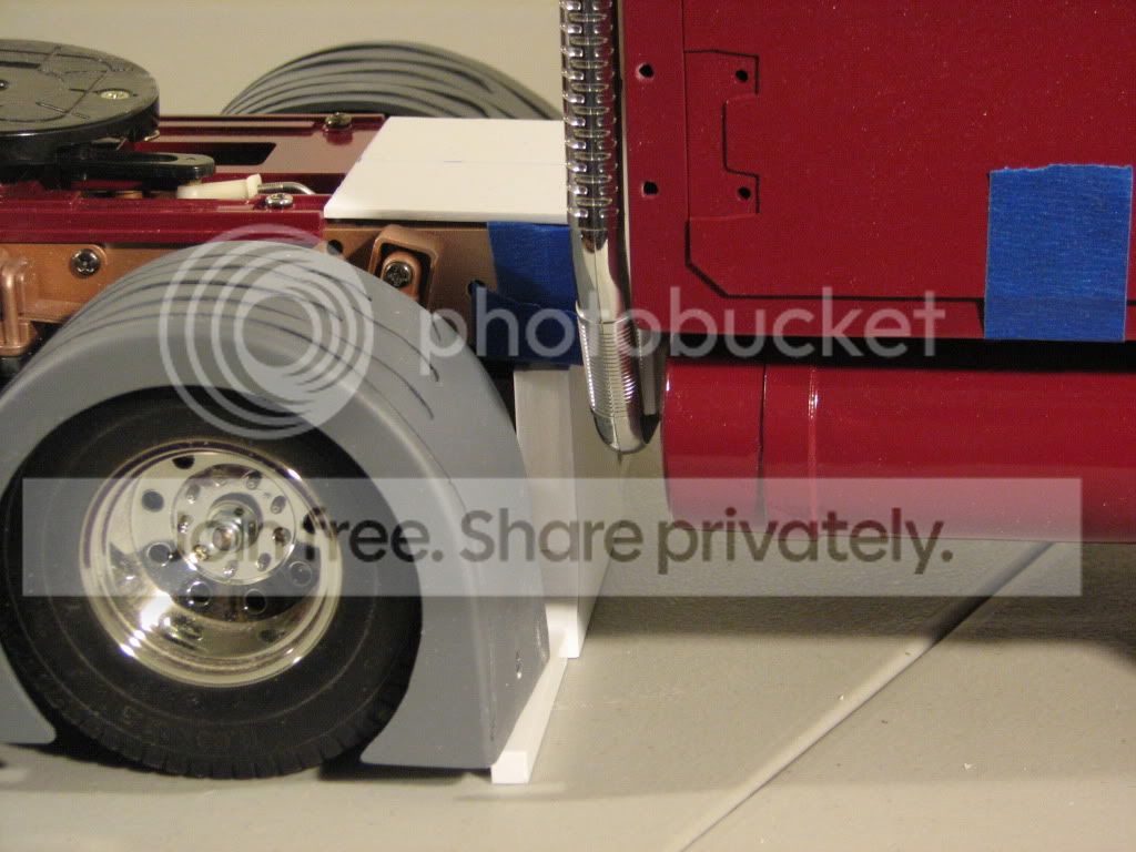

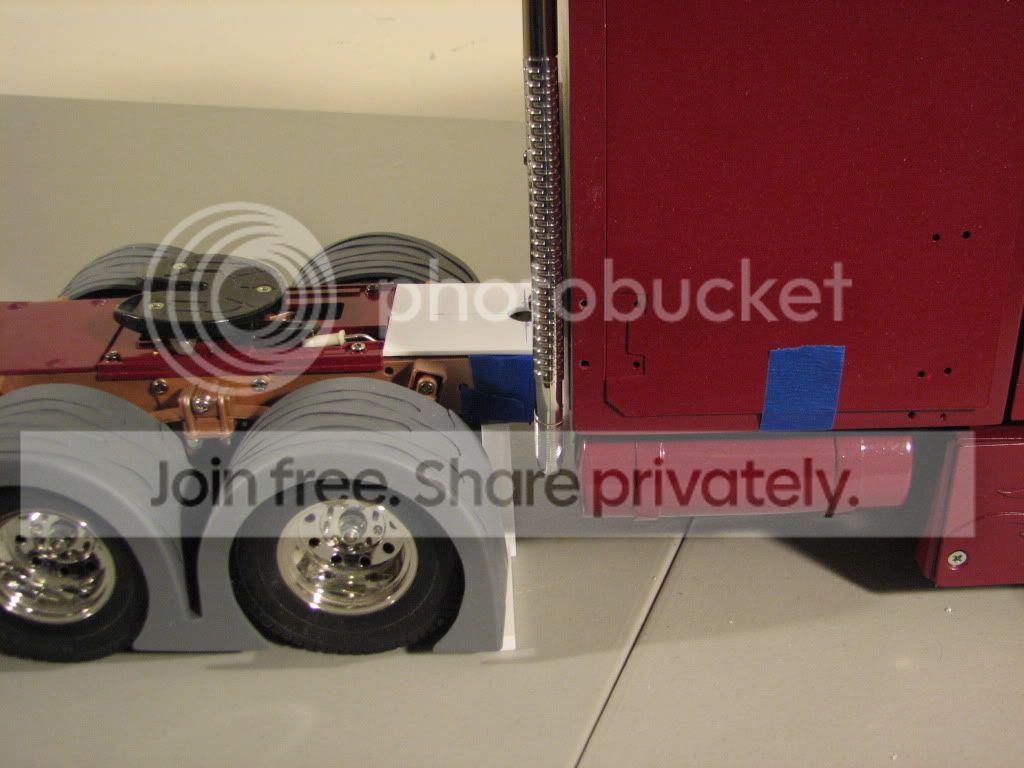

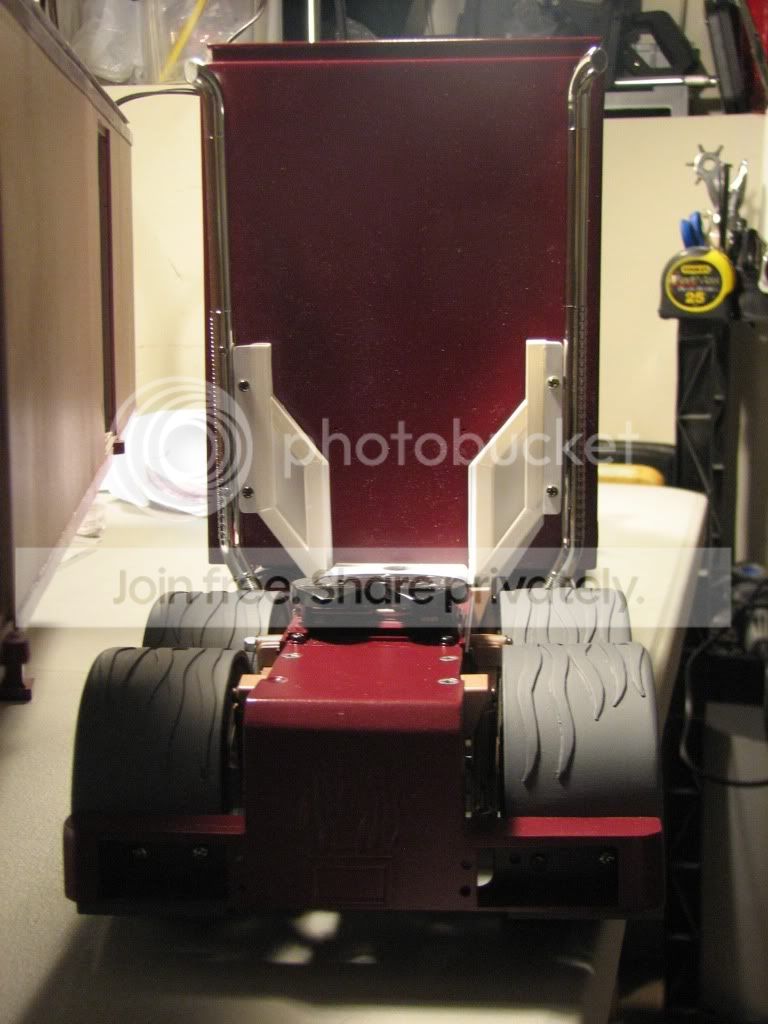

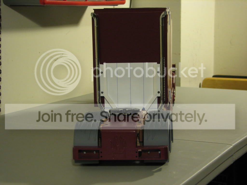

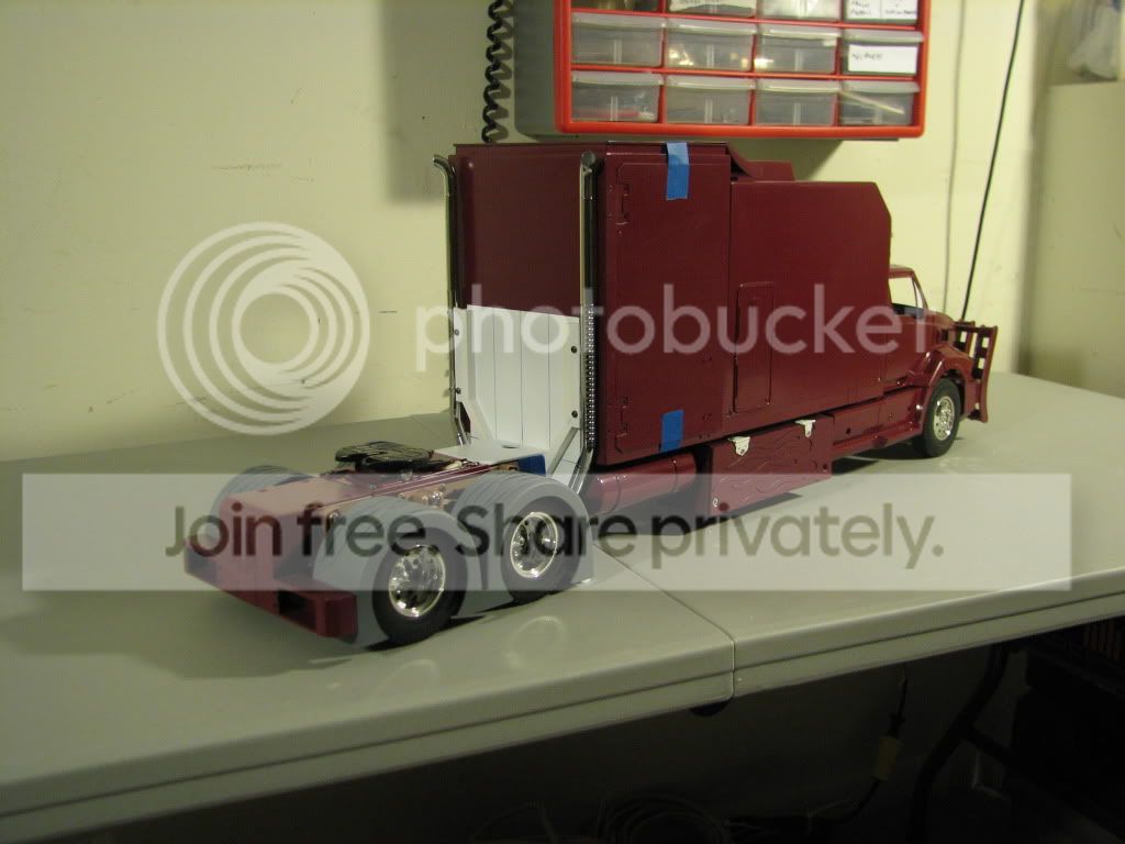

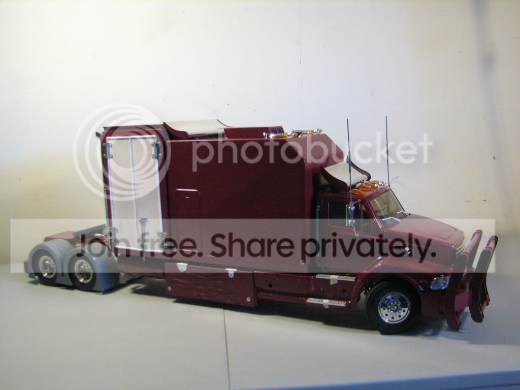

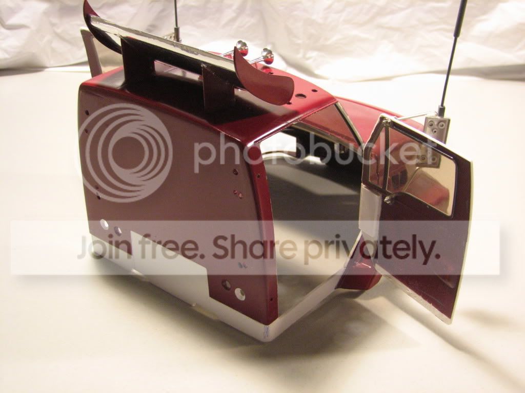

There was a few things my eye just could not stay with so i made some changes. I am making a bracket to hold up the fenders on the truck just like the trailer. I removed the steps they did not look right and moved the stacks back behind the box. I used the original stacks from the kit and in the process of making some new holders for them. The kit brackets for the stacks just did not bring it out enough.
love the maroon. so you have some pigtail wires going to the trailer, that'd tie it together. I love when people go all out with the small details. Looks like one of those long distance tractors in Australia.
Ya it is a big one but the front bumper i wanted to put one of those on because i am a fan of the types of bumpers.

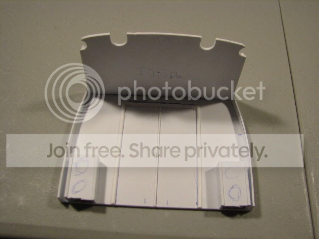

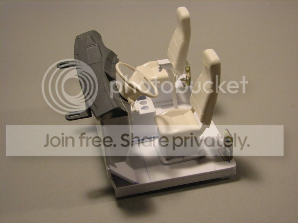

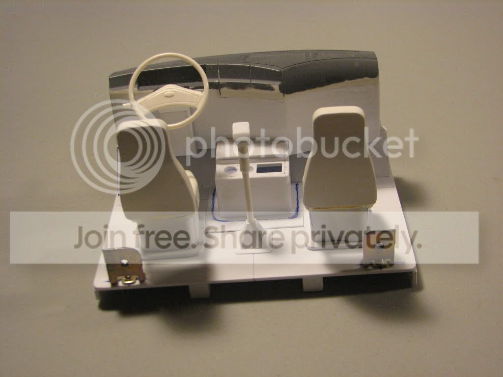

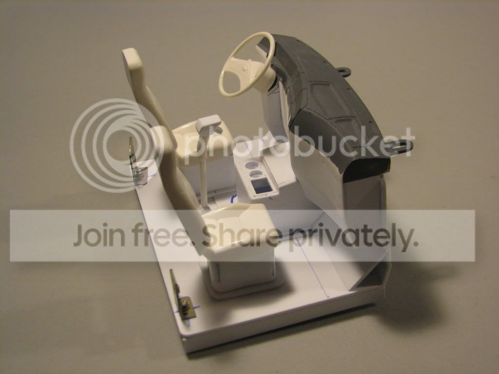

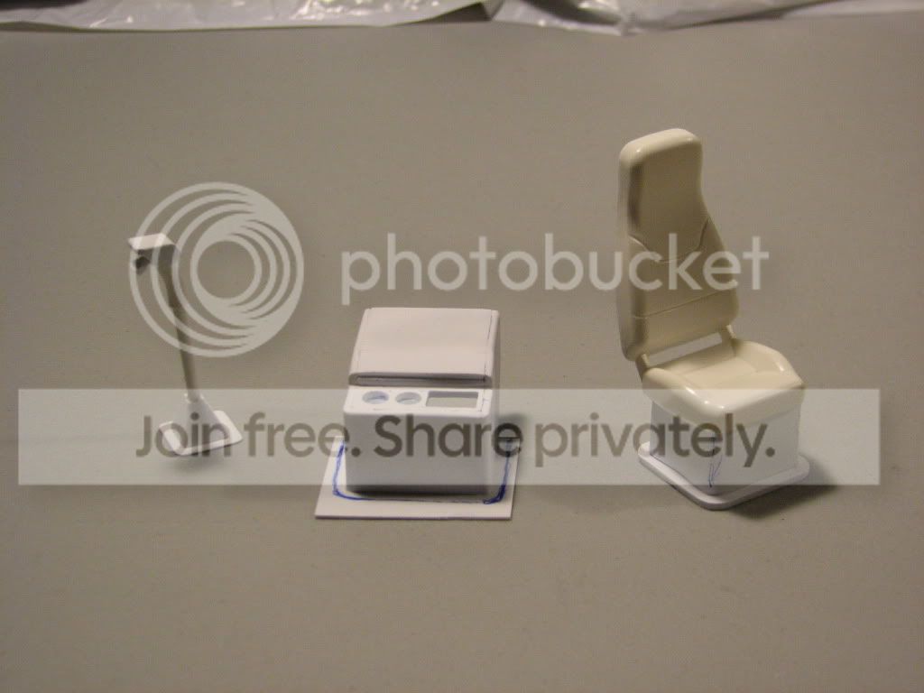

Well i had to keep myself busy for the winter time so i am working on another part i always wanted to try. I wanted to make a detailed interior but never tried it on anything. So here we go. To do this i had to move the motor back into the sleeper and made a whole new sleeper platform to go around the motor. This is what i have so far. I am really happy with it. I made a new cab floor, added to the dash, made a transmission cover complete with cup holder, the back of the cab and roof are one piece still working that one, stick shifter with high low switch. The seats i reworked and put some plastic around the spring section and going to heat it up to melt them to simulate wrinkled fabric.

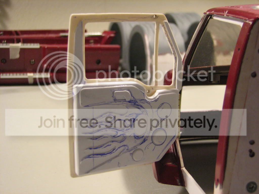

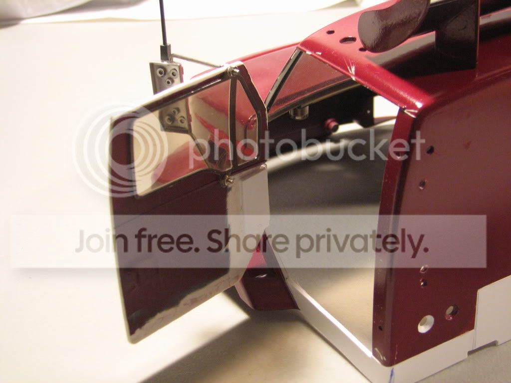

When i cut the doors was a litte nervous for me but i got through it haha and i had to add to the cab to make it whole again. The hinges i made from scratch but i don't think those are what i will be using when i am done though.

Things have been kind of slow lately but i did make some progress on my cab interior.

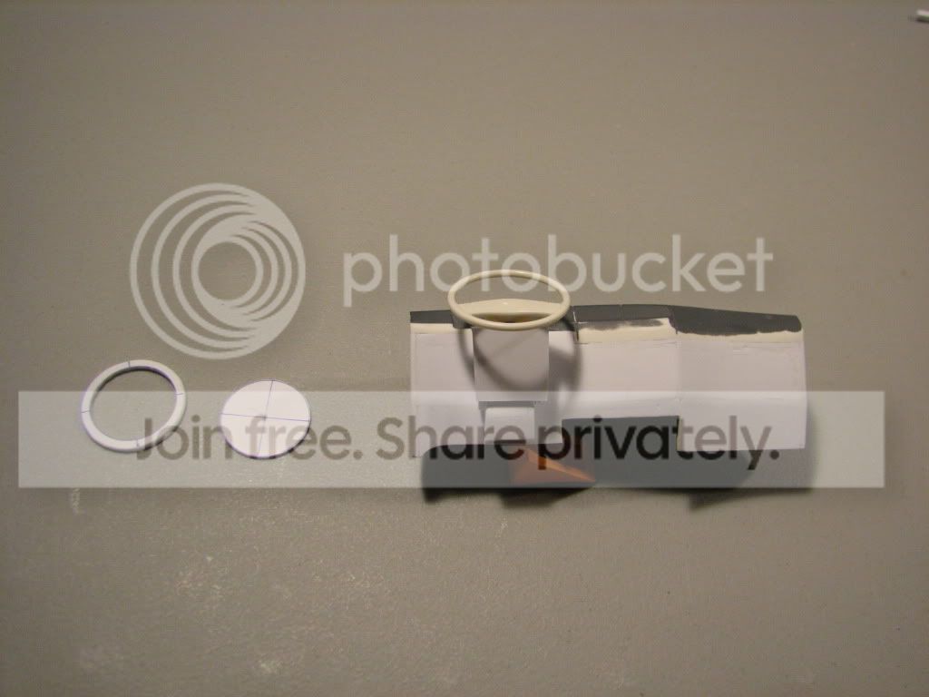

Here is a coule of early shots of the dash and custom steering wheel i am attempting to make from scratch.

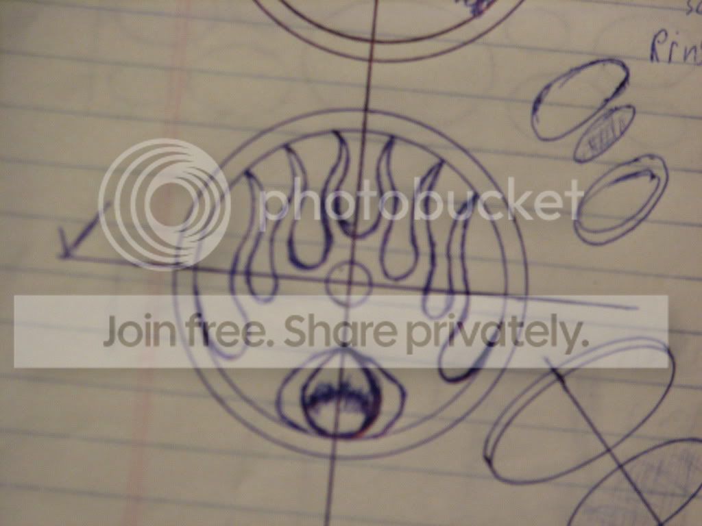

Here is a shot of the door which i am very happy with. If you can see through all of the scrible marks i am trying to make the 3d flames again and other detail stand out.
