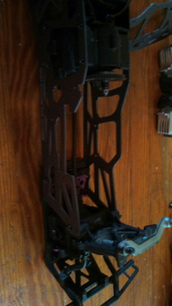

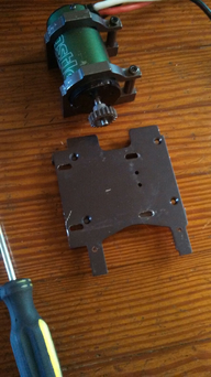

it is a savage Flux HP, and I am using the stock flux motor mount, and my motor mount does not fit into my XL TVPs .... I could take a picture of my Flux although it isn't parts if you need a picture

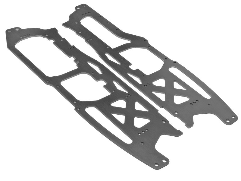

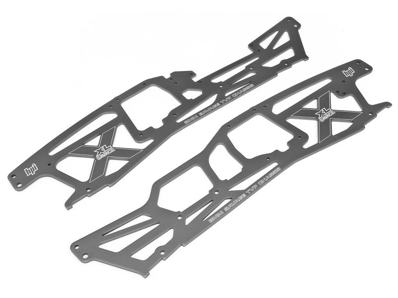

The XL and Flux TVPs are quite different. Is the issue that the motor can't be mounted due to the TVP being in the way? The XL TVPs have bracing where the Flux TVPs do not. Right around where the motor mounts.
XL TVPs:
Flux TVPs:
If that is your issue then you will have to either get Flux TVPs or cut up your XL TVPs.
So I Need To Cut Them...You Are Correct The Tvps Are In The Way Of The Motor Plate. I Have The Original Flux Tvps But Wantd To Xl My Flux . Now Ineed To Cut Them ...Shoot .... Well If Itll Work Ill Do It... Any Other Ideas You Might Have On This Build , Just Got My Xl2 Esc And Dying To Get It On The Move Again

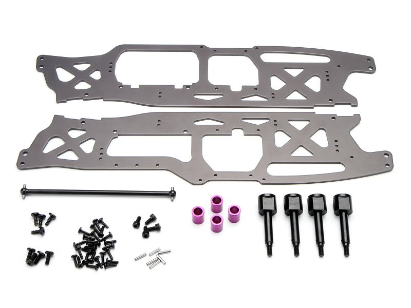

Hey X , if you're still around I just found these on ebay, and was wanting to know your opinion do you think these would fit Heres The # 181792397129 Ebay #
Those look correct. At that price it doesn't hurt to get them and find out. Obviously though that doesn't come with the extended dogbone for the rear (or any of the other hardware for the upgrade). Do you already have that?
yes I have the rear dog bone XL and I already have offset blast rims.. is there anything else I would need
Think you are probably good then.

by the way I was wondering do those plates look like the holes with match up... the space I found on ebay
The extended plates should only move the rear bulkhead back. I believe everything else stays the same.
yes with the exception of the rear dog bone but that's what I got those XL place that I have now for. okay wait a minute I get what you're saying.
since it does have the gap in the Tvps for the plate to set in, then the whole should all line up is that correct
If you look at the standard flux plates and compare them to the "XL" flux plates the only difference is the "X" behind the motor mount location. That is because the extended portion is behind the motor mount area.
okay I see what you mean but the XL place I have now are different because they do not allow for the motor plate to stick out. but the ones I found on ebay they look like they allow the motor plate to stick out. so after that the rear of the vehicle should all be fine. am I on the right track or am I completely lost lol
Yes. The XL TVPs you currently have are for the nitro truck, so they don't work for your application. But, the XL TVPs you're buying off ebay are made for the flux.
