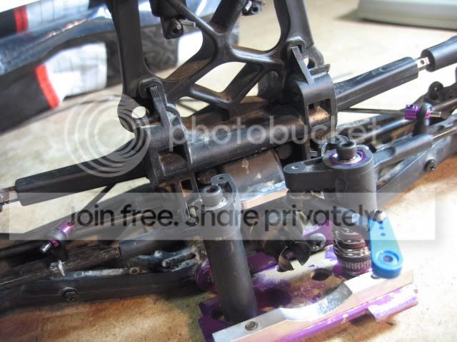

yeah your spring should look like this
I think I stipped out the gears but not sure I have not take it out yet. It just sounds like it. I will loosen my spring on the servo saver and slowly tight as needed. I will also add the blue horn as seen in your picture along with the loctight.

Replaced the stripped gears in the servo. Took the aluminum servo savor apart cleaned well, lubed, sanded, and put back together. Smooth as silk. Tested on savy by holding the servo and moving the wheels. Works great. Took out for some bash time and whala went through 4 tanks without a hickup. Best time I have had yet with the truck. The only thin that stopped the fun was one of the main drive cup screws fell out or broke one of the two. Did not find this till I gotter her home and took her apart. Can't wait till this weekend for another bash session.
