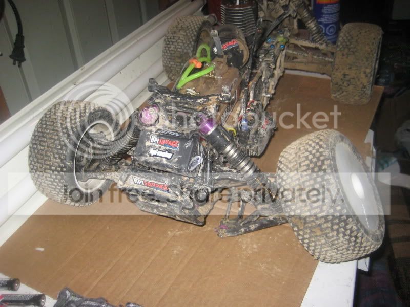

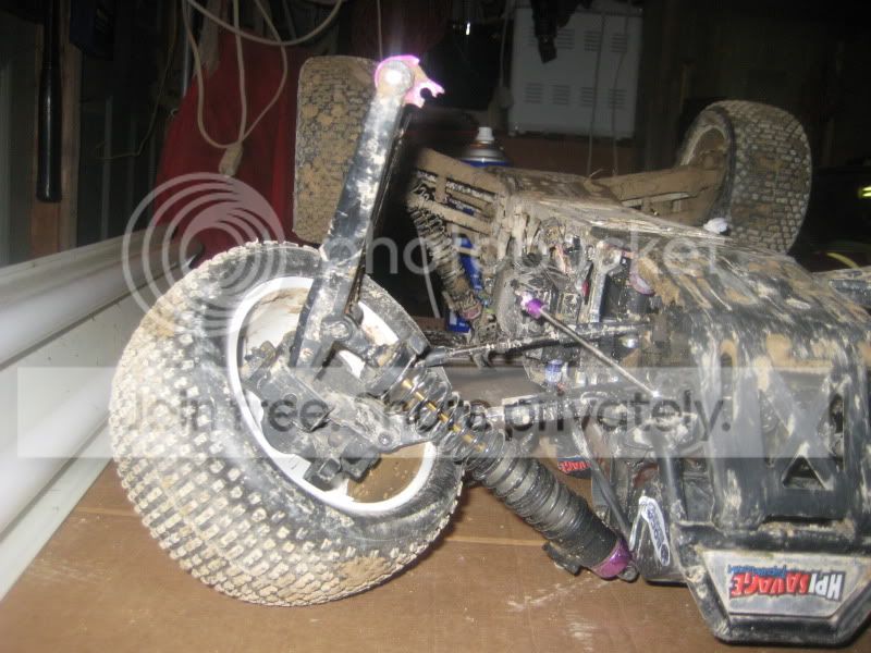

Still looking for more ideas on what to do in all. Thanks to everyone that have put out a lot of their build post to give me ideas. I'll post pics when I get the parts in and on.
So far this is what it looks like.

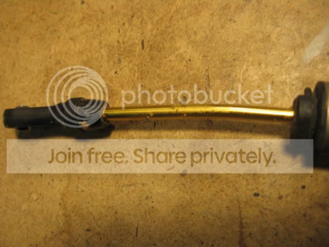

nice going to have fun with the build .... but the rpm arms are extreamly tight fitting ... they don't move to freely so youll want to grind all the pivot points down a little at a time till they move like stock arms ...they also tend to bend shock shafts pretty easy to .. they flex like crazy ...just a heads up... good luck .. happy building..

Thanks Maxim I intend on switching out the shafts as well. Didn't know that they flex'd so much. I've used them on previous rc's, not a savage, and I had good results out of them. Any other suggestions? Or should I stick with stock or the aluminums I have on it already?

Trust me the only thing you will break / bend on these are the shafts.

i doubt youll ever break a stock a arm... it happens but it has to be some extreme impact.. aluminum ones will tear the bulk heads apart and tear the pins out of the bulk heads so wouldnt use the aluminum arms... the rpm arms for savage have alot of flex to them due to how long they are i think..
