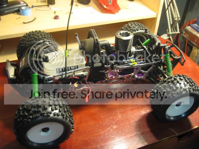

Here is my OFNA 250cc Mid-Tank ::
• How she sits now ::

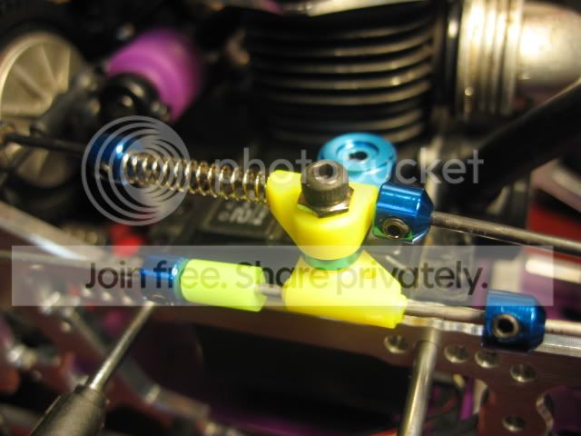

• Linkage set up for throttle / brake ::
