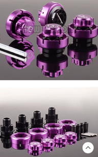

What do i need to make the wheel hex 17mm. I cant figure it out. Do i need new c cups? Or is it just the hex en pin that i need?

Hi bud and firstly welcome to the mad house. As for the 17mm hexs you could just with the 17mm wheel hexs from HPi to get you going, or change to 17mm adaptors, as for the rotostart most are 27mm across the fixing diagonally so the one from an HPI will fit most mills.
17mm Hexs witjh larger flange nuts
These utilisze the orgininal axles, the lock nut is put on backwards to support the hub at the end of the axle.
This type comes with a non threaded axle and is best if you bash alot.

you can also get these 17mm conversion from ebay. which I did with my savage but in silver color.
or the impossible super crazy expensive to get is the long extended one which I really want!!

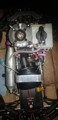

Got a new Force .36 engine for 2 days. All fine and nice but the damn pullstarter broke twice.
I have a roto start but the ons way bearing on the engine is 12mm and the roto is 11mm.
Anyone knows wat the problem is? The old k4.6 bearing is diffent to.

The K series engines like your K4.6 had 11mm starter shafts with the OWB inside the engine. which is why you have an 11mm roto start plate. Most engines now use a 12 or 14mm OWB. So you will need to purchase a 12mm Roto start unit.
