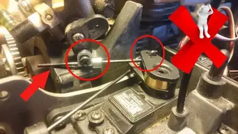

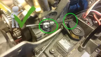

I noticed in your film in an earlier post, OWi, that your throttle linkage is probably not mounted in a good way, take a look at these photos I took of my setup, before and after fixing it.
In the top photo below, when you give gas, the pusher on the steel rod can get in contact with and get stuck on the plastic housing underneath, that might cause your car taking off. And as you can see, you have contact also at zero throttle, where the red arrow shows.
In the photo below, everything runs clear.

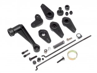

You are missing a piece of rubber that goes between the two pieces of metal with the set screws, refer to part number 108948.
So, the exploded view is showing the completely wrong thing here, apparently an early prototype version.
When looking at photos on the internet, I can't spot a rubber piece an any of the few photos I've found.
And in the photo on HPI's website for this part number, I can't identify which piece should go in between!?
Sure, finding some rubber is not the issue, I think 😉 But do you mean there should be a piece of rubber between the metal part that is fixed to the "rod" (the "pusher") and the metal part that is fixed to the arm on the carburetor which the rod passes through (that the "pusher" is pushing onto)? Or elsewhere?
What part in the picture is the actual rubber piece?
ANyone with a photo perhaps, showing this rubber piece?

Hopefully this helps, also when I got my truck back from HPI the CD I was flipped around so the solid part of the ignition wire was coming straight out of the battery box essentially reversed as it was from the factory...this may fix the twitching issues.IMG_20150617_235703.webp
Thanx for the photo, I have not seen a rubber part like that on mine.
I also notice your linkage is underneath both the throttle horn and the screw on the carburetor side. Mine was like that, and tended to get stuck as it got in contact with the plastic housing underneath. I switched, as I mentioned earlier in thread, so it is on top instead, and it works fine. I also notied that is how it is depicted in the manual. Though there is a totally different kind of linkage there.
I have also noted that the range of the throttle movement does not quite match the full throttle range of the carburetor. However, as I am still struggling with break in (or maybe a faulty CDI) I have not dug deeper into that, yet.
