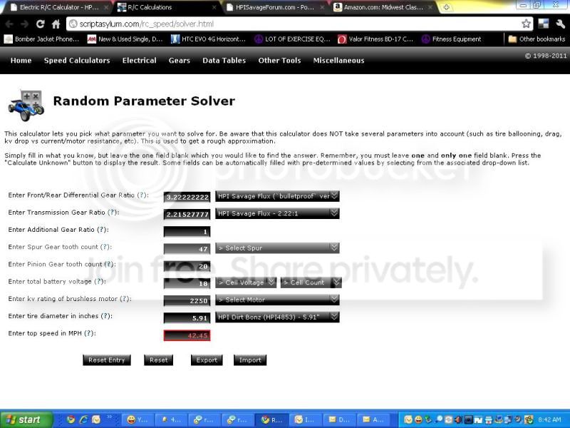

The diffs are factory-ratio XL BP diffs. I already have a 47t steel spur gear set HPI-86806 as well as a 49t and 52t. When I run these numbers through the online calculator, the top speed is coming in around 15 - 24 MPH. So I am concerned that I am missing something, big time. Having scoured this site and a few other resources, I am not content that I have an answer that I can rely on.

here is a decent estimate of top speed on 5s with your set up:
the highest i would ever consider going on a flux pinion is 22t, but i run 20t and the all around speed is ballistic. over-gearing a flux just a little can very easily end your bash session with a BC fire extinguisher.

I will order a 20t pinion and a 44t spur and go from there. I will also go back and run the numbers on that calculator again. For some reason my results came back with about half that speed.... Weird.

the calculation i ran was with a 47t but yeah a stock 44 would work killer.
the speed is much higher on the calculator i ran because i used 18v (should have really been 18.5) and on 4s you woulda used 14.8v.
this represents a difference of a difference of 3.2v & 7200 rpm of the different voltage scenarios.
in actuality, you will get the following rpm from that motor given the respective voltage:
4s = 14.8v x 2250 = 33,300 rpm
5s = 18.5v x 2250 = 41,625 rpm
6s = 22.2v x 2250 = 49,950 rpm
5s is the sweet spot between saying "yeah this truck is great" & "OMG" :spiderman:
