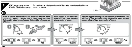

Hi ! That is solved, entering the ESC setup
