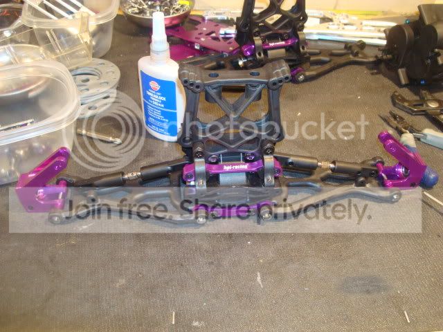

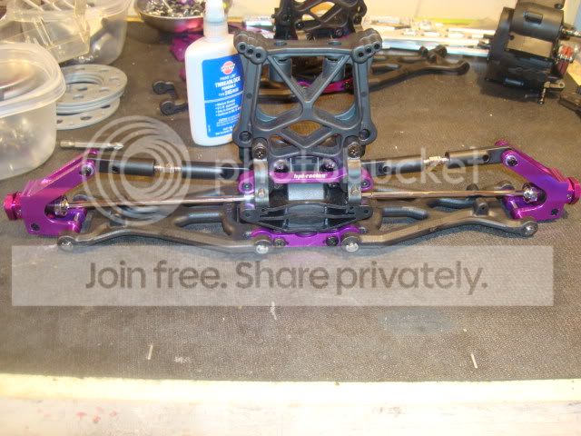

i finished the rear end of the savage..HPI cvds, RPM arms, HPI bulletproof diffs
i really like the FLM shock towers, but was thinking they would just add extra weight, so i left them out......for now
RPM arms

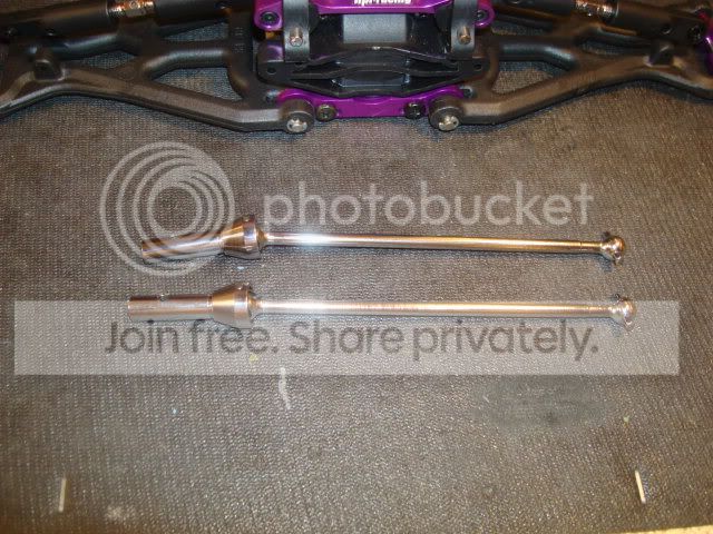

HPI 17mm cvds

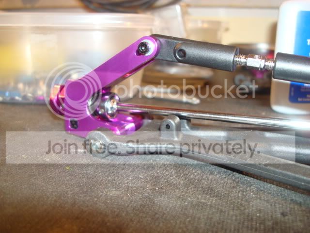

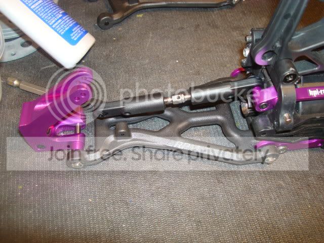

Looks like it coming along pretty good. I was just curious about those aluminum rear hubs you were talking about. What are the benefits compared to stock or the integy ones you compared them too. Thanks in advanced.
the hpi rear hubs only come with the hpi suspension conversion kit
they are used to eliminate the rear toe link
i bought the integy rear hubs for my other savage, so i could go without using the rear toelink, if your not racing, you really don't need the rear toelink, just a weak spot, in my opinion, i rather just not have it
i compared the hpi rear hub to the integy rear hub, just to show how much beefier the hpi hubs are
ive run those integy rear hubs for almost a year and haven't had any problems
