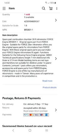

my bad 38 is 6.3 I went with 38 because the dimensions were in the listing,see pic,,same size,might have to take a little off the outer circumference.will post results

to let everyone know both force buttons are a fail,,funny hpi still sell the block for the k5.9 but not the head button,,anybody got one for sale???
Yes surely they can’t be that different they both come out same factory?
the bore size is different,this i managed to do,,it was also to deep into the cylinder,,I patiently filed it down until there was clearance for the piston,,then had to notch the outer edge to allow for head bolts to fit straight,,it failed to start,,just kept going tight as soon as throttled engine failed to turn nearly burnt out rotor starter....I think the depth of the button is my failure,,as I don't know how far it should fit into sleeve as my stripped button is being sorted by a friend of a friend and don't know if or when I get it back..any ideas would be appreciated!!thank-you for replying.
