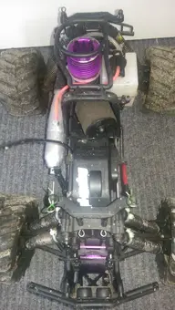

Hi I've taken some pics, hope you can help me with them,

That is a V1 F4.6 engine.

Right only just had a chance to look at my savage, when I take the glow plug out and try to turn the engine while looking down the hole, the piston is not moving, I'm presuming this isn't good, so do I need to start a strip down of the engine, what could the out come be once I'm inside, is this a job for an amature, I am good with things like this and do have a lot of experience with full size cars.
Well I am sure once you remove and inspect the :ercm: you will find the trouble... it is not difficult to do and actually is a good experience to know the ins and outs of these little :ercm:
Post up some pics of your findings....
take off fuel lines, remove linkage, pull engine, remove backplate and head, inspect internals, I am sure you will see what is happening inside, most likely a broken rod is going to be the culprit.....
To be honest, to repair that :ercm: it will likely cost more than it is worth, a rod, piston, bearings and sleeve will be more than a new engine will cost, look into the LRP, Ofna, or many more of the available engines in the .28 to .32 line to just replace the whole thing..... you can get a complete unit ready to put in for 150 or so.....
