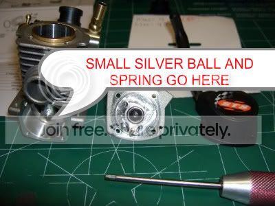

here is a picture
Where the little arrow is pointing is where the metal silver ball and spring go into the rod

yep i know, but that picture is for refercence. Almost all of them look like that on the inside, with the hole in the rod and a silver metal ball with a spring or two
