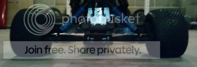

These are the stock ones up front.

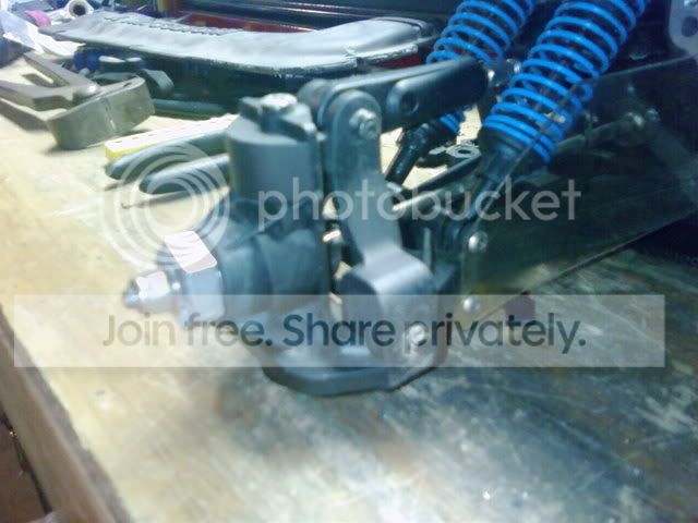

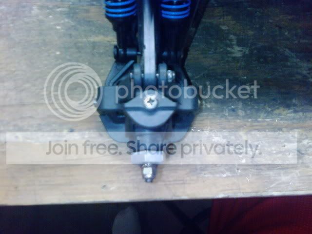

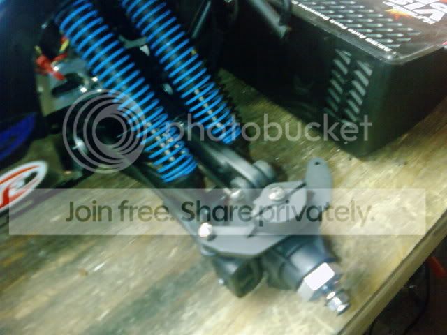

Basically what you are giong to do here is take two stock hpi upright hubs and modify them to run upsidedown on the C hub on both sides of the truck. I would suggest a dremel for this as you will want to take even material off of both sides until you can just barely fit the hub on. I would actually suggest leaving a little extra material on the ends so that you have to push a little to get them to bolt in so there is no play. You are going to want each side to be as equal to the other as you can so that your toe is not off.

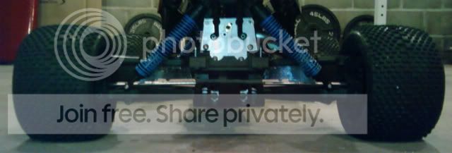

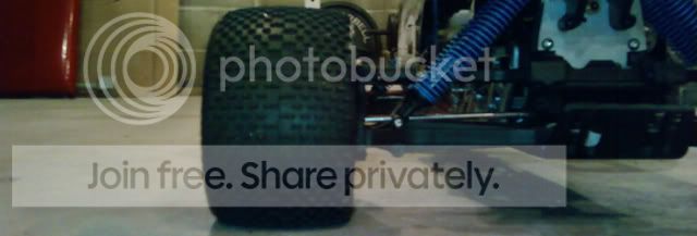

Now for the reason you want to have adjustable upper A Arms. The problem I noticed with this mod is that your hubs are not going to sit normal because they just aren't designed to be run upside-down. So you'll need to adjust your upper A Arms out a little bit so that your camber is set at 0 or slightly negative, whichever you prefer. I like to run mine a little negative. The biggest set back of having to do this is that your dogbones will now have slightly more room to move around.

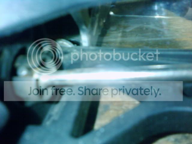

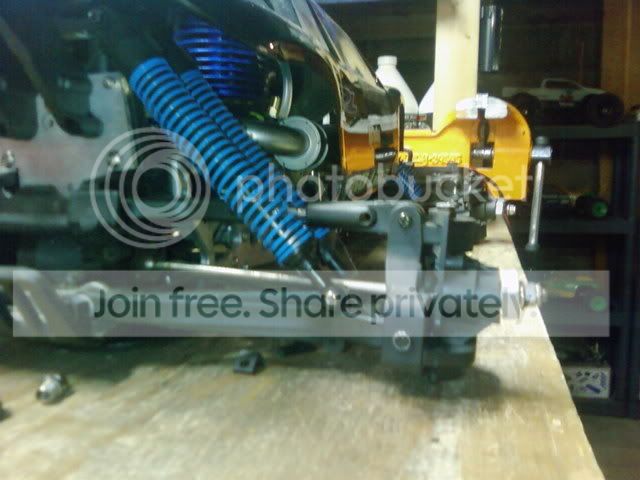

Here is a picture of how far this will allow the dog-bones to move towards the end of the cup. I do not think this is going to hurt. But if my dog bones ever pop out or my cups break in a strange way I will definately post pics of it.
Now for some pictures of the final product.
Here are the Pro's and Con's I have found from this so far.
PROS:
-Eliminates Rear Tie Rods
-Removes Play from Rear Suspension
-Slightly Lighter than a Stock Setup
-Costs only $4.79 a side or free if you have spares
CONS
-Driveshafts have more play in the Rear
-You can't re-use the hubs anywhere else
-Possibly weaker then aftermarket aluminum
-You have to use adjustable upper a-arms and adjust them out a bit.
