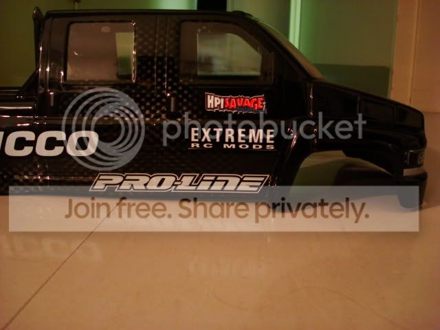

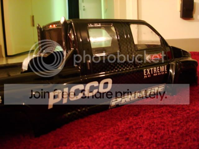

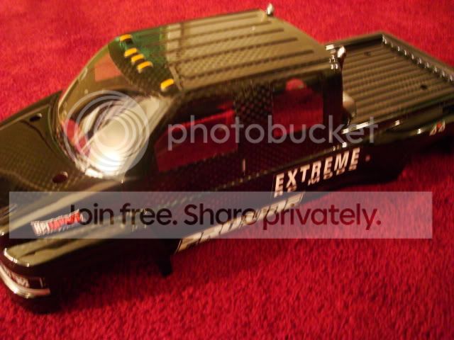

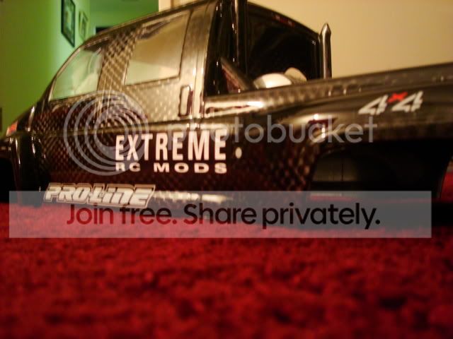

All spray can. I will take pictures of it on the truck and give details of how I got it done.

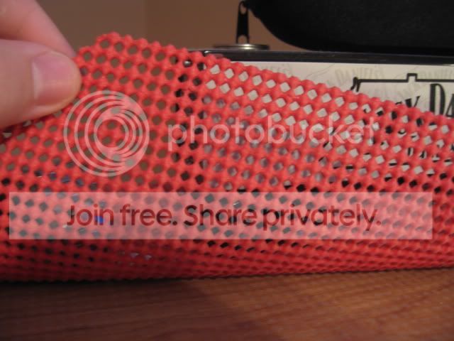

Nice job ! what is the name for that rubber mat you use to do that. I cant find the stuff!
It's shelf liner. They have it at Wal-Mart in the Automotive/RV section.

Is this what your looking for ??
Yup, Shelf liner and it is also in the home accent area. I choose the smallestl square design and I cut different sizes to fit the odd corners. There is really no masking. I used gloves so my hands would not get painted , black and indy silver spray can.

Thanks all. I know many contemplated, I just managed to get it done. The hardest part was lining up the squares in between shots, but even that is easy. If and when anyone ever tries it, they are going to say that’s was easier than doing a regular two paint scheme.

how did you keep the stuff in place when you were painting?
I used gloves to keep my hands from getting painted. I just used my fingers to hold down the mat. The gloves will have about a 1/8 of the spray paint on it. :lmao4: For the deep grooves just stuff the matt horizontally and spray.
