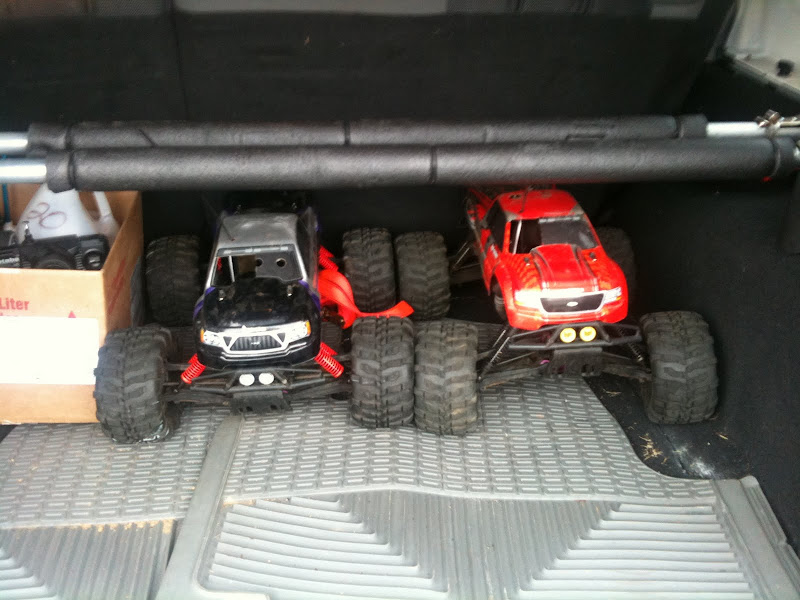

This is what my truck looked like heading to bash with Pope!

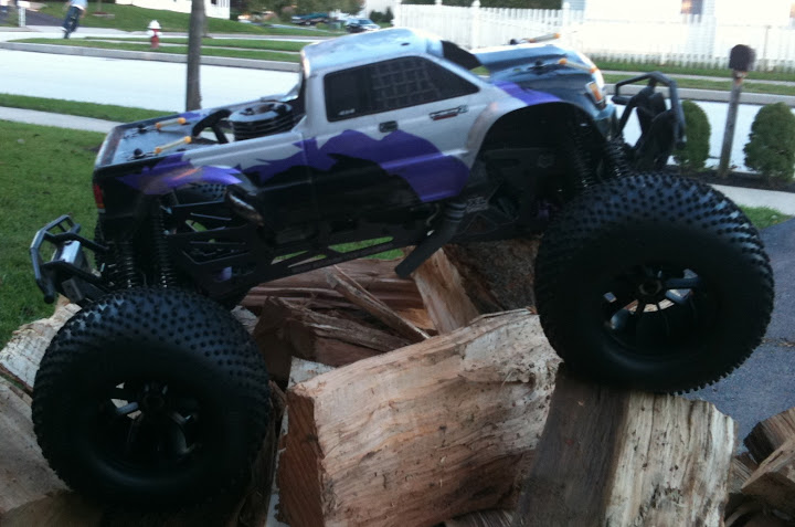

Moe Lives!
Well I have spent the last few days workin my tail off on Moe - and it finally paid off!
HPI 4.6HP, XL TVP's, XL diff's and bulkheads f/r, XL axles, Flux outers, steel spur gear, Ofna throttle linkage mod - all done in about a week 🙂

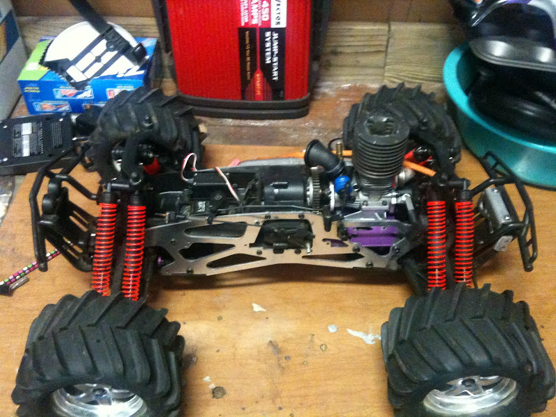

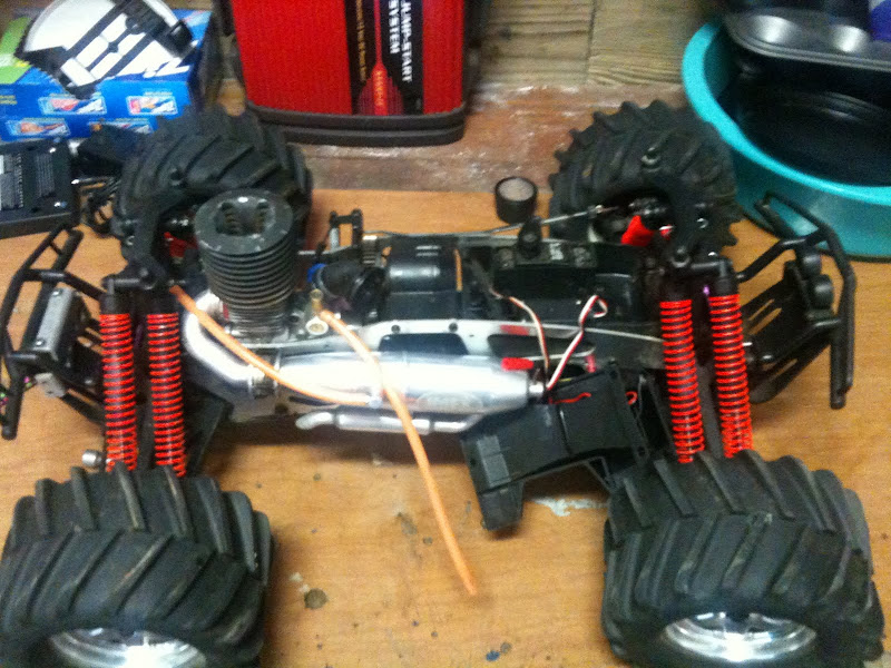

Well today I started the first steps in the tank relocation, by moving the revceiver and battery to the back. This is also posted in the How-To section, but wanted to add it here too:
OK, few caveats:
1) This is my first how-to, so be gentle 🙂
2) My truck is a Savage 25 with the XL TVP's - this gives me the room to move the battery box behind the motor - so I don't know if it will work for everyone
3) Where the battery is mounted will block your access it you use a roto-start - just keep that in mind.
So this is how I moved my receiver and battery from the front of the truck to the rear, in preparation for a mid-tank mod coming soon. My mission was to do it as cheap as I could using crap I had lying around as much as possible.

To start things off, I needed to figure out how to mount a horizontal brace from TVP to TVP without drilling - I did not want to weaken the TVP at all, and it seemed there HAD to be a way to make this work.
When I lined up the brace between the TVP's, I saw that the spaces cut out where different from side to side, so I had to find a place on each side where they were the same. Once I did that, it should be a matter of putting something there to hold it in place - right?
After I found a place on both sides of the TVP's where I could attach the brace and keep it even, I needed a way to keep it from moving around too much - I happened to have a few diff braces lying around from my XL diff conversion, and I used them to hold the brace in place front to rear. All put together, it looks like this:
You will notice that the brace is significantly below the top rail of the TVP, and so did I, especially when I looked at how wide the T-Maxx battery box was, but it worked out perfect. I drilled a few holes in the bottom of the battery box to line up with the holes in the mount, and the flat bottom of the box keeps it in place well (just remember to use locktite on all screws where metal is on metal).
Put together, it looks like this:
Why a T-Maxx battery box, when there are so many other ones that are smaller? Well, I like the T-Maxx batt box because it holds everything, including a port on the top with a rubber plug that you use to recharge the battery pack. When you are done, pop the plug back in and there is no leakage of water, etc.
So now I have the battery moved, but I still need to move the receiver. This is where the Traxxas radio box comes in. Since my LHS pretty much carries only Traxxas and Losi, shopping the rack for parts is hit-or-miss, but this worked out well. I just toolk my spektrum receiver, velcro'ed it to the top of the case, routed the wires for the battery and servo.
I spent a bunch of time trying to figure out how to mount the box to the back, but decided on zip-ties - cheap, easy, and doesn't require me to drill holes or fab up crazy brackets.
The finished product (still need to tuck wires)

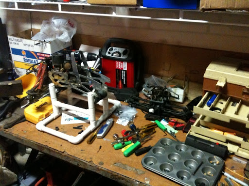

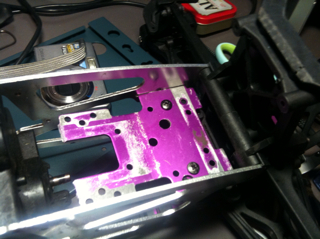

Build continued last night, even though I don't have all the materials 🙂
I scrounged through my ever-growing box of parts and was able to put together most of a Savvy out of spare parts so that I could start mocking up what goes where.
I used an old aluminum bulkhead plate to start lining up where the braces, etc will go and I found I have a lot more room than I thought I was going to have
I am pretty sure that means I am doing something wrong 🙂 I also don't like the location of my relocated reciever case, so I will be making a new servo case out of aluminum angle and using Durafix to weld it together (with a lid, so I can remove the receiver, BTW). That will be in another post 🙂
So, after I lined up the aluminum skid with the steering towers, I realized that there were a few other locations I would be able to use to add extra bracing, as well as having a bunch of space under the plate along the inside of the TVP - this is where the custom receiver box will go.

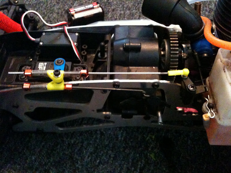

So last night I put more time into the mid-tank mod, and I am 99% of the way there - just waiting on more parts!

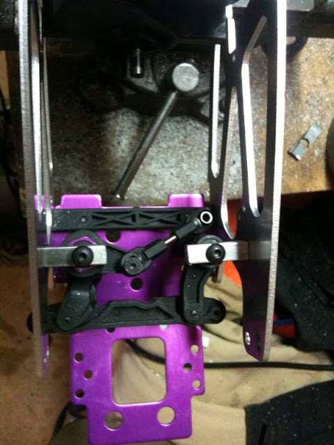

The purpose of this update is to remove the radio box, relocate the servos in preparation for the arrival of my aluminum and 250cc fuel tank.
The first thing I did was grab an old set of TVP's, bulkhead, and trans to start mocking up the fitting, etc. After trying to figure it all out, and in doing so, keeping the angles on the steering rod so that they won't bind, I found a space was in order. To do this, I took an old engine mount brace, drilled it out for the M4 screws, and cut out the middle section. This allows me to provide the lateral support for the bellcranks, but still have room for the steering rod in the middle.

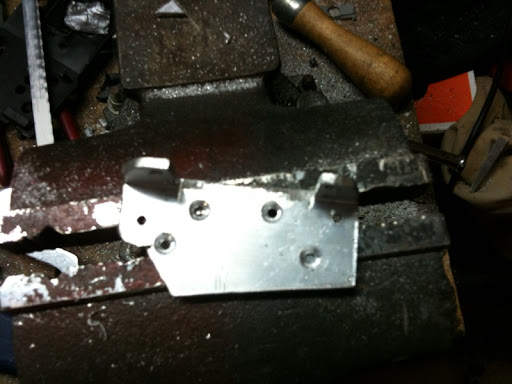

Now, I had to make a way to mount the servo to the side of the TVP, and consider the pattern of the TVP and how it will interfere with the mounting options. Since I am using an XL fram, the big X on the side limits where I can drill out for solid mount points. In the end, I needed to create the mount (made from 1x1 aluminum angle) and add counter-sunk screw holes so that the servo and screws would not interfere with each other.

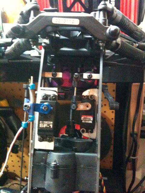

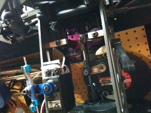

Once that was done, I needed to make another mount for my throttle servo. Remember, I mentioned that this is getting ready for the mid-tank, and I don't yet have the aluminum plate or the tank. So, what I did is use another piece of aluminum angle, and make another mount to hold the throttle servo until the rest of my goodies get here. When they do, this servo will be relocated to where the stock fuel tank goes.
Linkages need to be tweaked a bit and I will be getting a more sturdy steering rod at the LHS, but this is what she looks like - let me know what you think!

okay here are a few issues I notice right away. Mount the steering servo lower on the tvp's so that the linkage mounts to the bottom of the bellcrack. This will enable you to use a brace all the way across the truck instead of two half braces that are going to move on you. You also need the rubber spacers on your servo's which would make your steering servo even higher. You are going to have your servo hitting on the bottom of your mid tank plate once you put those on. Also you may want to consider a somewhat better T/B servo nothing crazy just a little faster and stronger. Those sf1 glitch a lot.
other than that nice work, great custom work as well.
