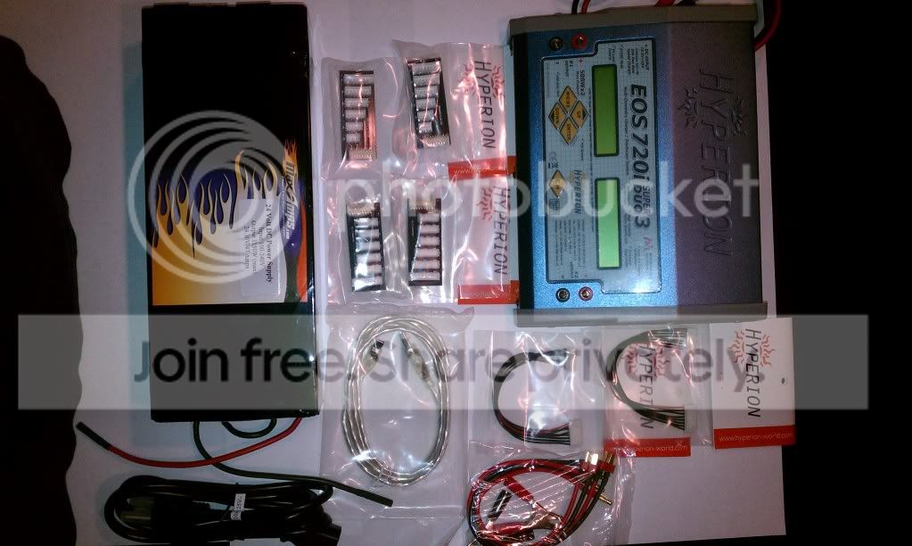

Just got the 720 and the maxamps 24v power supply a few days ago. No issues whatsoever. Charged my 2 and 3s 5500's at 20a in 26min. Love this setup.

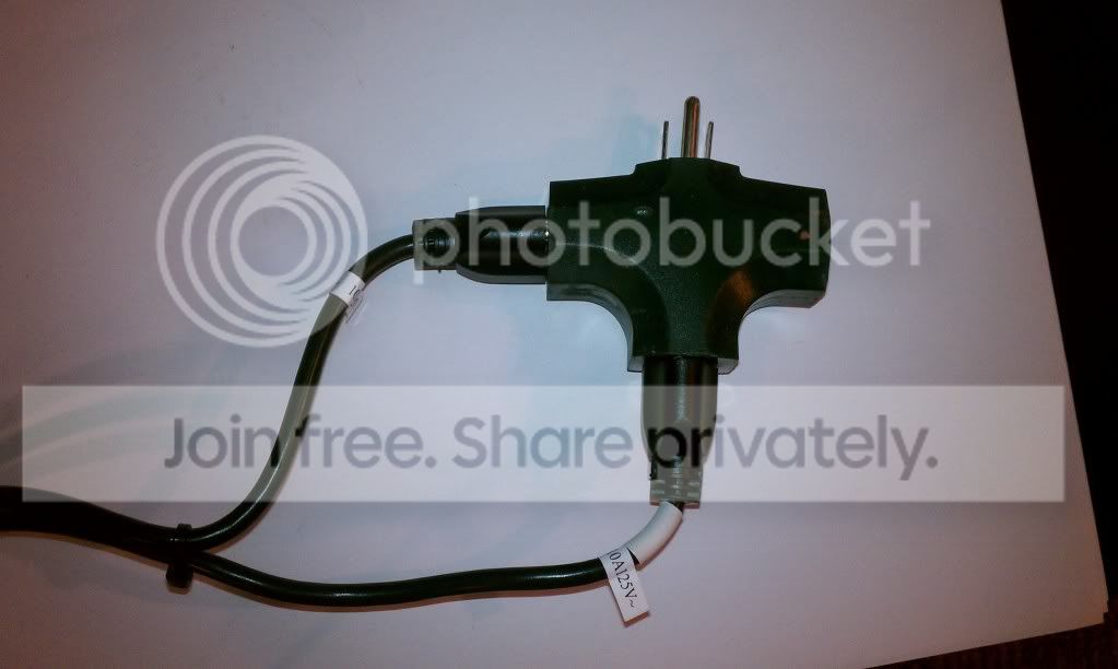

hey three six why do the maxamps powersupply have two power cords. And the main lead wire don't have any connectors on the power supply, are you suppose to solder bullet connectors or something?
The ps has two cords because its really 2 12v ps run in series. One plug has the ground, and one doesnt. Doesnt matter which goes where, just have to have them both pluged in to get the 24v. The ps comes with the female banana plug already soldered. Just hard to tell from the pics. Trust me, I already called maxamps with all these questions before I pulled the trigger.
I used this three way adapter so i can just bother with one plug, as the ps doesnt have an on/off switch, and installing one will void the warranty. (already aked that too)
