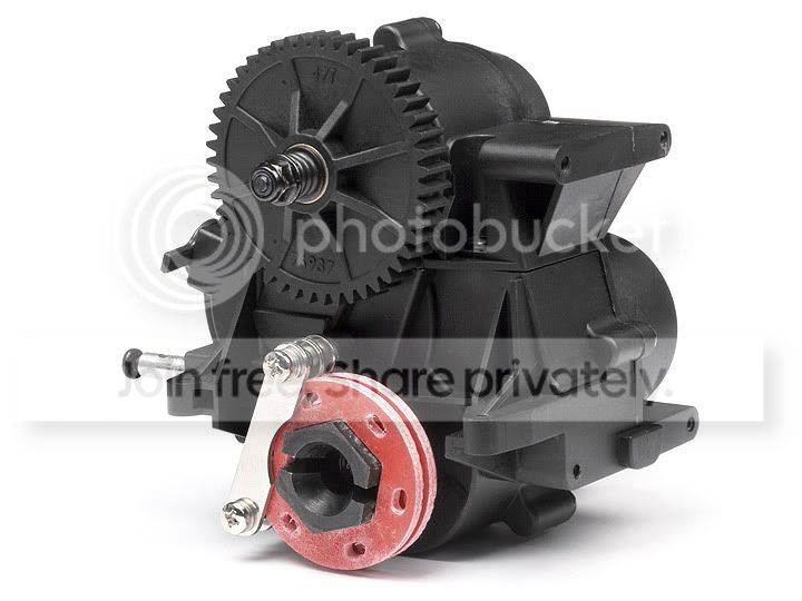

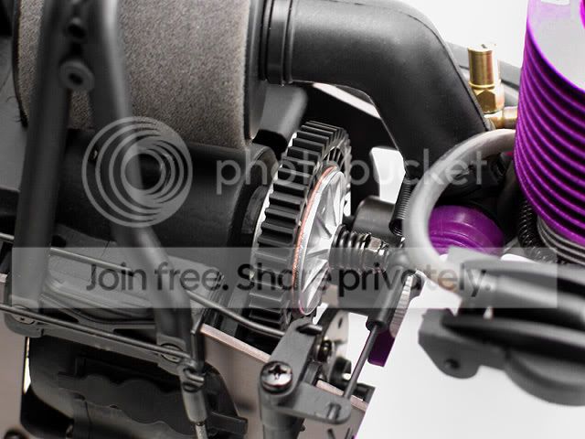

I'm asking about the clutch, not the clutch bell. Anyhow I don't think thats an issue. It seems your mesh is too loose, thus the sheared teeth. When messed correctly you should hardly feel any wiggle they should be nice and tight but still feel the smallest amount of play. Next tighten your slipper clutch all the way down, then back off 1/4 of a turn. it's the nut that hold your spur gear on. Meshing a spur take practice, stick with the plastic 25 style spur and you'll be good. If you are using the X slipper (the one with 2 pads that sandwich the spur) I recommend you buy the 25 style spur.
X Spur
25 Spur
you say to back it off a 1/4 turn?
if i do this, then my spur gear wont slip ever, will it?
isnt that too tight?
i learned that the best way to get you mesh right is to put your moter on and leav the bolts loose then take a small peice of notebook paper and put it in between the spur gear and the clutch bell then slide the moter over against the spur gear then crank douwn the bolts and then all you have to do is pic the truck up of the ground then slowly pull the paper out from the spur and clutch then check the mesh you should just barely feal it wiggle hope that this helps bud.
