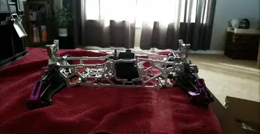

Got some more done. After I got it this far I realized I had the rear diff in backwards lol. Should have the rest of my parts tomorrow except the body. Finally coming together, should have it finished next week hooefully.20180216_125316.jpg
Good job so far, cant wait to see the cool body your doing!

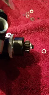

Also if you lose the clutch bell spacer/bushing. A Losi shock washer works perfect and looks great haha. Really though, it was perfect, even the washer for the screw fit perfect in it. Saved me a trip to the store lol. Also had to clearance the rails a Little to get the scews from the engine heat sink to clear the rails, and had to slot the holes in the engine mounting plate in order to move the engine back a little.

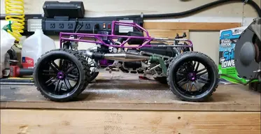

Since you have the ability to weld, you might want to put some X bracing in the long horizontal sections before getting it powder coated.
That is actually a really good idea. May have to go snag it bag from my powder coater.
I meant was the original hollow or solid? I have a new era 3 point roll bar on one of my revo's, it's as big around as my pinky, but hollow. I had an RC Raven roll cage back in the day that was solid wire, but didn't look as thick as yours.
Ah ok, no it's tube steel not solid. My last one was pretty strong, I had quite a few hard hit on it and no dents or dings.
